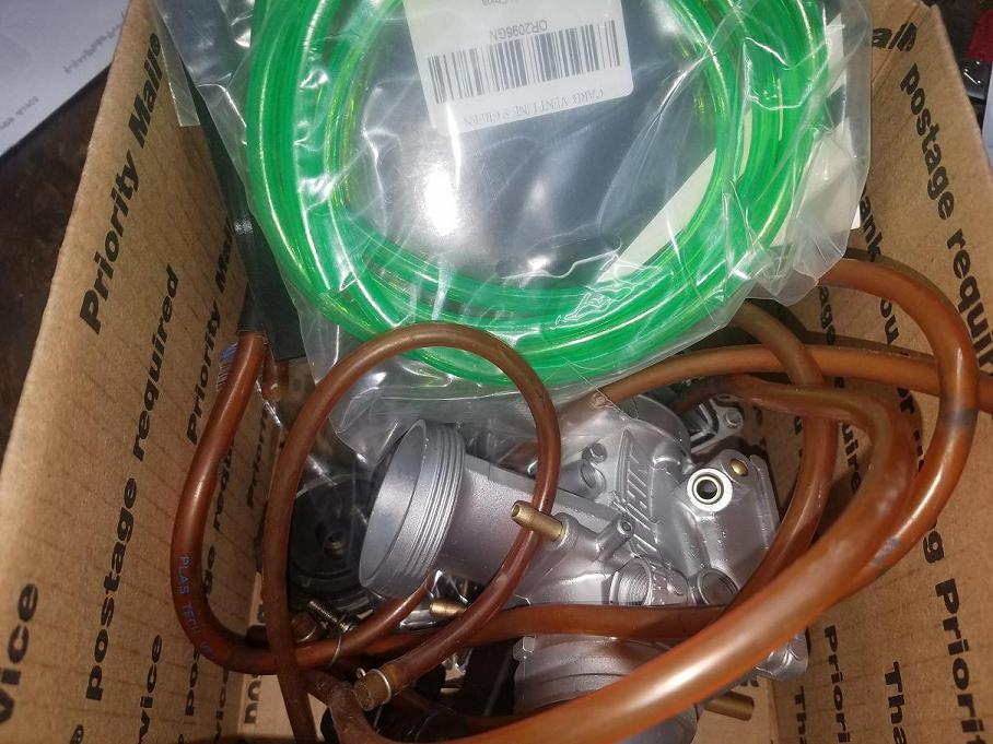

Nothing worse then working with hardened vent hoses...
So I ordered some new stuff..
KX GURU RACING SEAN COLLIER KX500 157.JPG (124.59 KiB) Viewed 17148 times

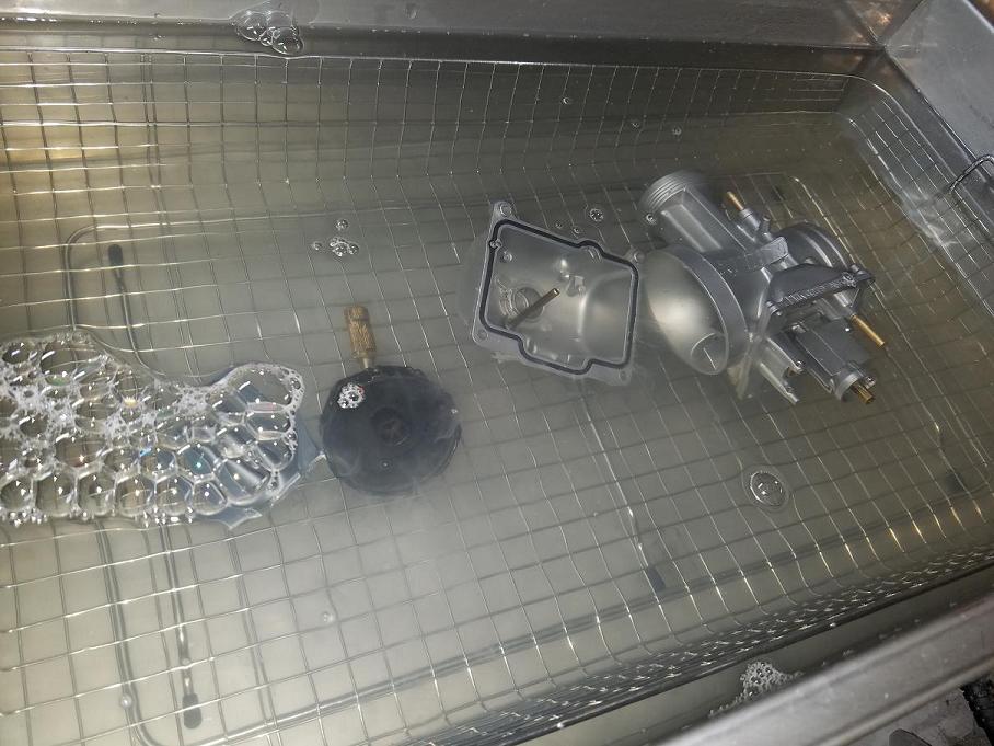

And, a carb rebuild would not be complete without a bath in the ultrasonic cleaner..

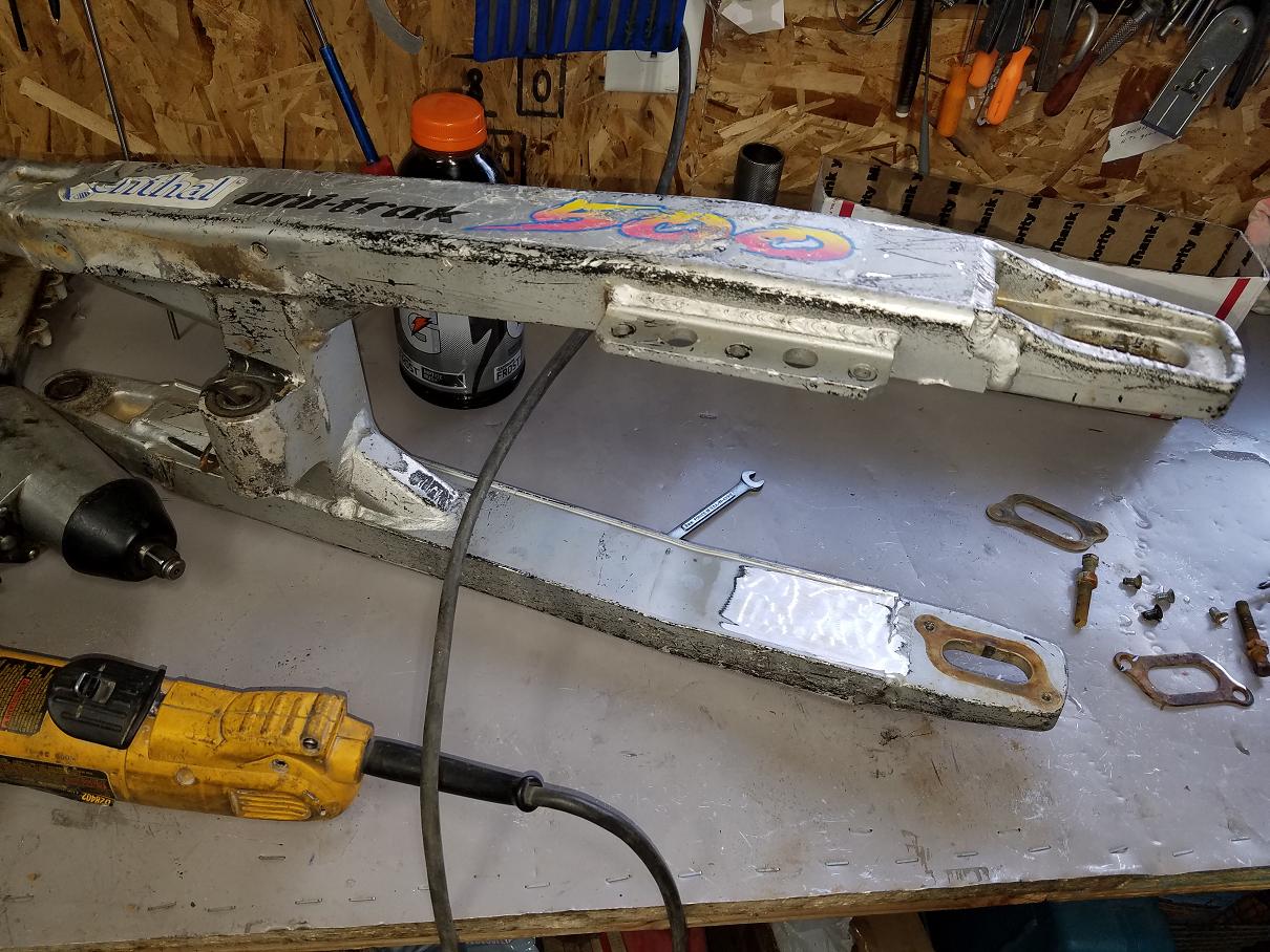

And I hate to admit it but I didn't like how the first swingarm was turning out :x
Lessons learned... Time for Rev 2 8-)

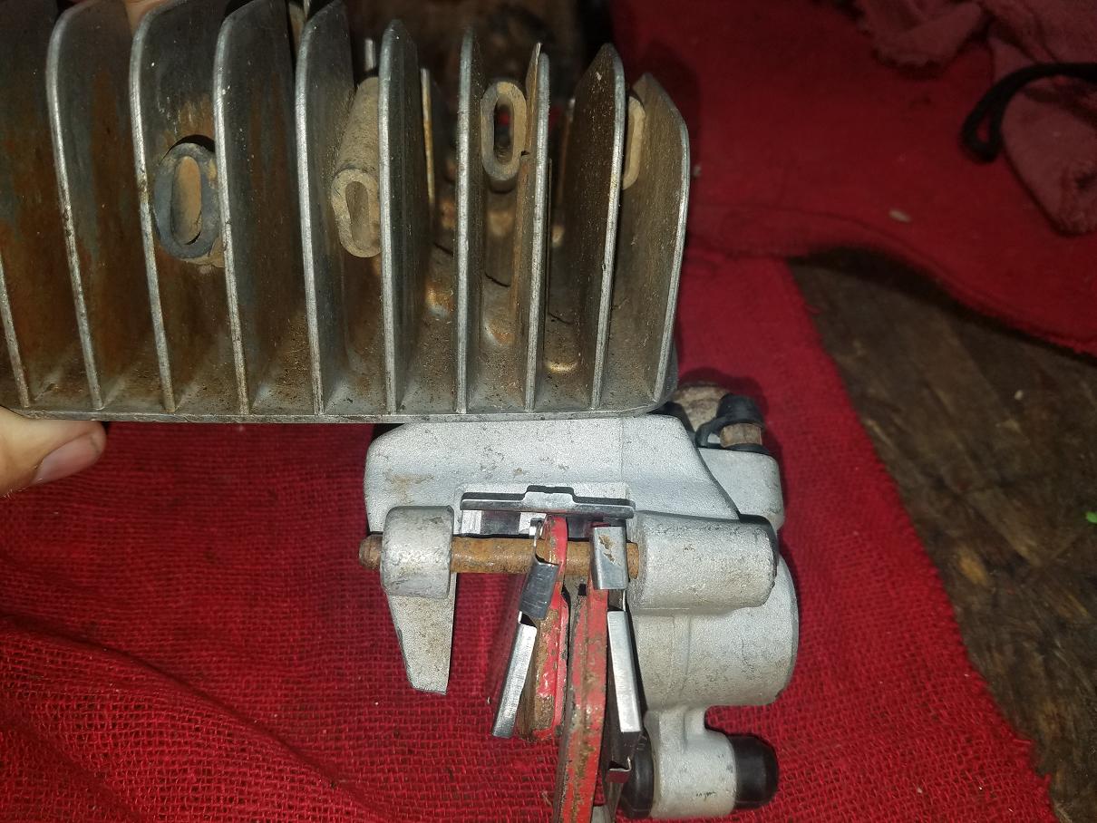

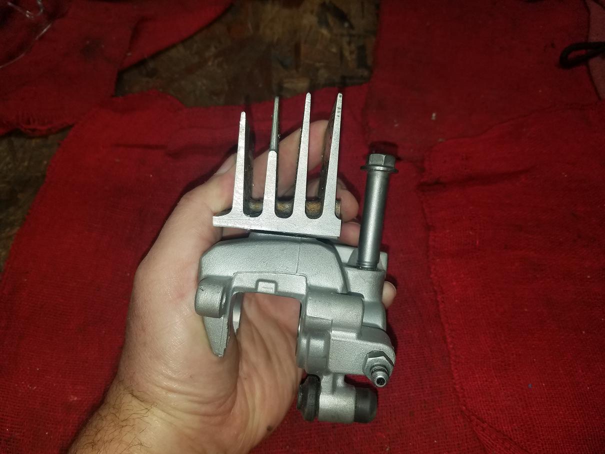

Soooo... This will give you a better idea of where I am headed with the rear caliper.
KX GURU RACING SEAN COLLIER KX500 158-1.JPG (275.13 KiB) Viewed 17109 times
KX GURU RACING SEAN COLLIER KX500 158-2.JPG (123.64 KiB) Viewed 17109 times

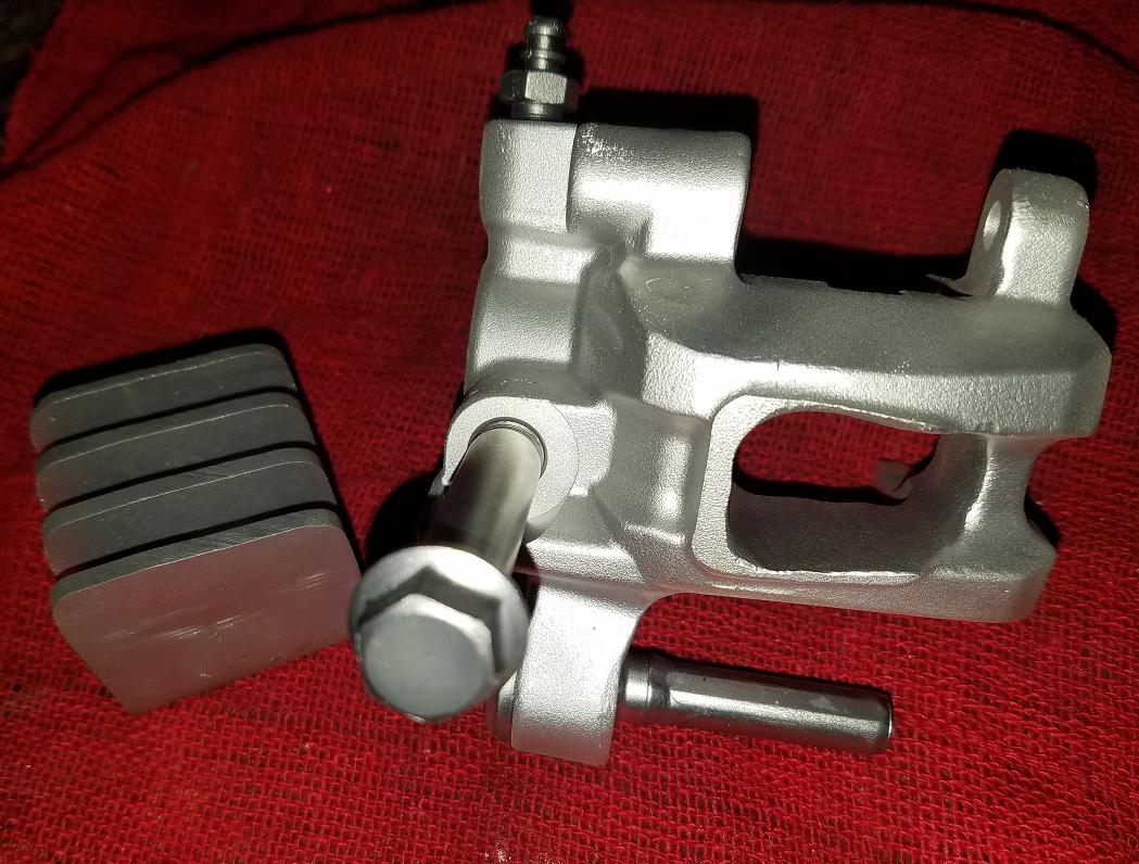

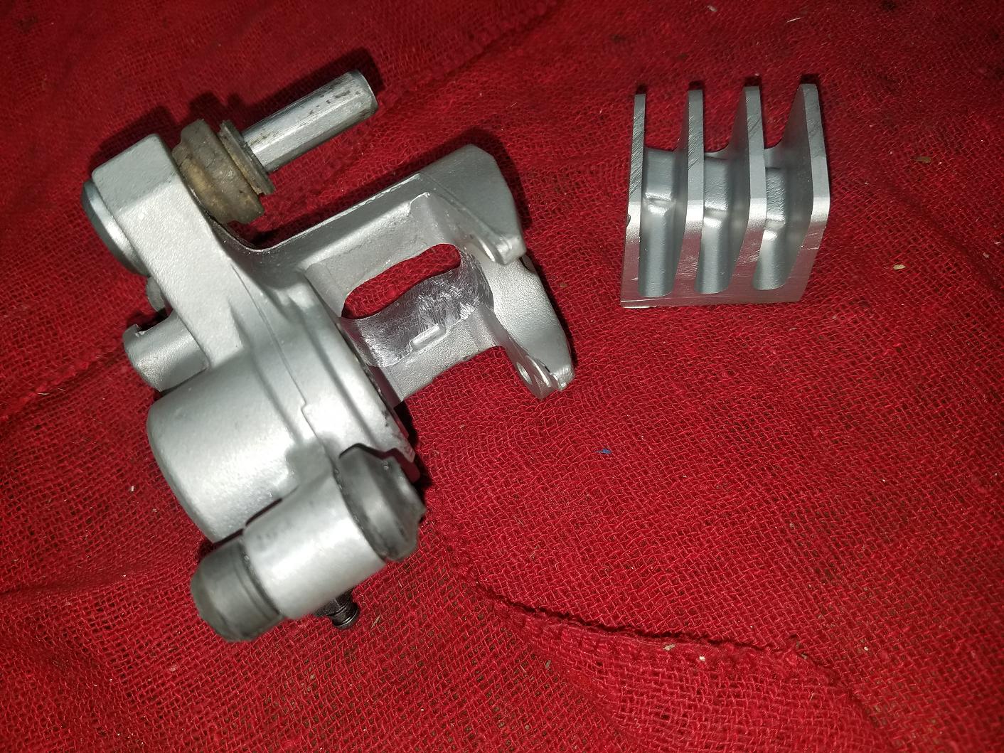

Re: Sean Colliers KX500 build

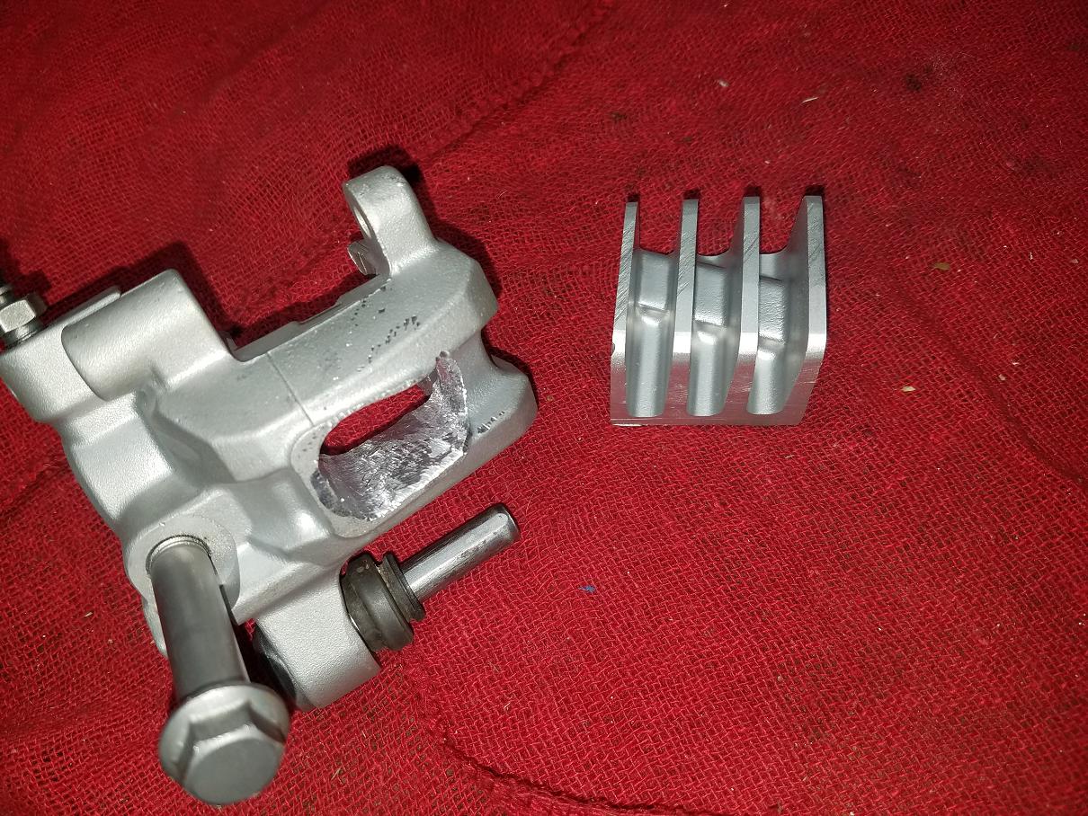

This is a rough cut of what it will finish like...
KX GURU RACING SEAN COLLIER KX500 159.JPG (340.59 KiB) Viewed 17108 times
KX GURU RACING SEAN COLLIER KX500 160.JPG (273.99 KiB) Viewed 17108 times

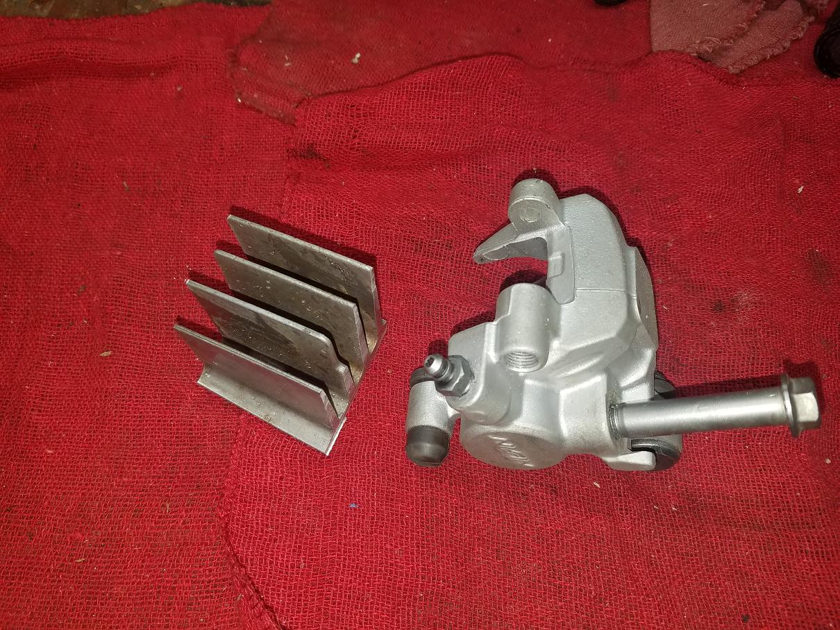

A little more clean up...
KX GURU RACING SEAN COLLIER KX500 162.JPG (134.82 KiB) Viewed 17092 times

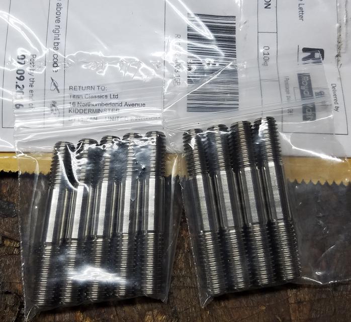

This is not Chichanium :lol:
not chichainium.JPG (82.71 KiB) Viewed 17021 times
Half the weight of the steel studs and will not rust or corrode...
I like it 8-)
