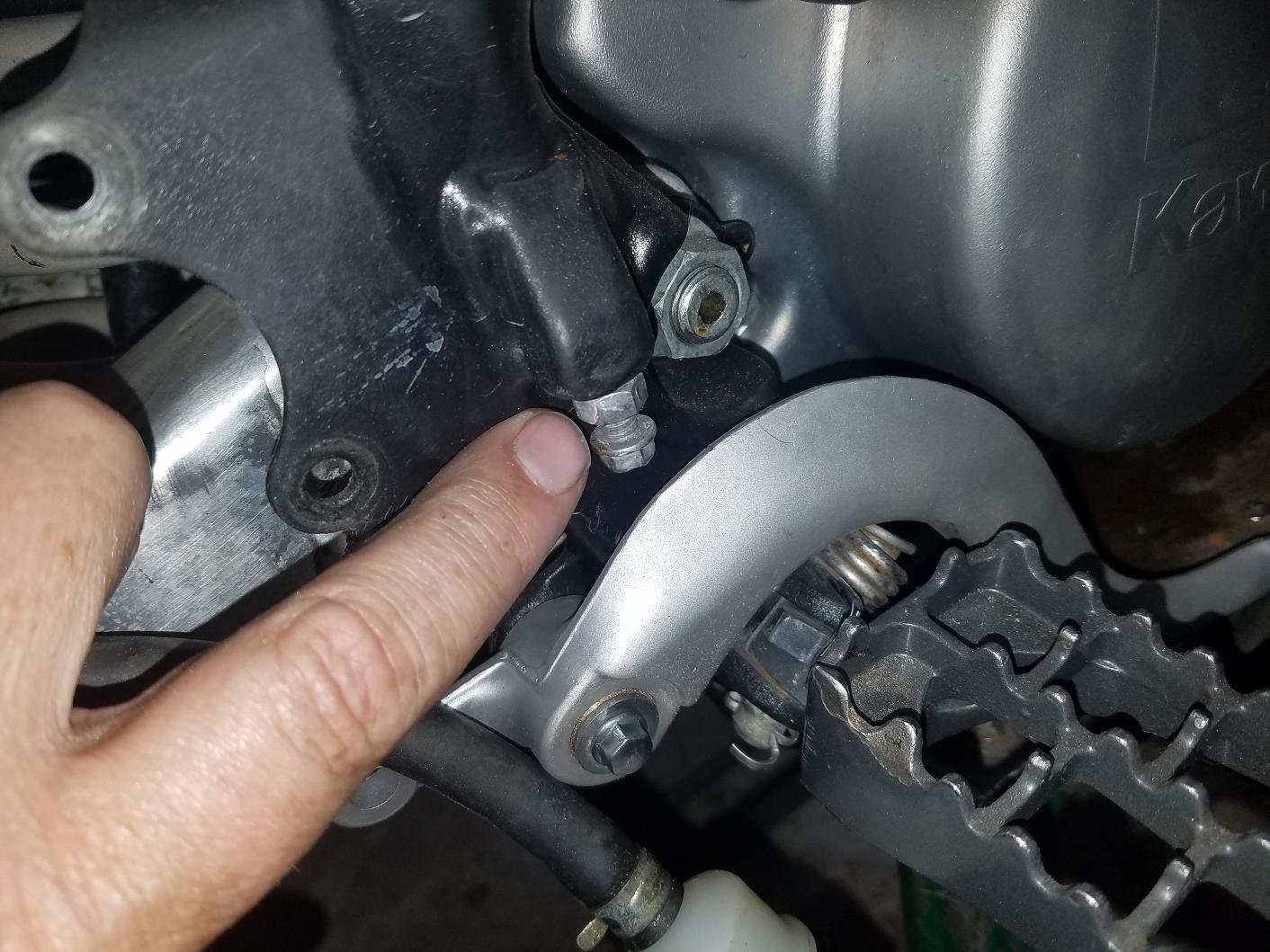

For now I will remove the bolt but in the future, I will remove the mount and help streamline the frame..

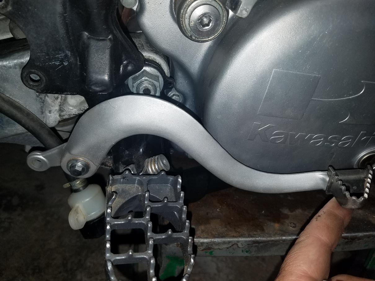

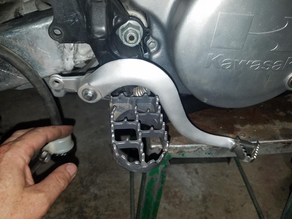

All the way down.... No problem..

All the way up.. Perfect
