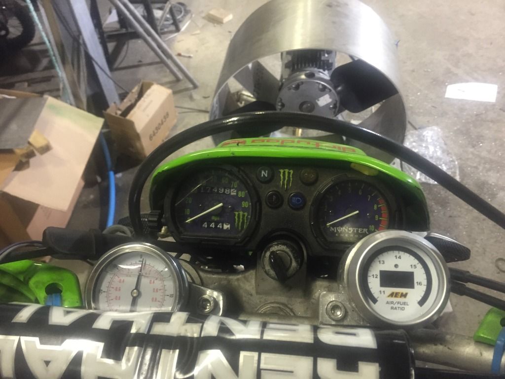

A few days work. Leaking clutch cover gasket and few odds and ends to sort. Going to take most of the gauges off, all that will be left is the inlet air pressure, afr and not made up my mind about the exhaust temp. Might leave it temporarily.

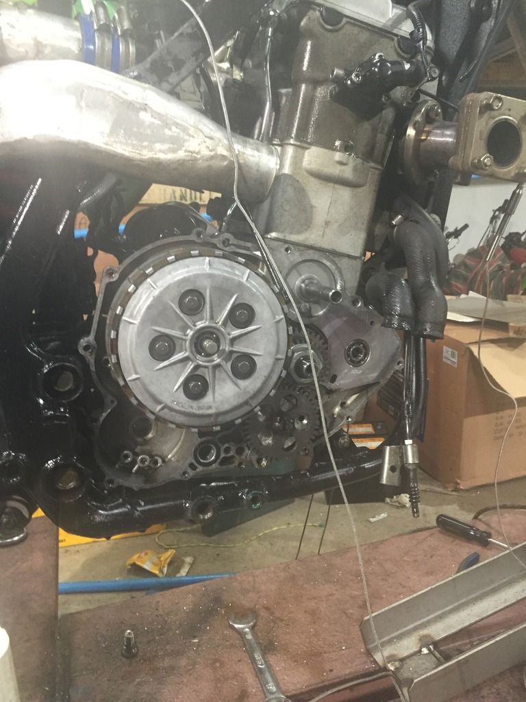

Yesterday I took the clutch cover off to fix the leak on the gasket. The oil was pretty dirty looking when I drained it. Then when the clutch cover came off and the oil drained away and the oil that was caught there dripped away there was sludge left under the cover in the void that the Kickstarter used to live. The engine was completely apart and clean, or so I thought, before the engine was run so I think the only place this could have come from is the clutch. The clutch is still the original plates, I saw a guy rebuilding an engine where he recommended not putting a new clutch in a newly rebuilt motor as it would fill the clutch with the metal fragments from the newly built motor. So anyway I have put the new clutch friction plates I had in the clutch, but I'm wondering now whether some washers or spacers to pre load the clutch springs would be an idea?

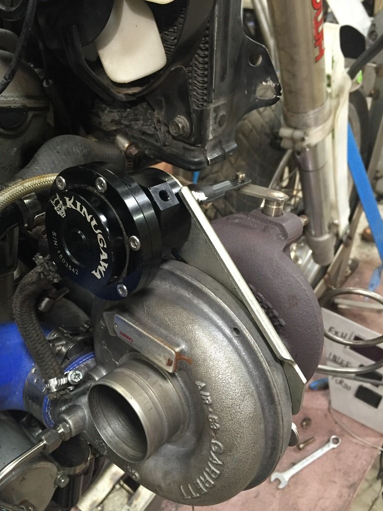

See also in this picture how cooked the exhaust looks, wow.
Here is the new wastegate actuator. I also got the turbine housing off the turbo and drilled the wastegate port out from 14.5mm to 19mm, it was the biggest I could drill it and still keep a reasonable sealing surface around the poppet valve, I also did a bit of blending with a carbide burr around the port it was not blended before, just a little rounded from the casting process so the hole is 58% bigger and blended. Should be an improvement in flow.

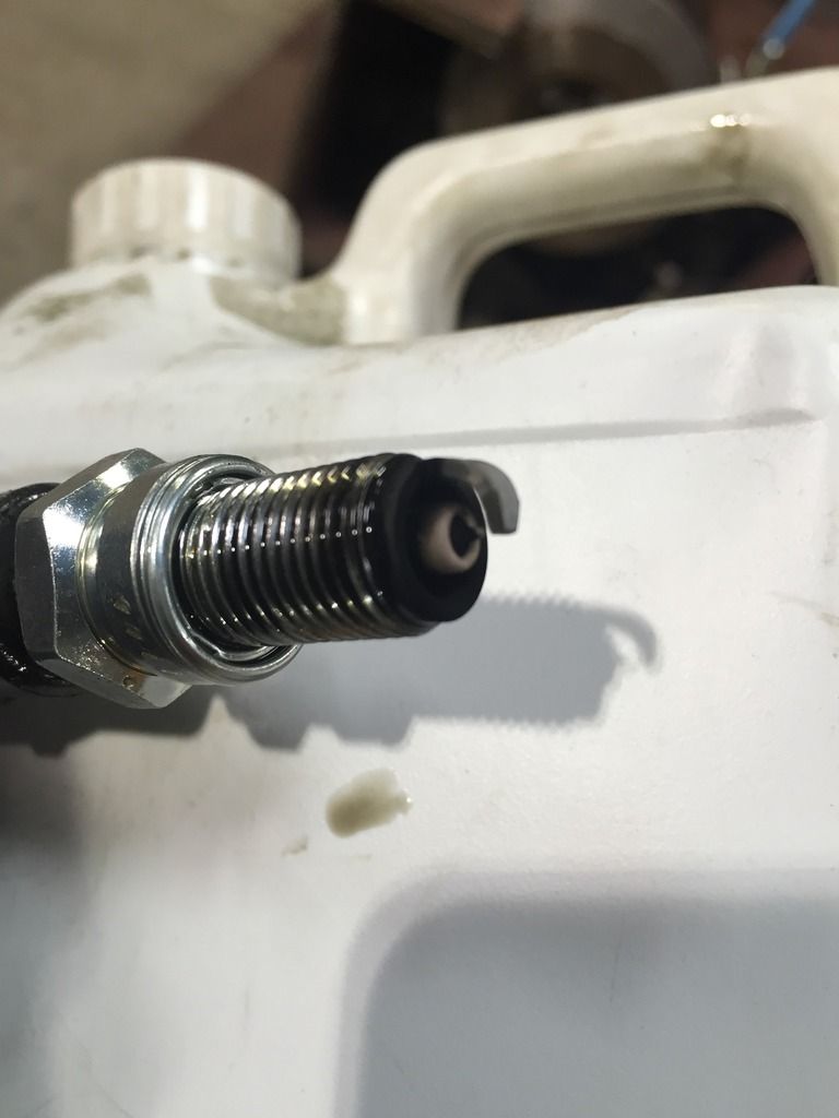

What does anyone think of this spark plug? The colour looks not too bad to me but maybe the electrode says it should be a colder plug?
Trying a colder plug wouldn't hurt.... If its wrong you'll just foul a plug

oh... clutch issues...
Yes, you will most likely use up your clutch a bit faster especially especially with what you are doing.
And that will make your engine oil dirty faster.
Heavier springs will help but make your clutch pull harder.
You can offset the difference if you lengthen the clutch actuator lever that goes into the engine... Not the hand lever...

I might just add spacers it is almost certainly going to need it.

I like the dash.
Too bad you didn't live a bit closer... I'd run your top triple clamp through the vapor blaster, and whatever other raw aluminum parts you have
