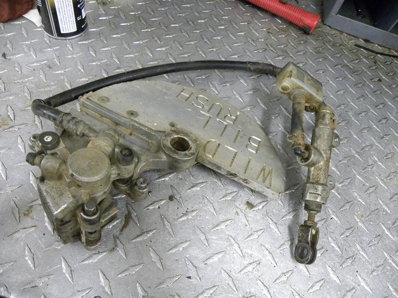

So here is the culprit.
It's from a 96 RM125.
The calipers move easily in and out but the master cylinder plunger is stuck big time.
So here is the plan.
We will disassemble them, clean them really good, re-assemble, and bleed and see if that fixes the problem.
Believe it or not, in most cases you do not need to install new seals but hey, if your going this far, what not :D
Here is what we are starting with:
As you can see it's filthy dirty and has corrosion around the plunger.

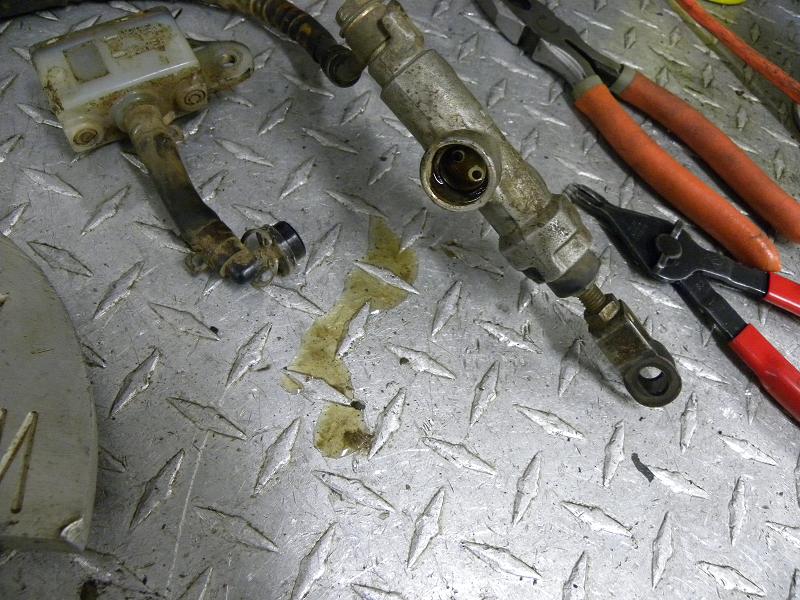

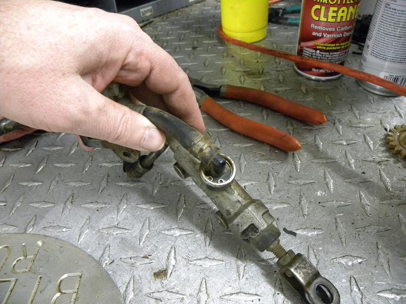

Next I like to remove the reservoir and get it out of the way.
To remove the reservoir you will need to remove the snap ring as shown below:
They can be a little tricky so you may need to put on your reading glasses...
Once you get it look inside.
If yours is as bad as this one its no wonder your having problems.
These should be perfectly clean inside.

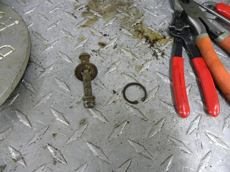

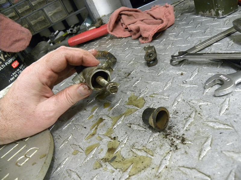

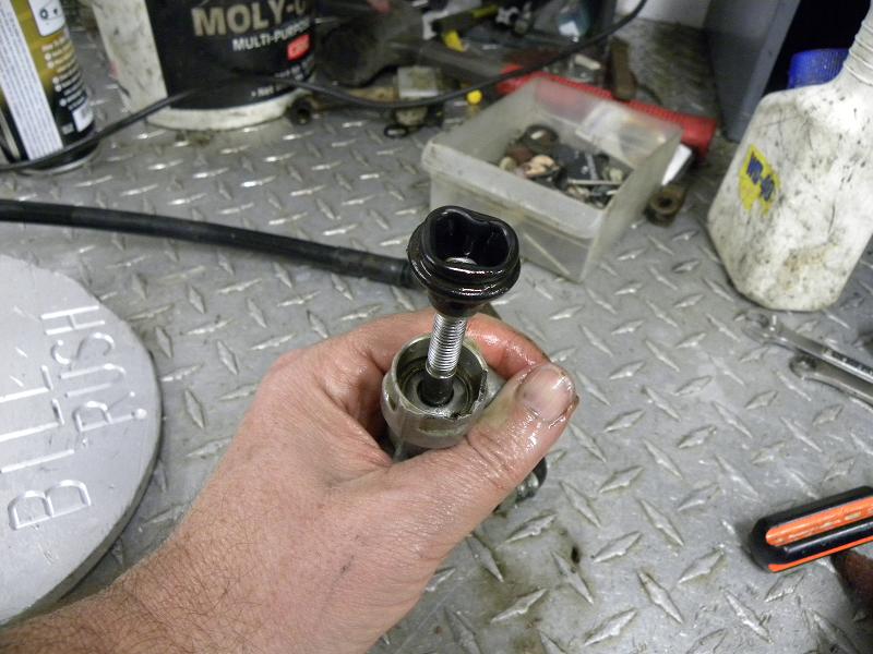

Next I remove the rubber cover along with the clevis so I can get it out of the way as well as clean it, wire wheel the threads ect.

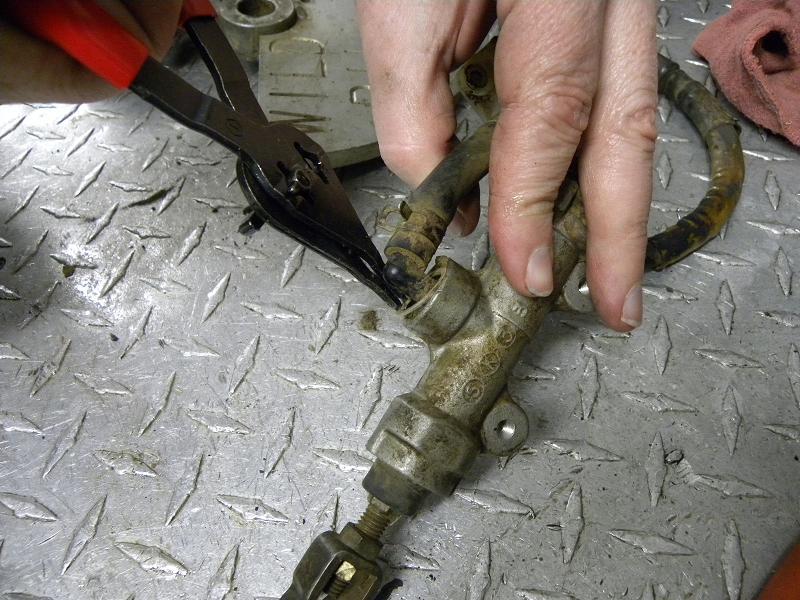

You will need to remove another snap ring.

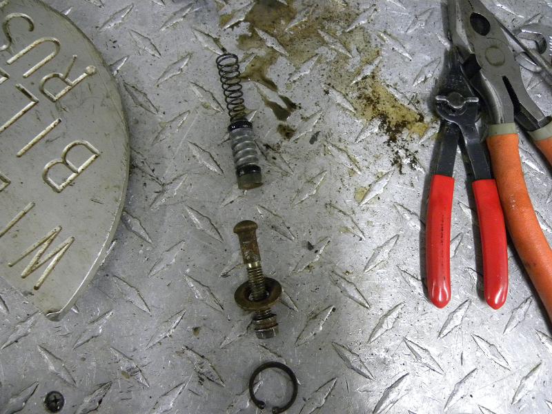

Once you remove the snap ring you can pull the plunger assembly straight out the bottom.

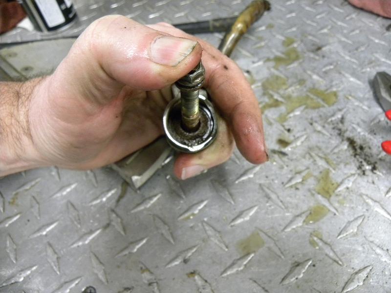

As you can see this plunger is filthy and rusted.
This is actually fairly common.
I like to take the plunger and wire wheel it along with all the other parts, just be careful not to damage the rubber seals or you will be buying a rebuild kit.
Once you get it all done it should look a lot better.

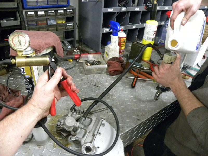

Last we fill the reservoir and then bleed the system with a vacuum tool.
Put the cap on the reservoir and test the brake by moving the plunger up and down.
The brake pads should move freely and tighten.
Be careful not to get your finger stuck in the pads because they are very unforgiving.
