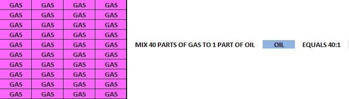

So, what does 40:1 mean?
What this means is 40 parts of gasoline to 1 part of 2 stroke oil.
It does not matter what unit of measurement you want to use, Gallons, quarts, liters, or ounces, as long as you use the same unit of measurement for both the oil and the gas :D
Since we are in the USA we will use ounces.
Let's break this down.
There are 128 ounces per 1 gallon.
If we take 128 ounces and divide by 40 we get 3.2 ounces.
So:
3.2 ounces of 2 stroke oil per 1 gallon of gasoline = 40:1
6.4 ounces of 2 stroke oil per 2 gallons of gasoline = 40:1
9.6 ounces of 2 stroke oil per 3 gallons of gasoline = 40:1
12.8 ounces of 2 stroke oil per 4 gallons of gasoline = 40:1
16 ounces of 2 stroke oil per 5 gallons of gasoline = 40:1

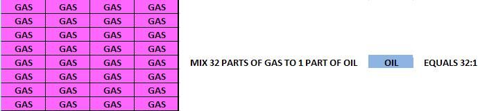

Lets say that we we want to use 32:1 for breaking in a new engine.
If we take 128 ounces and divide by 32 we get 4 ounces.
So:
4 ounces of 2 stroke oil per 1 gallon of gasoline = 32:1
8 ounces of 2 stroke oil per 2 gallons of gasoline = 32:1
12 ounces of 2 stroke oil per 3 gallons of gasoline = 32:1
16 ounces of 2 stroke oil per 4 gallons of gasoline = 32:1
20 ounces of 2 stroke oil per 5 gallons of gasoline = 32:1

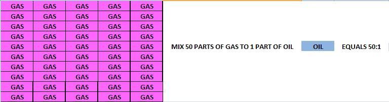

Now lets say that you like living on the edge and want to run 50:1
If we take 128 ounces and divide by 50 we get 2.56 ounces.
So:
2.56 ounces of 2 stroke oil per 1 gallon of gasoline = 50:1
5.12 ounces of 2 stroke oil per 2 gallons of gasoline = 50:1
7.68 ounces of 2 stroke oil per 3 gallons of gasoline = 50:1
10.24 ounces of 2 stroke oil per 4 gallons of gasoline = 50:1
12.8 ounces of 2 stroke oil per 5 gallons of gasoline = 50:1
15.36 ounces of 2 stroke oil per 6 gallons of gasoline = 50:1
