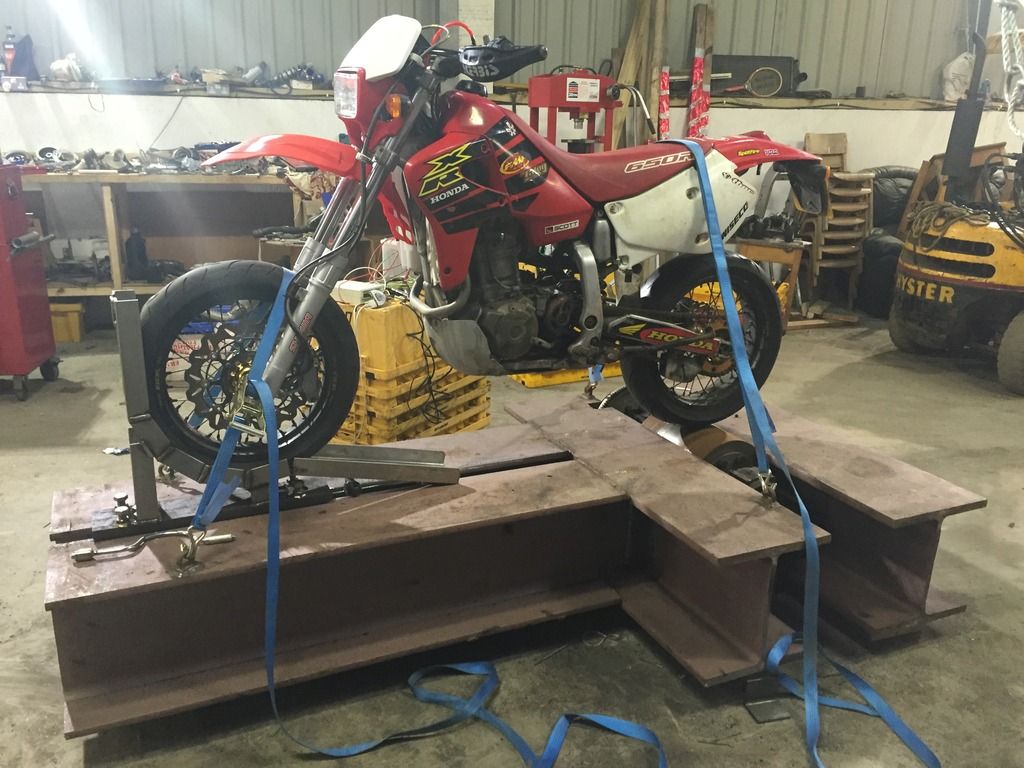

Hi, long time no action.

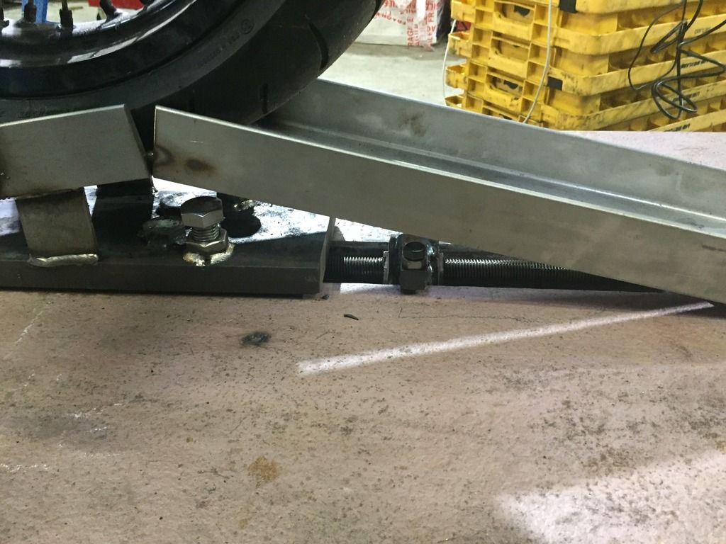

Got the front wheel chock done.
The chock is adjustable with the threaded bar. Once the bikes back wheel is at the right place on the roller the m20 bolts are screwed down to fix the position.
I tried a run tonight and I am still not getting a correct bhp reading. But I still have to go through the setup sometime with the U.K. Agent.

Re: Building your own Dyno
That's got to be the toughest bike dyno I have ever seen
It's amazing what all you did with it...
