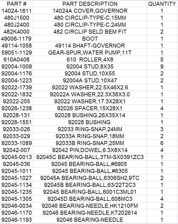

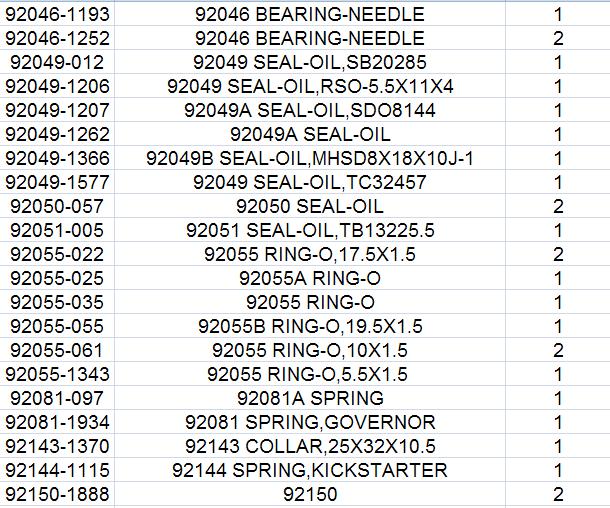

This is our current basic parts list for our KX500 builds.
This does not include crank rebuilding, gaskets, piston, cylinder rebuilding, trans gears, clutch baskets, plates, hubs, exhaust valve components, ect.
This is meant to help you decide what parts you may need on your next build as a good starting point... It is not All inclusive...
It is merely a list of parts we will automatically order for our KX500 builds.
kx500 basic parts list 101.JPG (164.42 KiB) Viewed 7838 times
kx500 basic parts list 102.JPG (97.98 KiB) Viewed 7838 times
