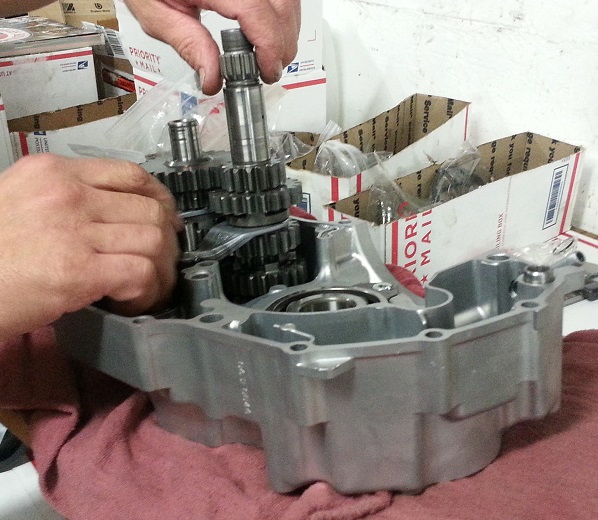

Doing a test before assembly to make sure there are no issues..
WWW.OEM-CYCLE.COM 2006 YAMAHA YZ450F BUDGET BUILD 111.JPG (135.31 KiB) Viewed 8597 times
WWW.OEM-CYCLE.COM 2006 YAMAHA YZ450F BUDGET BUILD 112.JPG (251.72 KiB) Viewed 8597 times
WWW.OEM-CYCLE.COM 2006 YAMAHA YZ450F BUDGET BUILD 113.JPG (234.05 KiB) Viewed 8597 times
