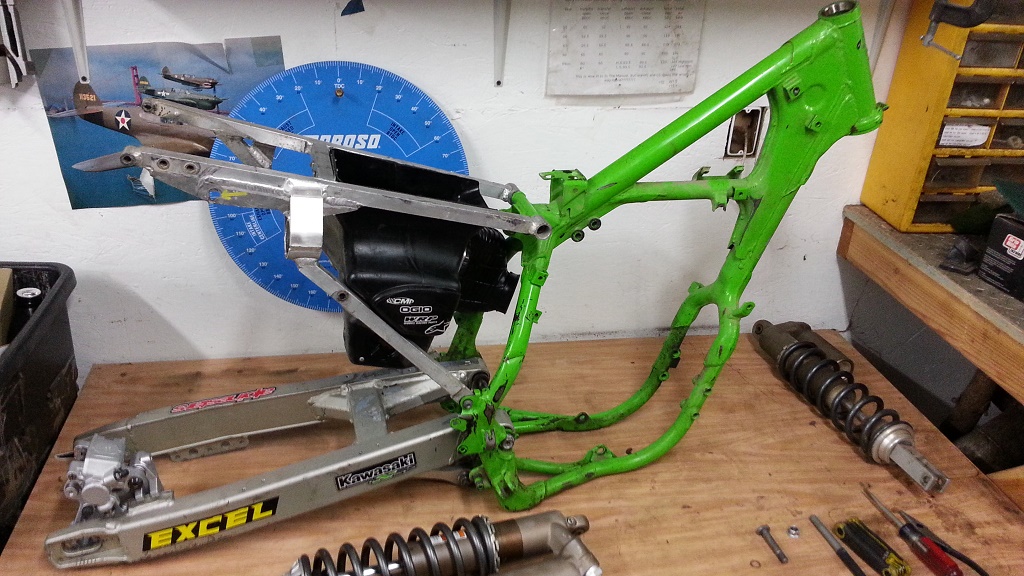

Before I go any further, I need a mock up.
Turns out I just happen to have a few spares laying around...
Except for the stupid swingarm that I had to buy on eBay :?

Why not bolt the KX450F shock to the 88 chassis and be done with it?
It is simply too long.
