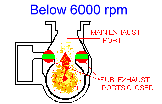

The KIPS valve system is comprised of a series of geared shafts driven by a centrifugal advancer that rotates two sub-exhaust ports and a main exhaust port slide valve into position. The centrifugal advancer is driven off the crankshaft. As the engines speed reaches about 6000rpm centrifugal force on the weights overcomes the pressure excerpted by the spring and the advancer snaps open. The advancer shaft transfers this motion to the advancer shaft lever, to the main shaft and on to the slide valve and sub-valves causing them to open.
Up to 6000 rpm, the Slide Valve is dropped into the main exhaust port, the sub ports are in the closed position and the Halmhotz resonator is open to the exhaust port. The lowered slide valve increases the effective stroke of the engine, increasing the compression for better low rpm performance. The sub-exhaust ports are closed to retard the escape of exhaust gases, slowing the returning compression wave. The Helmhotz Resonator is open, producing a delayed pressure wave that retards the escape of air/fuel from the cylinder. The CDI advances the ignition from about 6 ° BTDC at idle, to 21° BTDC at 6000rpm, allowing the flame front sufficient time to travel across the chamber, producing the greatest possible pressure rise. The CDI and KIPS Valves work together to produce the best possible low-end performance.
At 6000 rpm the slide valve snaps open, the sub ports snap shut and the CDI retards the ignition back to the base (idle) setting. The elevated slide valve decreases the effective stroke of the engine, lowering the compression preventing auto-detonation and controlling cylinder temperature. Opening the sub-exhaust ports increases the exhaust port area allowing exhaust gasses to escape more quickly, improving top-end power. The Halmhotz Resonator is closed. Retarding the ignition allows the flame front adequate time to ignite the charge of air/fuel, reducing pumping losses and shifts heat from the piston crown to the expansion chamber.
