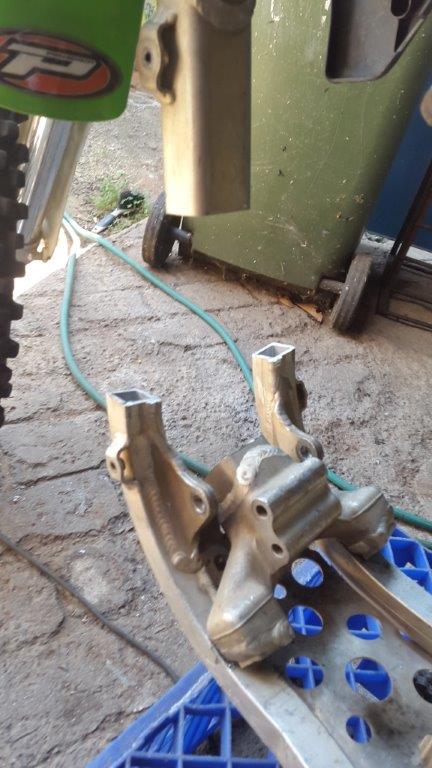

Picked up my new piston
Man its big..

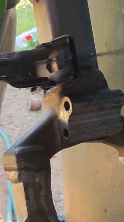

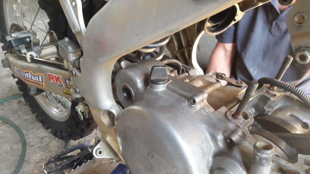

Got the motor in this weekend.
Drilled the hole for the swingarm pivot bolt bigger and ground the collars very lightly to make the motor fit.
Then I cut the frame in front for the exhaust to fit.
