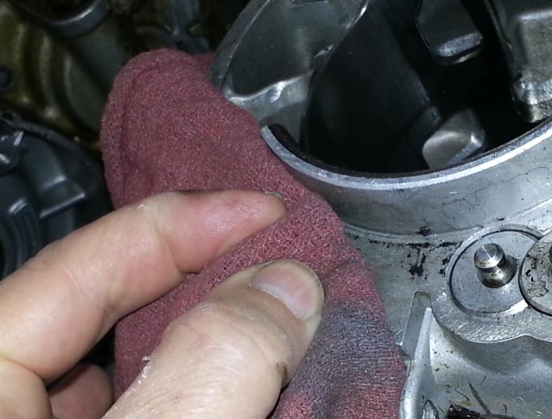

Sometimes you need to soak them several times and let them sit overnight.
I always try to free them up enough by hand but sometimes this just isn't enough.
The next thing I do is get a shop rag and put it over the end of one of the exposed shafts at the bottom of the valve.

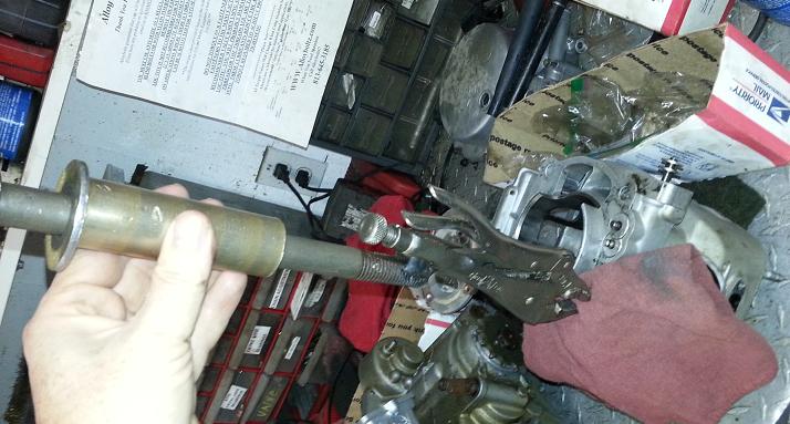

Then I use my trusty Slide grips and lock onto the small exposed shaft.
DO NOT grip them too tightly as you can damage the shaft.

Then I gently tap them out about 1/4 to 3/8 of an inch or 6-10mm and they will stop.
Next I slide the main shaft out.
Then the valves should come the rest of the way out.
