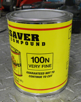

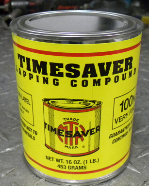

Re: Timesaver lapping compound for Aluminum and soft metals
Here is some pics of the can it comes in.
timesaver 100 grit very fine 1.PNG (279.17 KiB) Viewed 23644 times
timesaver 100 grit very fine 2.PNG (320.15 KiB) Viewed 23644 times
timesaver 100 grit very fine 3.PNG (257.63 KiB) Viewed 23644 times
timesaver 100 grit very fine 4.PNG (266 KiB) Viewed 23644 times

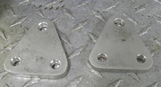

Here is some aluminum mounts that I will be using as test pieces that I have for my AF project
timesaver 100 grit very fine 5.PNG (315.84 KiB) Viewed 23644 times

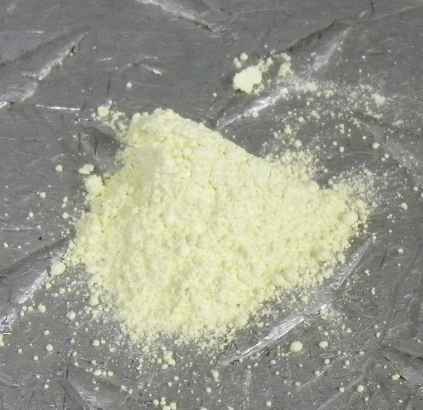

I didn't have anything to mix it in so I cleaned off a spot on my work bench and put it right on top pf the aluminum top.
timesaver 100 grit very fine 6.PNG (297.12 KiB) Viewed 23644 times

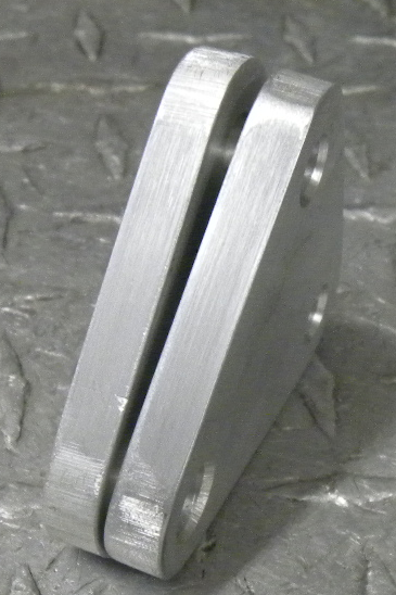

I added a little ATF every now and again and after about 2-3 minutes I stopped and cleaned the mounts up.
timesaver 100 grit very fine 11.PNG (1.4 MiB) Viewed 23644 times
These are VERY smooth.....
I'm sure if I spent some more time with it I could even get them better but flat is flat and smooth is smooth enough for this test.

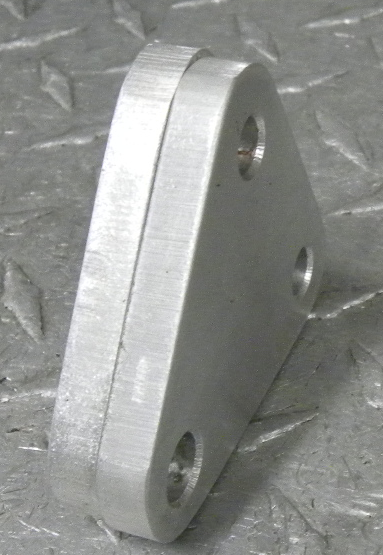

Since they were fairly smooth to begin with I decided to do it on some surfaces that were a lot rougher which was the edges of the mounts.
timesaver 100 grit very fine 12.PNG (300.17 KiB) Viewed 23644 times

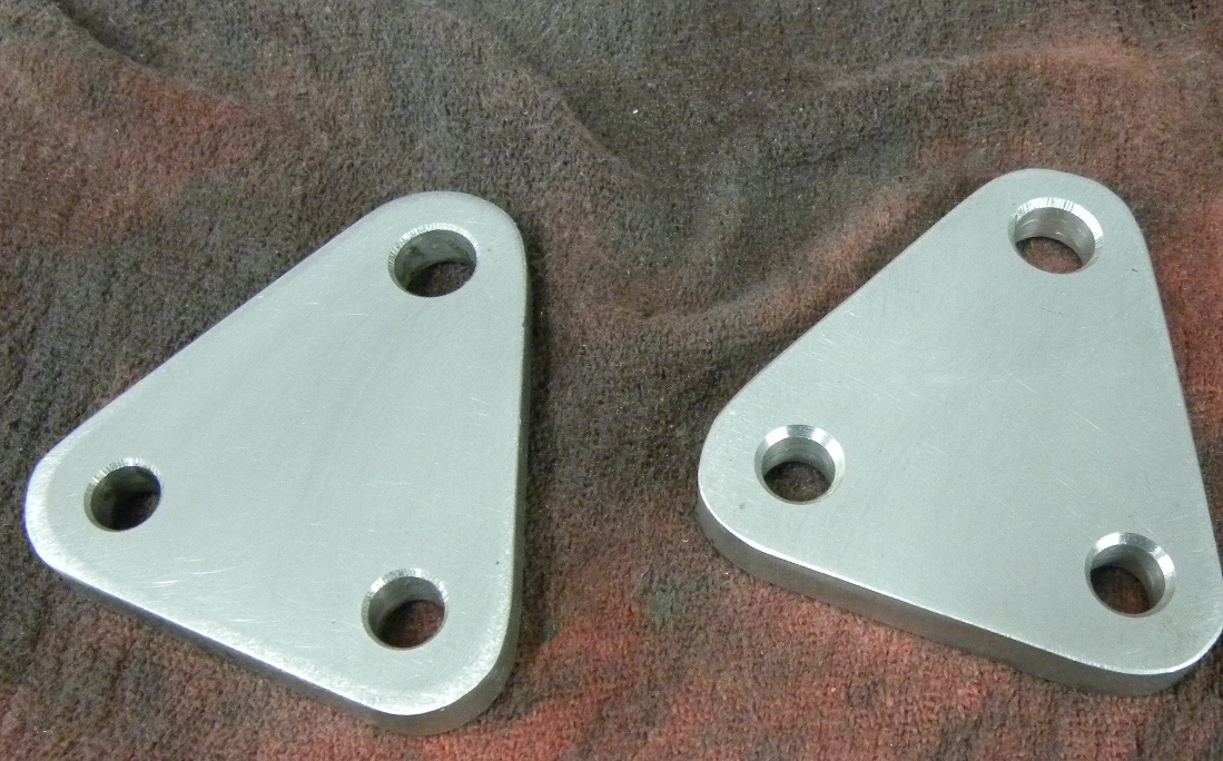

After a few minutes and a few shots of ATF I cleaned them up.
timesaver 100 grit very fine 13.PNG (303.33 KiB) Viewed 23644 times
I am blown away....
When done the edges are very smooth and there is no residue that will continue to cut.
This stuff is amazing.

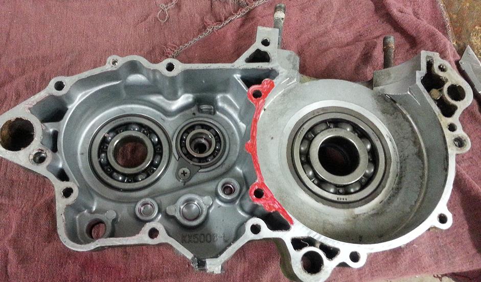

Here is a pic of the area that was not very good as highlighted in red.
lapping kx500.JPG (112.42 KiB) Viewed 22327 times
This is not the actual case that had to be lapped but it is a KX500 case.
In fact it was the original mating case to one of the halves that we lapped.
This one was a bit too far gone for my liking so we supplied another case.
The amount that was lapped?
Hard to say because I did not measure it but my guess is about .001-.002" which is why I don't think there will be any problems.
I am not worried about taking too much material off.
Timesaver is very forgiving.
It cuts but not super fast so it is easy to keep even pressure.
And, you check it every minute or so to see how it is cutting and add more Timesaver as required so there is plenty of time to see if you are lapping unevenly.... And, one more trick.
You put a bolt in one end of the case lightly holding them together, then you sweep the opposite end back and forth for a minute, pull the bolt out and place it in the opposite end of the case. Then sweep the opposite end back and forth for about a minute. Then, continue to move the bolt around is a star pattern until you do the whole thing. We actually made about 4 complete patterns before we got all the low area smooth.
