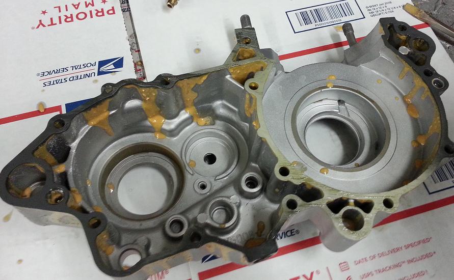

Welcome to our case lapping shop.
Notice how when we first start the sedges are dark gray and the center is yellow?
That's because the outside edges are making contact but the inside of the cases are not.
Can you say Air Leak?
We knew you could!!! :D
91 KX500 OEM-CYCLE.COM CASE LAPPING 107.JPG (48.04 KiB) Viewed 11385 times

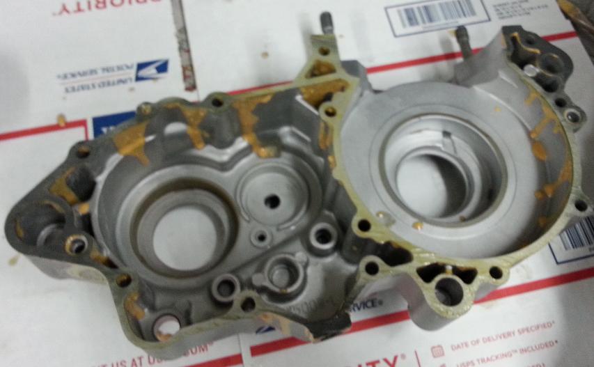

After 10 minutes on the lapping machine you can see that there is more dark grey...
But still there is that persistent yellow in the middle.
91 KX500 OEM-CYCLE.COM CASE LAPPING 108.JPG (80.09 KiB) Viewed 11385 times

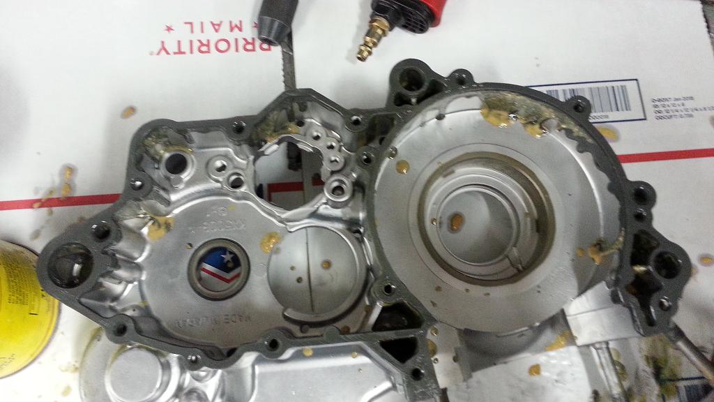

After about 20-25 minutes total we are getting a nice consistent dark grey all the way around... Success!!
91 KX500 OEM-CYCLE.COM CASE LAPPING 109.JPG (106.69 KiB) Viewed 11385 times
