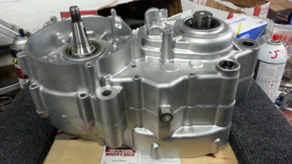

Well.... I didn't get pics before we started but at least I got a few after we got started.
A little background...
On the Cylinder we did all the Kawasaki Team Green mods plus a few.
Stock Port timing.
Cylinder was then sent to Millennium for plating.
Wossner Piston.
Head squish and compression release mod was done by Roostius.
Cases were stripped and Vapor Blasted.
Then all the oil gallies were cleaned up and the cases were lapp8ed with time saver.
We ordered the following internal parts:

Wossner rod kit
Rebuild, Weld, True, and Balance to 59% by Pinsonnault Racing.
Koyo Crankshaft main bearings and seals
Cometic bottom end gasket kit
The exhaust valves were junk but luckily I had a set.

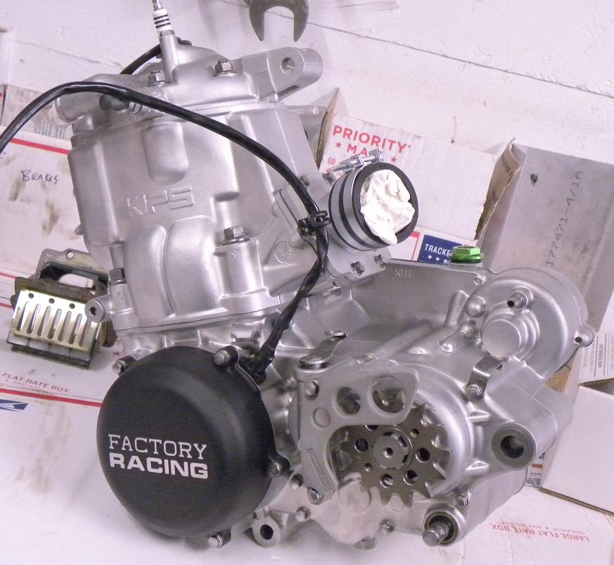

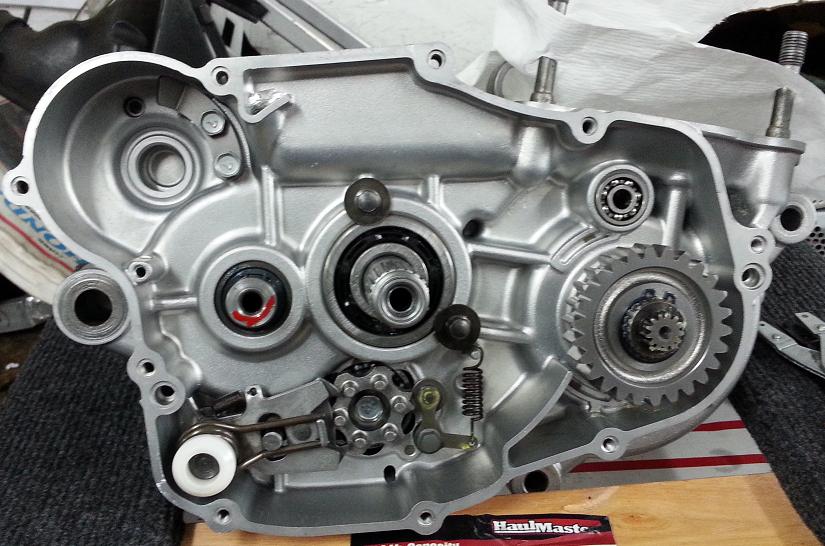

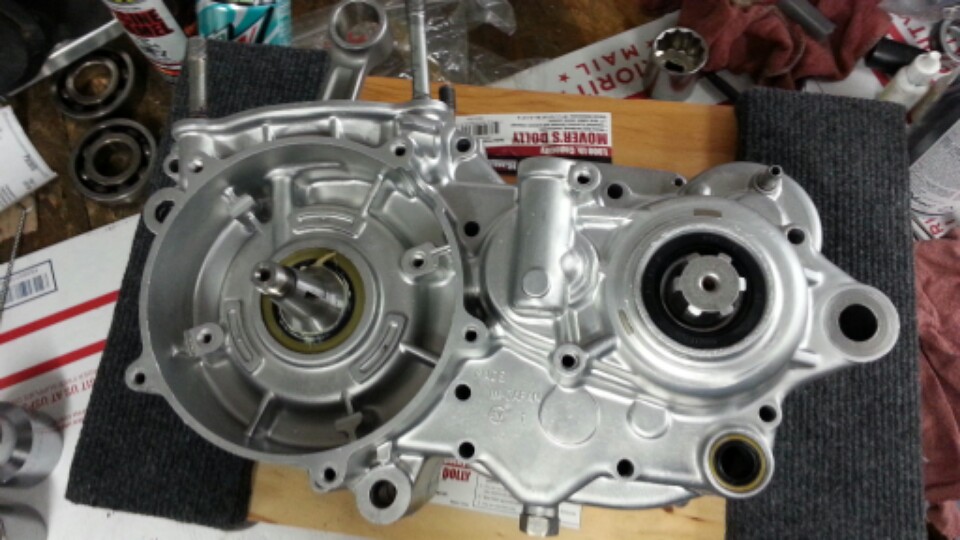

Here is a few pics of where we are at.
93 kx500 chad engine buils 101.jpg (104.8 KiB) Viewed 12982 times
93 kx500 chad engine buils 102.jpg (114.04 KiB) Viewed 12982 times
93 kx500 chad engine buils 103.jpg (101.57 KiB) Viewed 12982 times

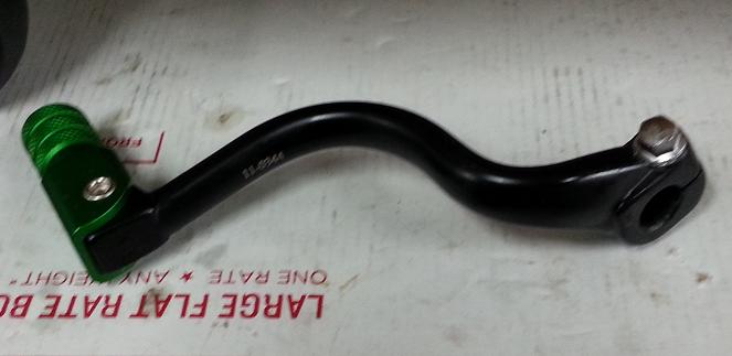

Another modification we did was swap out Chad's pre 94 shift shaft for a 94-04.
93 kx500 chad engine buils 104.jpg (85.5 KiB) Viewed 12975 times
Why?
He wanted to use a newer style shift lever from a KX450F
93 kx500 chad engine buils 105.jpg (22.87 KiB) Viewed 12975 times

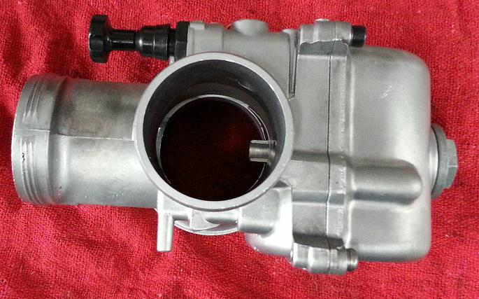

A nice carb cleaning..
93 kx500 chad engine buils 106.jpg (62.07 KiB) Viewed 12971 times
93 kx500 chad engine buils 107.jpg (84.99 KiB) Viewed 12971 times
93 kx500 chad engine buils 108.jpg (79.38 KiB) Viewed 12971 times
93 kx500 chad engine buils 109.jpg (60.3 KiB) Viewed 12971 times

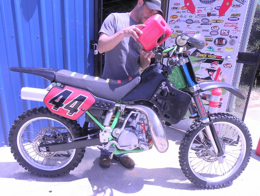

1st heat cycle is done... :o
Re: Chads 92 KX500 engine Build
One full tank is through it...
Chad says it has amazing power....
We knew that :lol:
