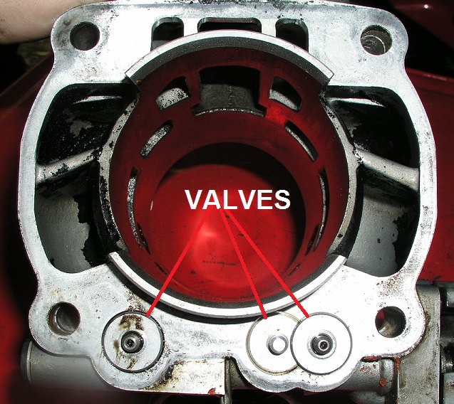

89-04 is easy.
If you have a 3 valve set up it's 89-04 and they are all the same.
89-04 KX500 CYLINDER.jpg (162.47 KiB) Viewed 12722 times

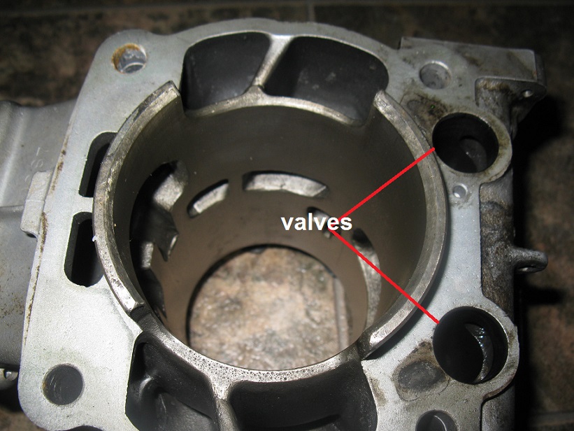

Here's where it gets a bit more tricky.
86-88 kx500's all have two valves,
86-88 cylinder.jpg (167.69 KiB) Viewed 12722 times

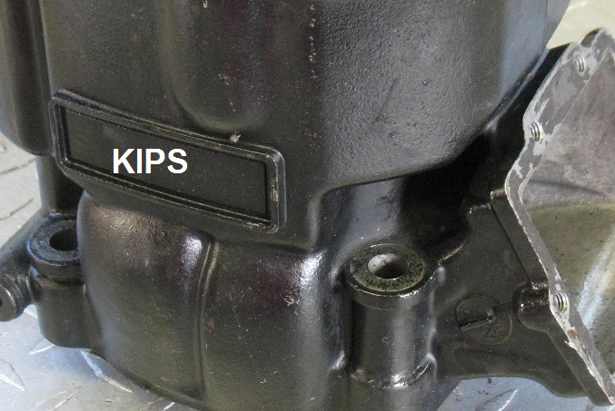

And the 88 kx500 cylinder is the only year that has KIPS in raised letters like this:
88 kx500 kips id on side of cylinder.jpg (146.04 KiB) Viewed 12722 times
Both 86-87 have a sticker on the side.
No sticker is shown but it's suppose to be there :D

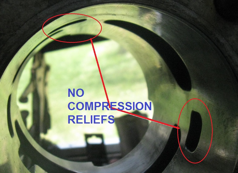

So how can you tell the 86 from the 87 cylinder?
Apart from the exhaust degree timing there is a easy visual way.

Now take a look at the 86 kx500 kips ports, note that there is no KIPS compression reliefs:
86 KX500 KIPS PORTS WITH NO RELIEFS.jpg (146.78 KiB) Viewed 12722 times
So that should help you out.
There may be other visual ID difference as well, but these are the ones I know about.
