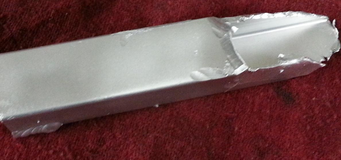

Here is some results for welding on Aluminum frames:
These results were based on the Brinell scale.
Here is the test piece from a 01 CR250:
test piece 1.JPG (71.22 KiB) Viewed 9184 times
01 CR250 square tube stock is 74
The edge of the weld is 70
The weld is 70.
Here's some comparison specs
86 CR500 swing arm 82
87 KX500 swing arm 78
97 KX500 swing arm 72 seemed odd but got the same # in multiple spots
2003 CR250 swing arm 83 , the frame is 80-83.
Re: How hot is too hot for your bearings, cases, and seals?
The person who did the testing said that he see's failures at about 60 on the Brinell scale.
