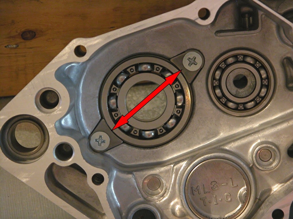

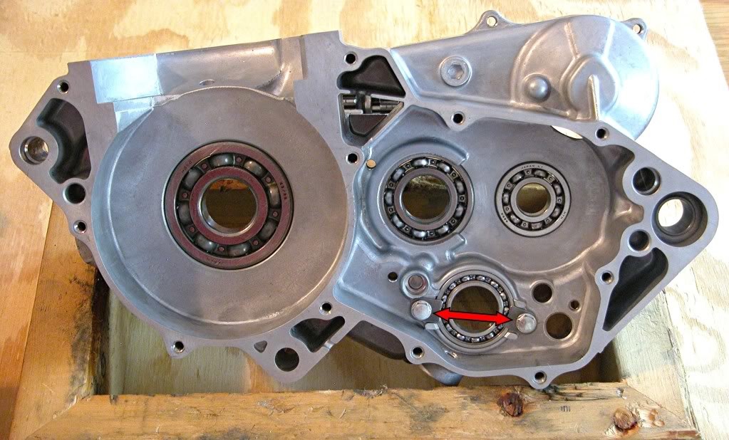

Starting with the right side case, install the bearing retainers
Dogger315 cr500 engine build at www.oem-cycle.com 100.jpg (216.34 KiB) Viewed 19716 times

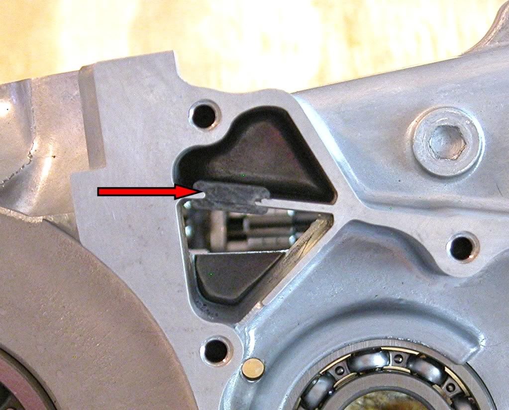

Install the rubber baffle.

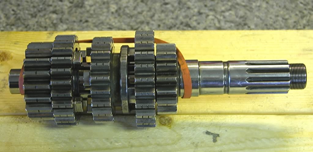

Then install the previously assembled transmission clusters
Dogger315 cr500 engine build at www.oem-cycle.com 103.jpg (125.69 KiB) Viewed 19716 times

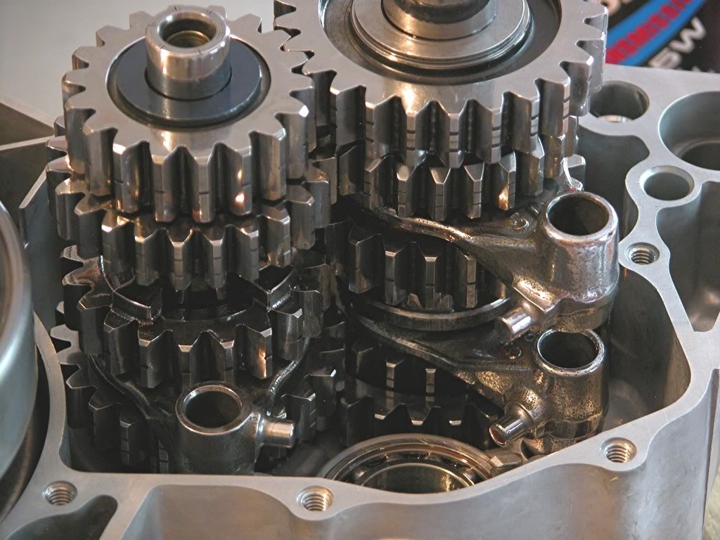

Next up are the shift forks. Forks stamped "R" and "L" on the right
side of the shift drum with "R" on the bottom and the fork stamped
"C" on the left. Douse everything in gear oil before installing

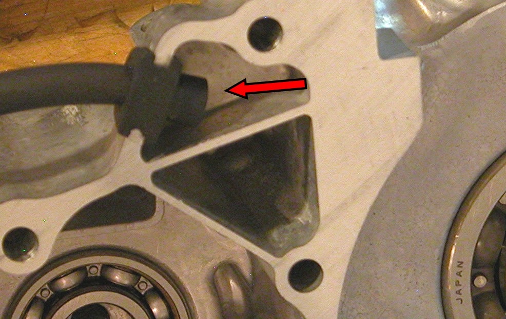

install the crankcase ventilation hose.
Dogger315 cr500 engine build at www.oem-cycle.com 110.jpg (203.25 KiB) Viewed 19716 times

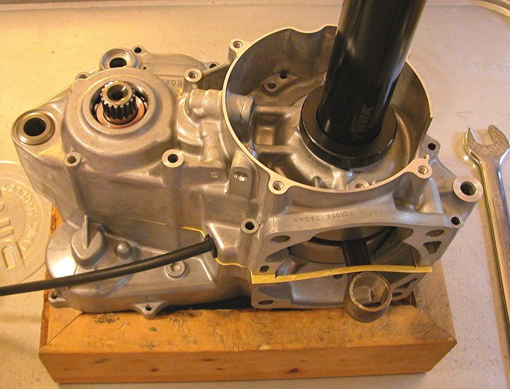

Place the left side case on the right and install using the crankshaft
installation tool as shown to pull the case together while keeping a
constant gap.
Dogger315 cr500 engine build at www.oem-cycle.com 112.jpg (263.25 KiB) Viewed 19716 times

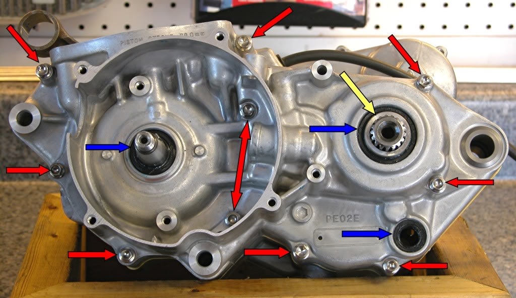

Remove the crankshaft installation tool, install the 10 bolts (Red arrows),
and tighten to 7 lb.ft. Pack the seal lips with grease and install (Blue
arrows). Grease a new O ring and place it in the collar (Yellow arrow)
and install. Don't forget the seal over the clutch actuating rod bore
inside the ignition cavity (not marked). Finally, trim the excess gasket
material above the cylinder deck.

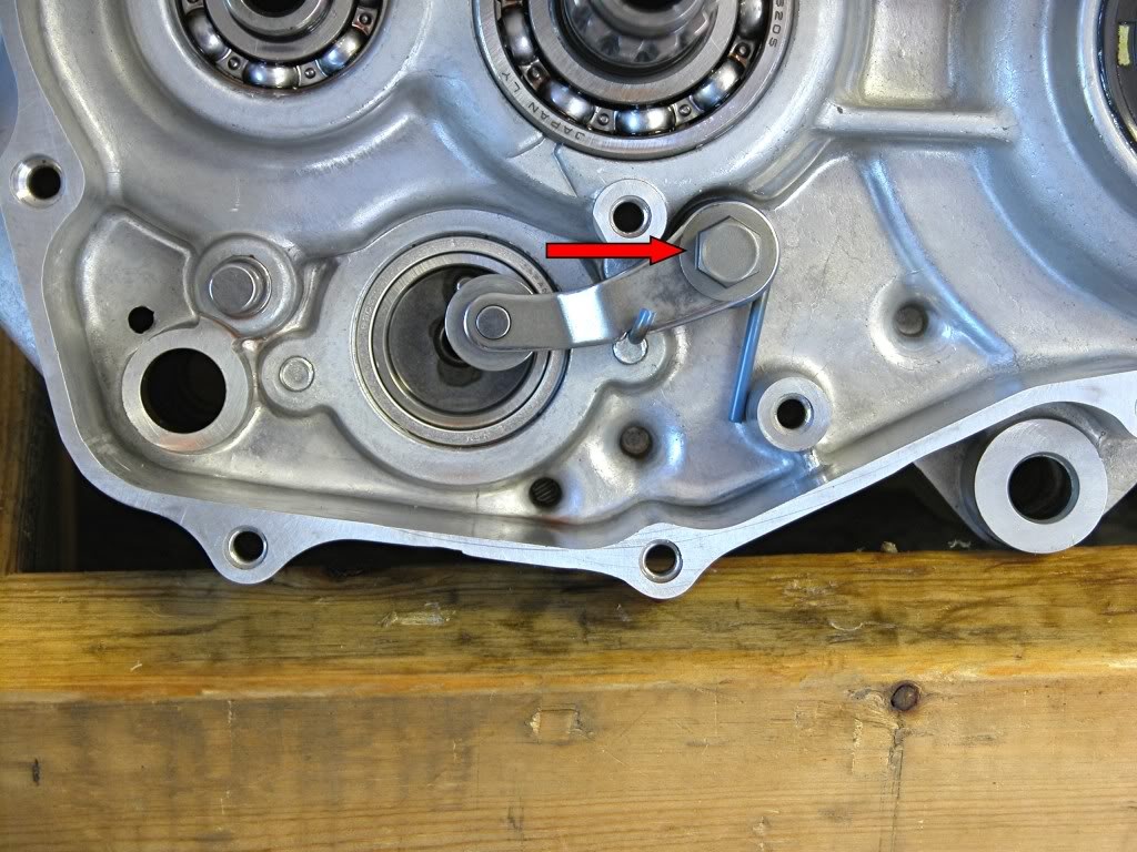

Start with the neutral stopper arm.
Dogger315 cr500 engine build at www.oem-cycle.com 115.jpg (249.16 KiB) Viewed 19716 times
Install the lever and a new spring and washer. Torque the bolt (arrow) to 9 lb.ft.

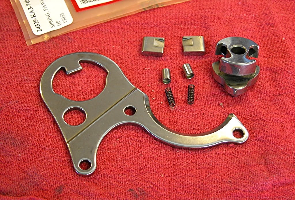

Assemble the drum shifter components into the guide plate. Coat all the
components with clean gear lube. As I stated previously, these are new
pawls, springs and plungers that should be replaced at every rebuild.
Dogger315 cr500 engine build at www.oem-cycle.com 116.jpg (351.5 KiB) Viewed 19716 times

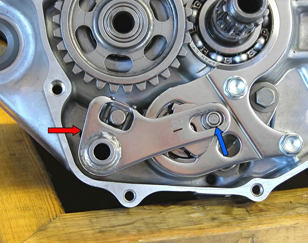

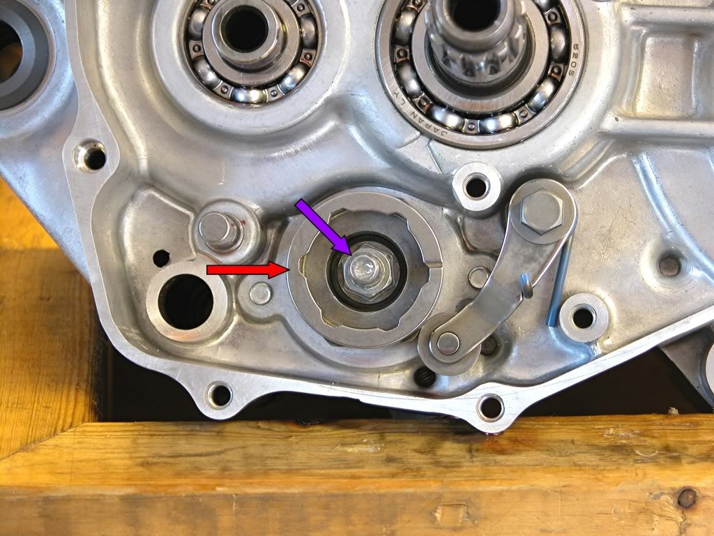

Install guide pin in the shift drum then install the drum center (Red arrow)
while holding the neutral stopper arm back with a screwdriver. Torque the
center pin (purple arrow) to 16 lb.ft.
Dogger315 cr500 engine build at www.oem-cycle.com 117.jpg (258.08 KiB) Viewed 19716 times

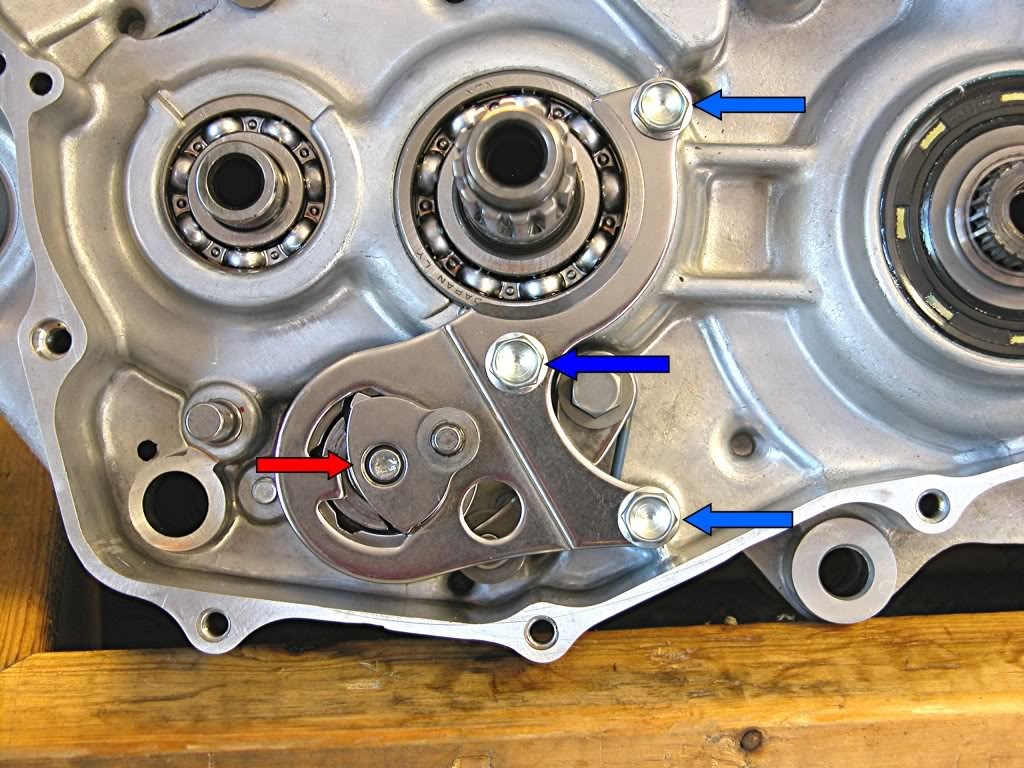

Set the drum center to a position other than neutral and install the
pre-assembled guide plate with the drum shifter over the center pin (Red
arrow), while holding on to the rachet pawls. Torque the three retaining
bolts (Blue arrows) to 10 lb.ft.
Dogger315 cr500 engine build at www.oem-cycle.com 118.jpg (294.09 KiB) Viewed 19716 times

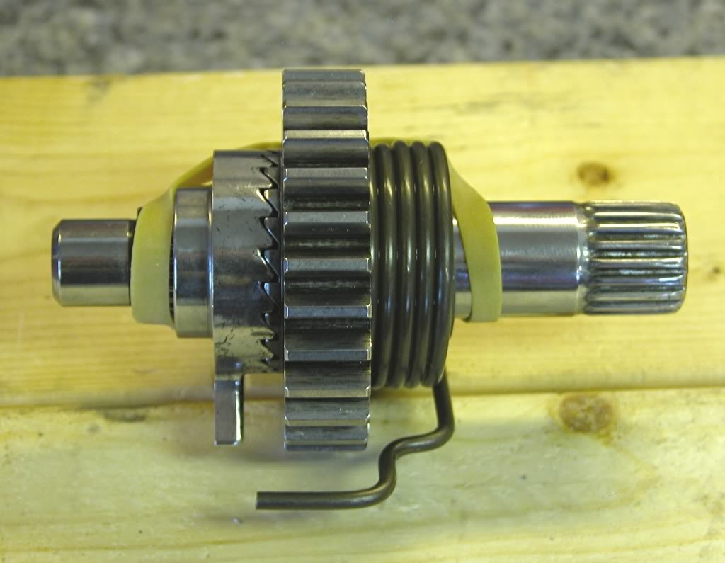

Assemble the kick start assembly as shown.
Dogger315 cr500 engine build at www.oem-cycle.com 119.jpg (113.75 KiB) Viewed 19716 times

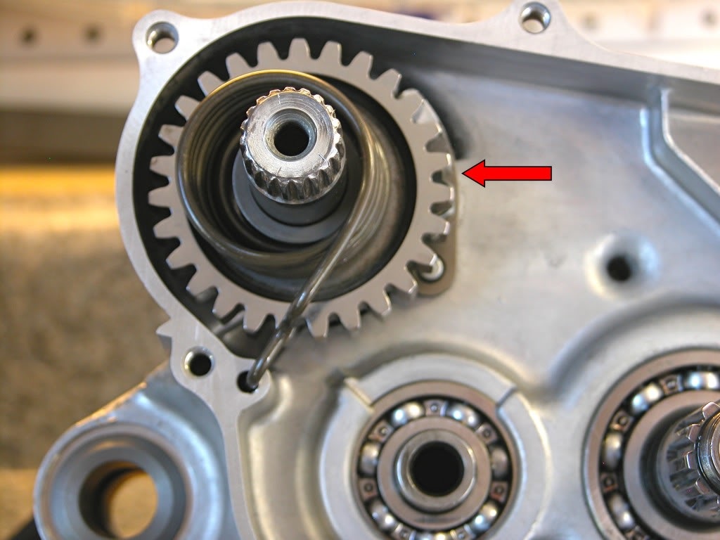

Place the kick start assembly in the case and wind the new return spring clockwise until the end can be inserted into the case.

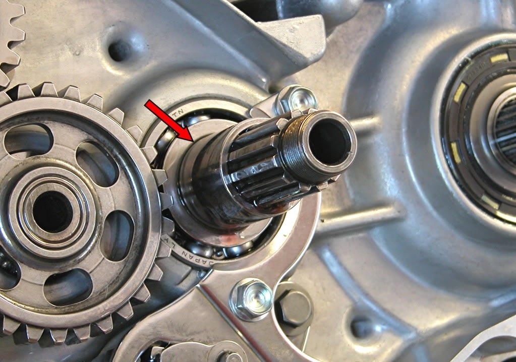

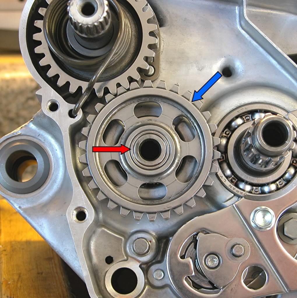

Install the idler gear (Blue arrow)and bushing (Red arrow) after coating both with gear oil.
Dogger315 cr500 engine build at www.oem-cycle.com 121.jpg (310.42 KiB) Viewed 19716 times

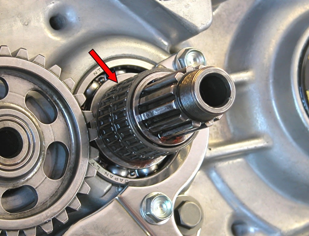

Coat the needle bearing with gear oil and install.
Dogger315 cr500 engine build at www.oem-cycle.com 124.jpg (215.46 KiB) Viewed 19716 times

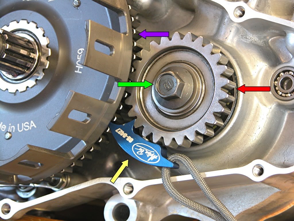

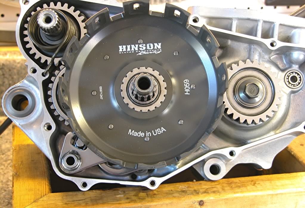

Install the primary drive gear (Red arrow) and bolt/washer (Green arrow).
Install the clutch outer (Purple Arrow). Place a gear jamming device
(Yellow arrow) between the primary gear and clutch drive gear as shown
and torque the primary drive gear bolt (Green arrow) to 33 lb.ft.
Dogger315 cr500 engine build at www.oem-cycle.com 125.jpg (259.63 KiB) Viewed 19716 times

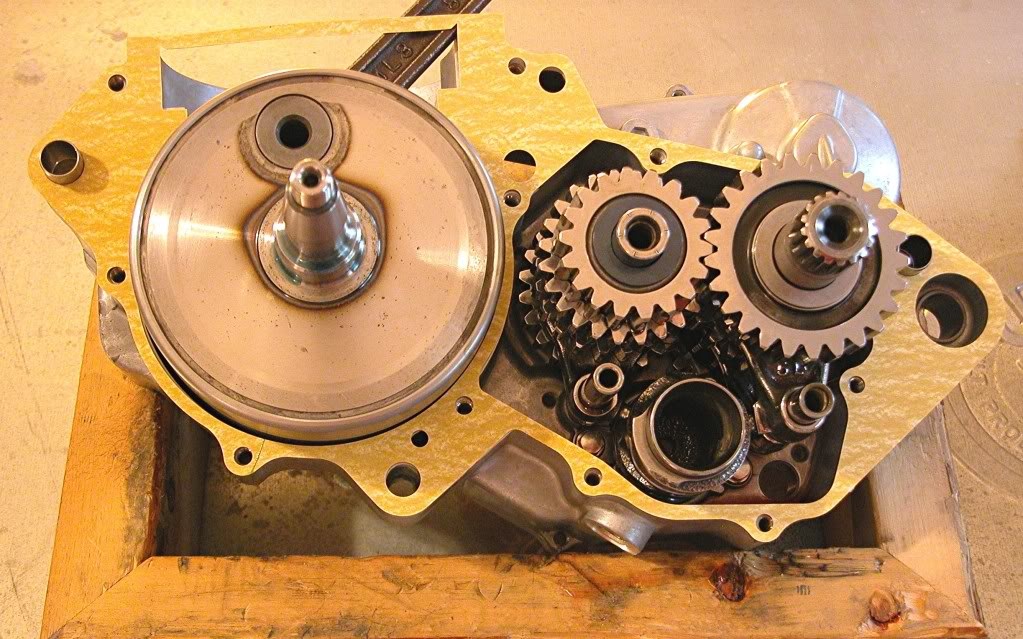

That's everything on the right side.
Dogger315 cr500 engine build at www.oem-cycle.com 126.jpg (224.29 KiB) Viewed 19716 times

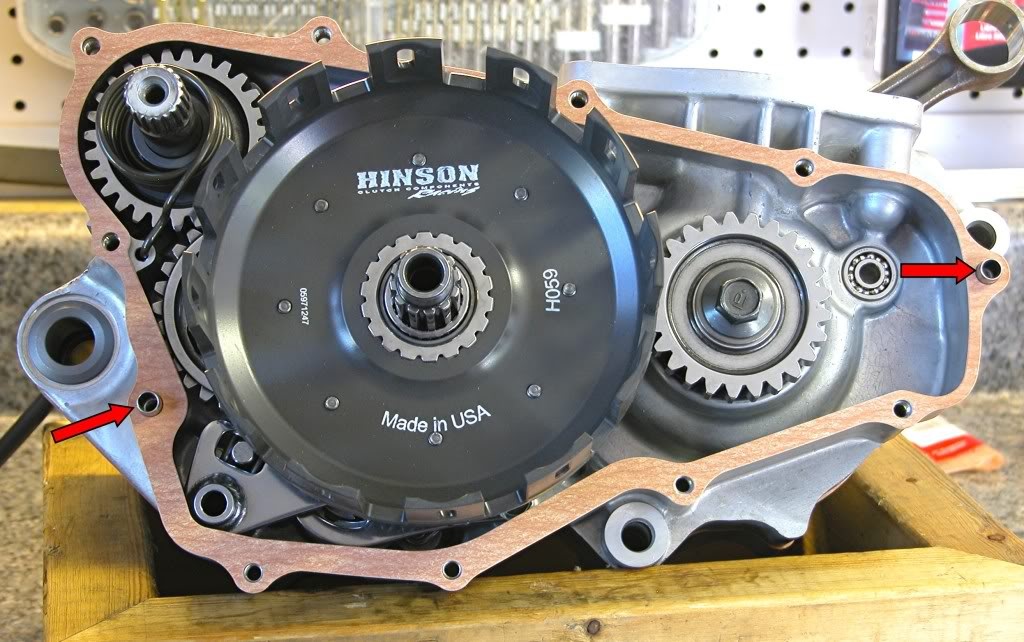

Oil and install the two dowels (Red arrows) and a new gasket.
Dogger315 cr500 engine build at www.oem-cycle.com 127.jpg (217.36 KiB) Viewed 19716 times

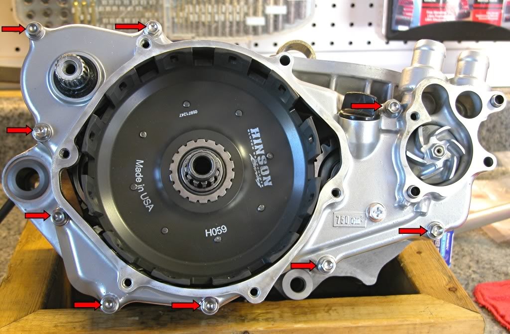

Install the right side case cover, torquing the bolts to 7 lb.ft. in several
steps and in a criss cross pattern. If you are using ti bolts, make sure you coat
them with grease or ti prep prior to installation or you may never get them out
in one piece.
Dogger315 cr500 engine build at www.oem-cycle.com 128.jpg (197.79 KiB) Viewed 19716 times

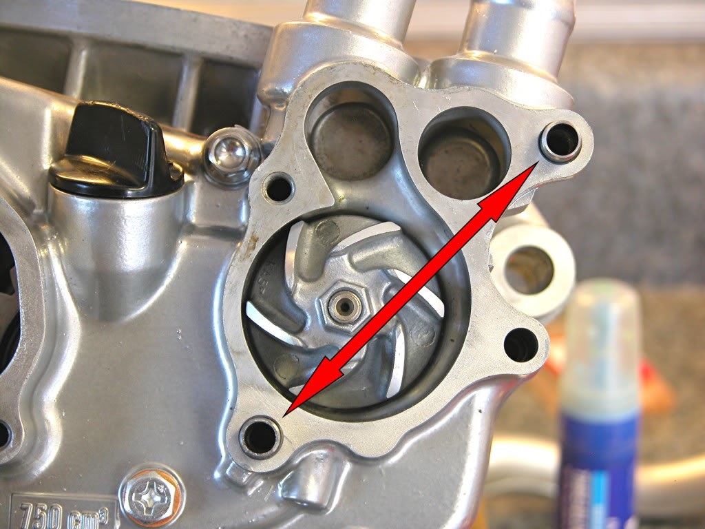

Oil and insert the two dowels as shown
Dogger315 cr500 engine build at www.oem-cycle.com 129.jpg (197.7 KiB) Viewed 19716 times

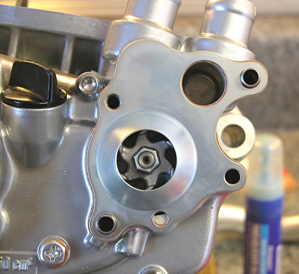

Place a new gasket on the water pump housing followed by the separator
plate.
Dogger315 cr500 engine build at www.oem-cycle.com 130.jpg (185.03 KiB) Viewed 19716 times

Place a second gasket on the separator plate.
Dogger315 cr500 engine build at www.oem-cycle.com 130.jpg (185.03 KiB) Viewed 19717 times
Install the water pump cover and torque the bolts to 9 lb.ft.
Dogger315 cr500 engine build at www.oem-cycle.com 131.jpg (181.52 KiB) Viewed 19717 times
That's it for this time. Next, the clutch and ignition.
