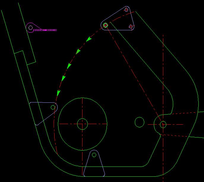

Because a few people had problems breaking their frame rails I wanted to be sure I understood where the transfer of energy was taking place at.
Here is a rough diagram of where the mounting points are in relation to the frame.
- frame lay out.JPG (36.63 KiB) Viewed 16025 times
As you can see, when coming down hard on a jump the force is transferred in a radial motion.
So, the rear mounts must be in line as much as possible with the direction of the force.
Further, having the front mount on the head helps to stop any force that is trying to be transferred to the frame rails.

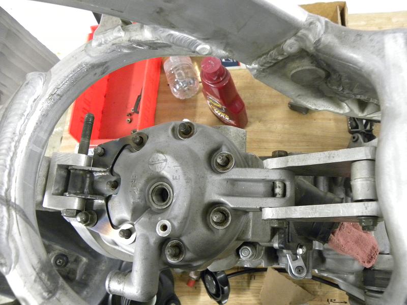

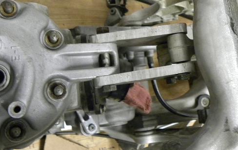

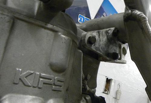

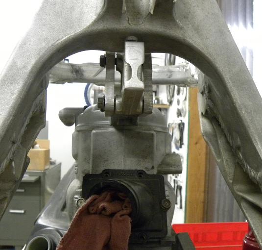

Here is some pics of the different views.
Nothing is welded yet but you get the idea:
- K5AF REAR HEAD MOUNTS TOP VIEW.JPG (24.41 KiB) Viewed 16025 times
- K5AF REAR HEAD MOUNTS TOP VIEW 2.JPG (82.35 KiB) Viewed 16025 times
- K5AF REAR HEAD MOUNTS REAR VIEW.JPG (39.27 KiB) Viewed 16025 times
- K5AF REAR HEAD MOUNTS BOTTOM LEFT SIDE.JPG (22.37 KiB) Viewed 16025 times
