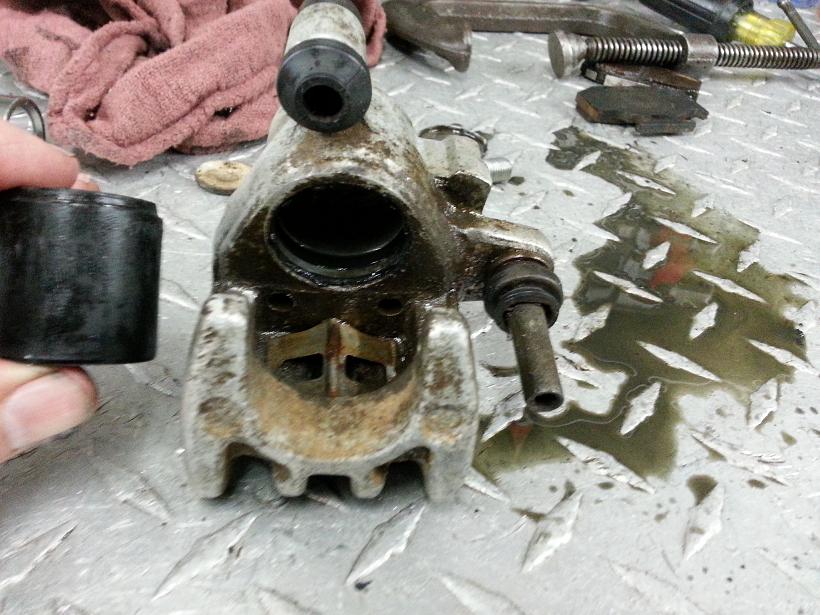

Typically they will shoot out with a noticeable pop..
If you don't use a rag to keep the piston from shooting out, be sure to aim it in a safe direction because the piston will easily shoot out 12 or more feet even under fairly low air pressure.
This one oozed out because the piston and seals were completely gummed up.
