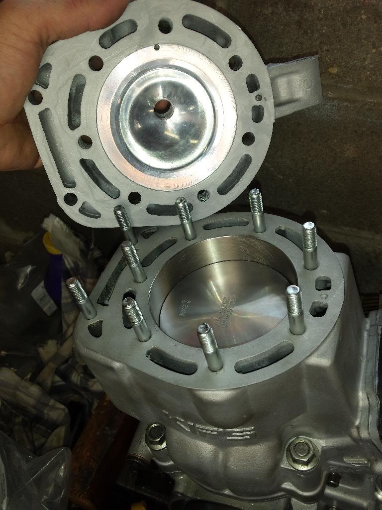

jug is on. so I can now measure deck. to fine tune my head CC's to hit the compression ratio I want.
.048" positive deck hight.
Formula For Milling PistonsTop per lunati
(For 4032 material only)
Piston dome cc's to gram conversion: 1cc (volume) = 2.8 grams (weight)
This is a good way to remove excess dome without having to re-cc piston: Mill a small amount and re-weight piston until total reduction is reached.
Example:
A piston has 12.5cc effective dome volume. The desired effective dome volume is 10.5cc.
To remove 2.0cc, cut 5.6 grams (2 X 2.Cool from the piston dome.
sandblaster
It's gonna depend on the alloy content of the aluminum used.
Good luck finding that.
Since you know that, I can only assume that this is another test to keep me endlessly searching the internet for trivia that can't be found.
Darn you Motorrad!
So I suspect that the difference between your calculations using 4032 and the cast aluminum will be so slight as to be difficult to measure.
Then again I don't weigh things by their sub atomic densities.... very often

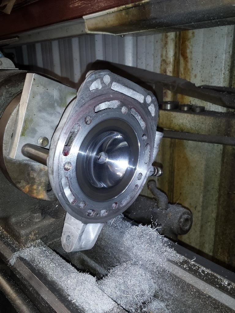

Motorrad
Perhaps you should start
Other head had been cut too much to get it up to the needed chamber cc
So
Started with a new head
And fresh off the lathe from being molested

Missed my cc's a bit. So here we are making some cc adjustments. Now we are within 1/4 of a cc. Close enough for me
Head hand lapped to perfection. And very smooth gasket surface.

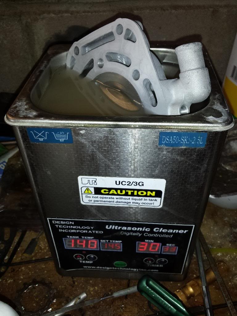

Trip through ultrasonic cleaner to get any compound from polishing or lapping off.

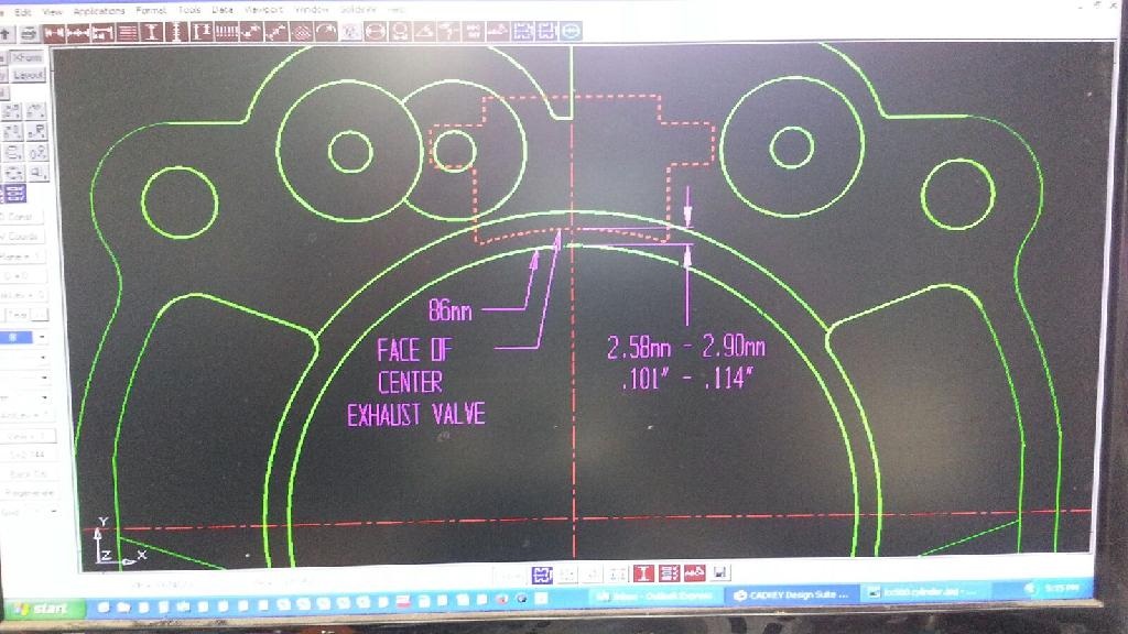

.04725" squish clearance. If anyone besides blaster cares
81cr450
.04725 ? due to the cc recalc or on purpose, always thought .037 was the G spot. Care to quantify
just curious, if theres a practicality behind it, i have the 87 head thats already near .100 in the hole

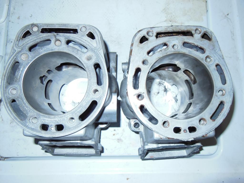

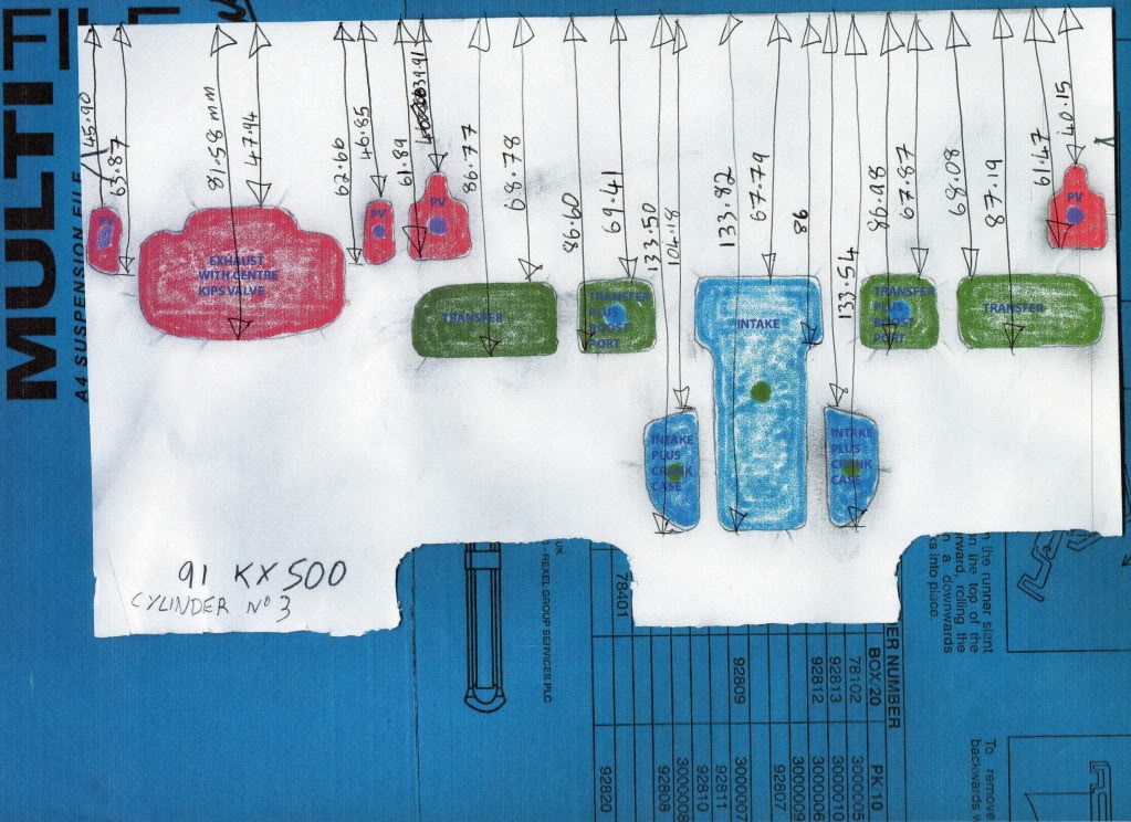

Looking through this thread and unless I've missed it (its possible but I think I've had a good look through the thread) there doesn't seem to be much mention of the fact that the cylinder on the right (the Jeff Ward one) has one single window on each side of the main exhaust port instead of the two each side like the standard one.
Now if I remember right those ports go to the powervalve's and the Jeff Ward jug has basically removed the bridge between those powervalve ports and squared the holes up.
In this picture they are labled PV and the measurements are only measured off the paper top and not absolutely exact so don't trust them too much.
sandblaster
And a few other mods as well
Motorrad
That work wasn't done by team green.
There is A LOT of work done in that area if you know what to look for
timing set
Motorrad
timing set
