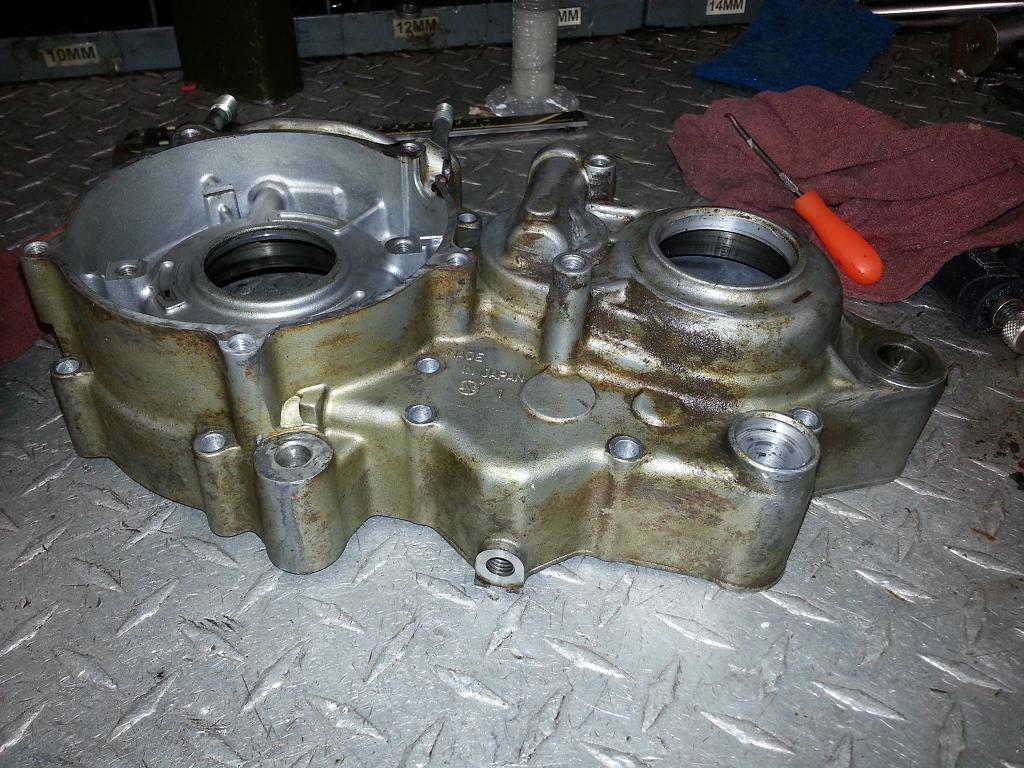

Starting with a nice clean set of cases is mandatory.
I'm using cases from a 94 KX500 so they will take a little bit of Elbow Grease to get them cleaned up and ready.
You can get this stuff and directions on how to use it from your parents or grand parents.
ELBOW GREASE.jpg (91.73 KiB) Viewed 4979 times

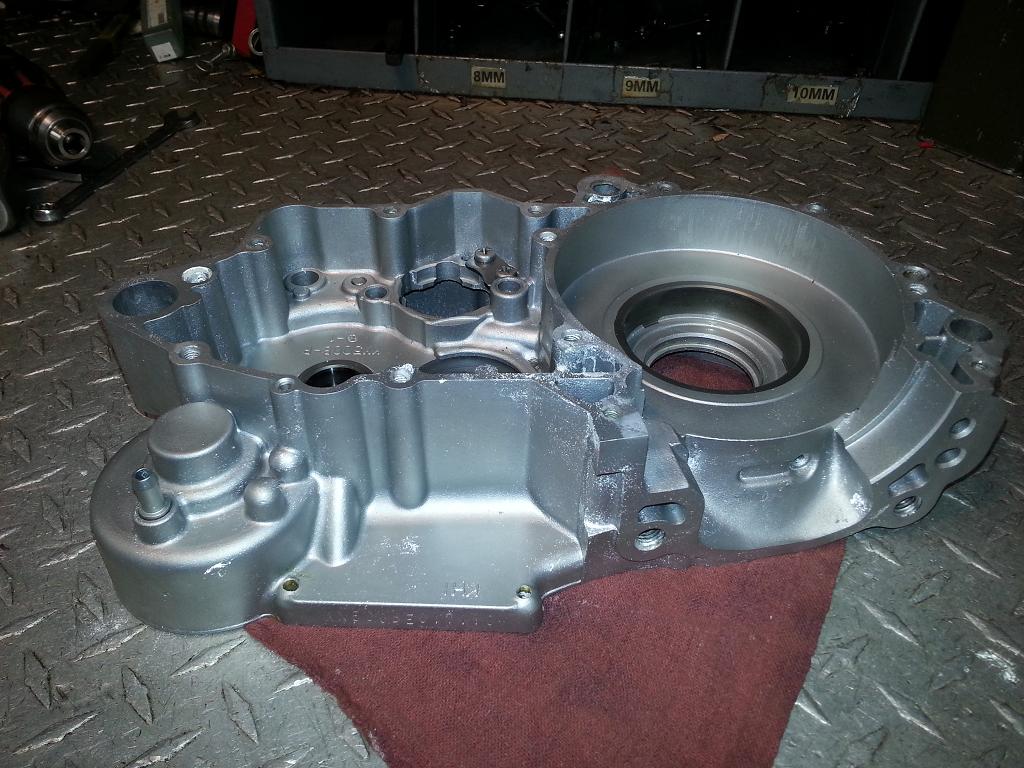

Now that I have spent a bunch of time cleaning.... I'm going to mic the bearing journals to be sure they are in spec.
I assumed that they were because of how the bearings came out but that is really no substitute for a mic.
KX500 ENGINE CASE CLEAN UP 1000.JPG (140.04 KiB) Viewed 4979 times
71.93mm

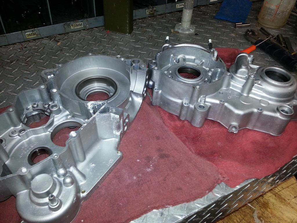

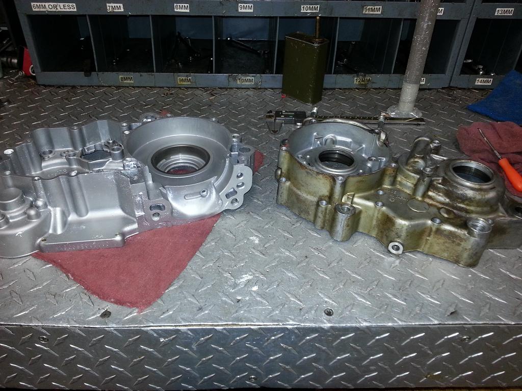

Re: BUILDING A KX500 FOR HIGHER PORT TIME
Here's some pics of the other case half for a comparison
KX500 ENGINE CASE CLEAN UP 1001.JPG (163.4 KiB) Viewed 4979 times
KX500 ENGINE CASE CLEAN UP 1002.JPG (150.02 KiB) Viewed 4979 times
Ok... Good enough for a thorough inspection..
I will be cleaning them a bit more after I finish a few more things on the cases.
KX500 ENGINE CASE CLEAN UP 1003.JPG (144.92 KiB) Viewed 4979 times

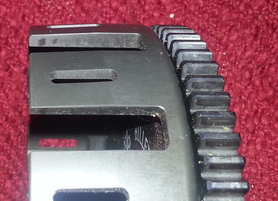

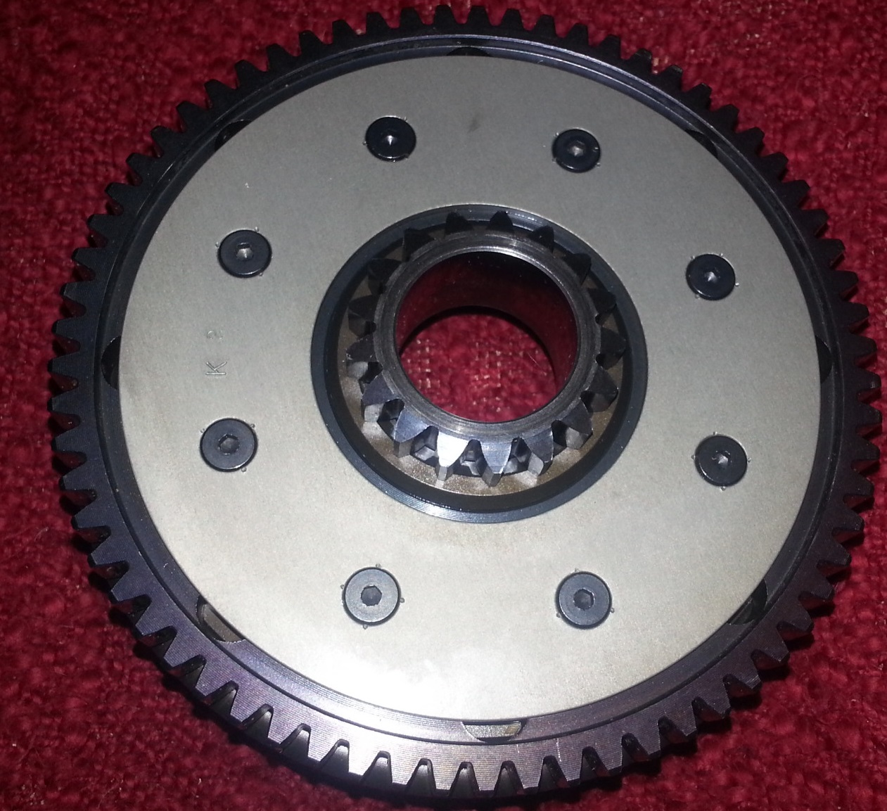

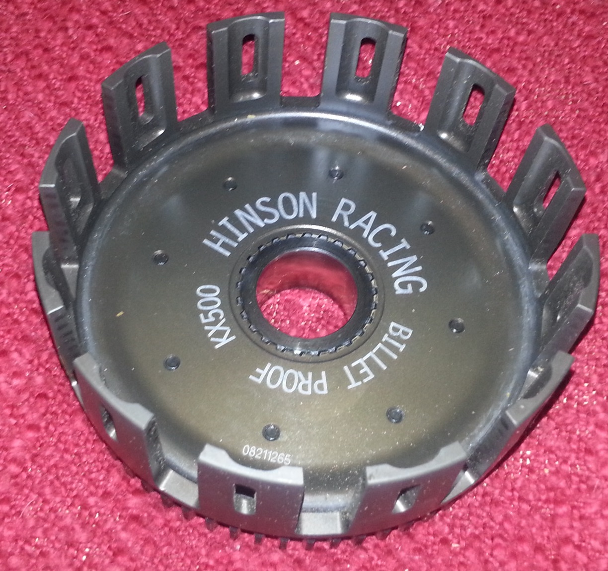

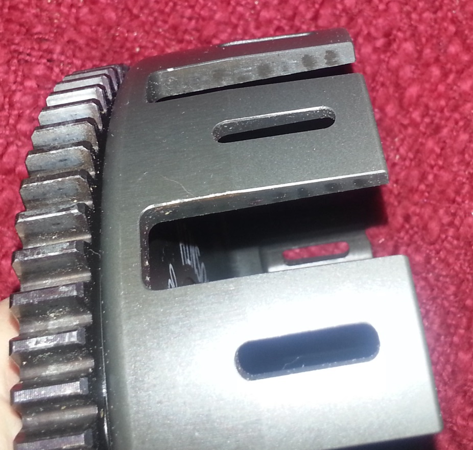

Lucked out and found a Hinson basket for this beauty..
oem-cycle.com kx500 hinson clutch basket 101.jpg (425.54 KiB) Viewed 4892 times
oem-cycle.com kx500 hinson clutch basket 102.jpg (401.82 KiB) Viewed 4892 times
oem-cycle.com kx500 hinson clutch basket 103.jpg (178.02 KiB) Viewed 4892 times
oem-cycle.com kx500 hinson clutch basket 104.jpg (220.59 KiB) Viewed 4892 times
Only minimal wear... I couldn't be happier :D
