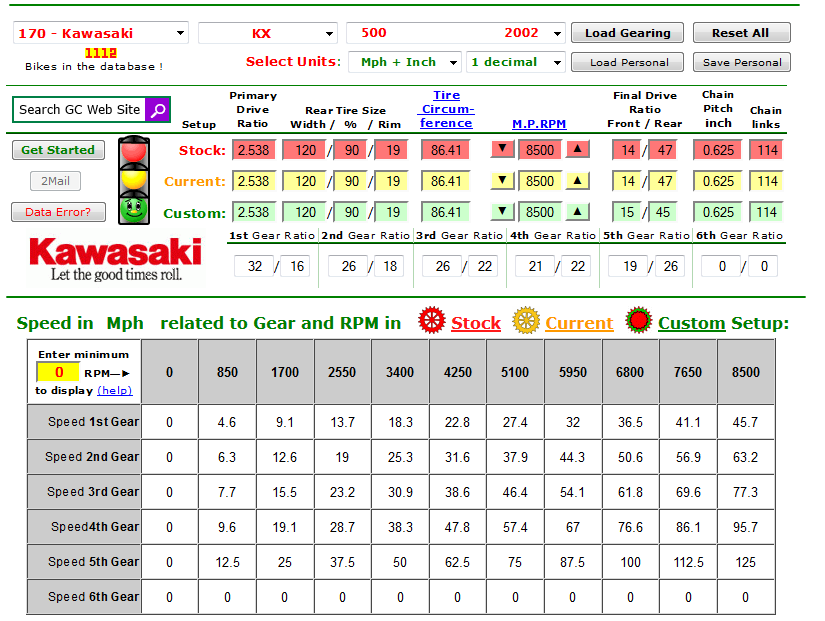

I have 3/4 spare engine with complete gearbox to see how it fits.
And a old third gear to narrow a bit.
End of next year there's finaly a Beachrace. So I need a Overdrive grin
I want to go faster than 200km/h (125mph).

If the gearing works out and you can pull 8500 RPM in the new 5th gear, you will need to run a 15/45 sprocket set up.
kx500 over drive transmission oem-cycle.com 103.png (59.58 KiB) Viewed 4668 times
