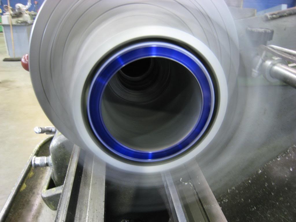

Here's how I do copper head gaskets:

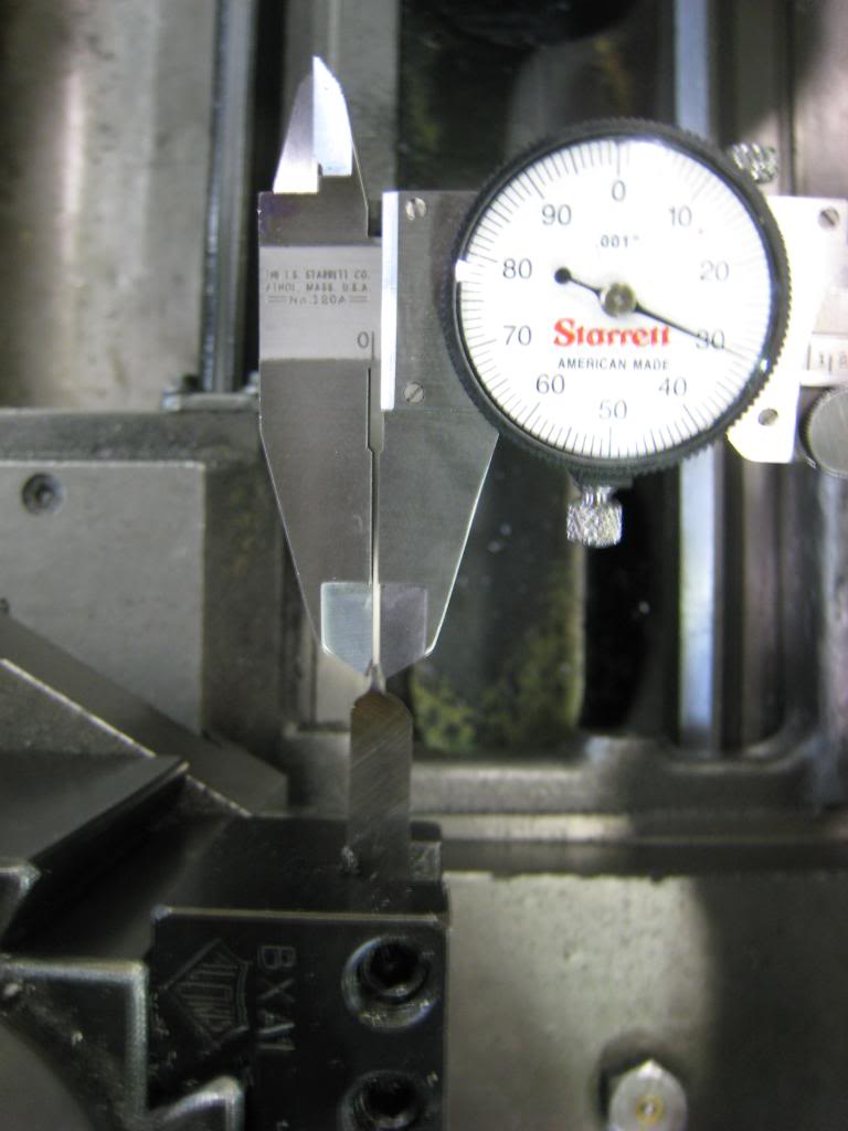

Make a cutter like this:
Motorrads Jeff Wards Engine build round 2 9-99999999999-1.jpg (58.74 KiB) Viewed 8737 times
Spin the cylinder (or head) like this:
Motorrads Jeff Wards Engine build round 2 9-99999999999-2.jpg (62.72 KiB) Viewed 8737 times

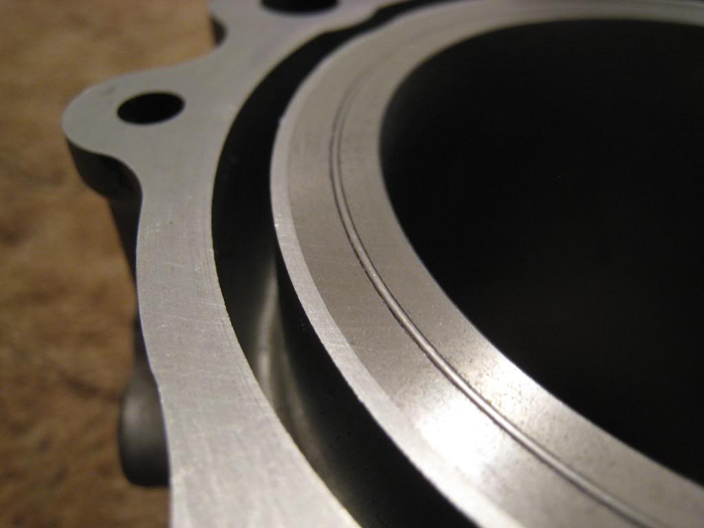

End up with a groove like this (.031" wide, .020ish deep):
Motorrads Jeff Wards Engine build round 2 9-99999999999-3.jpg (48.77 KiB) Viewed 8737 times

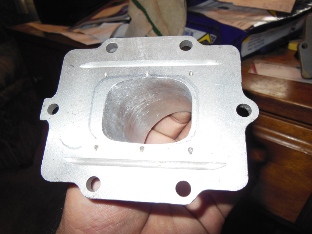

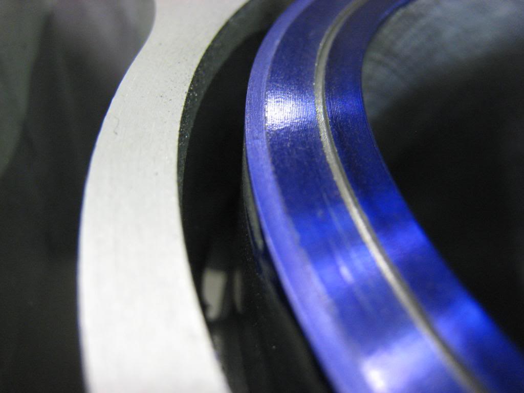

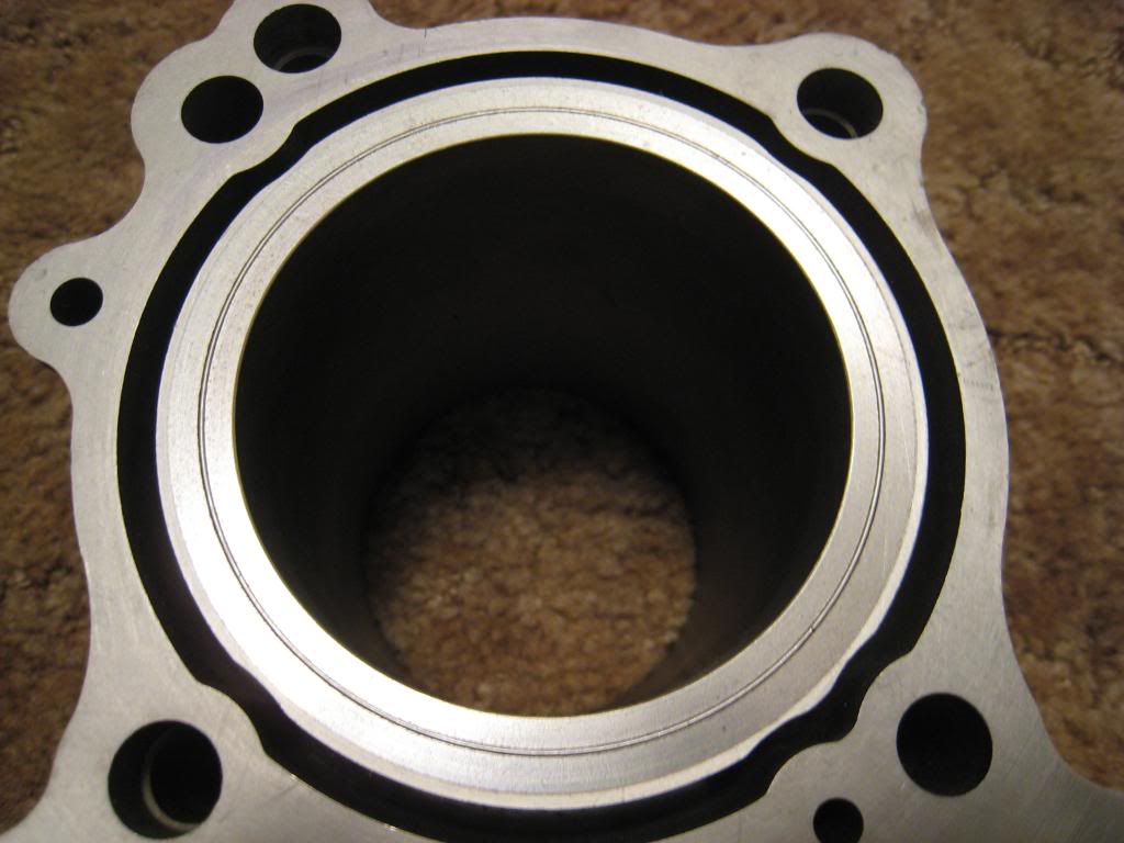

Tap in stainless wire (.032" dia):
Motorrads Jeff Wards Engine build round 2 9-99999999999-4.jpg (39.19 KiB) Viewed 8737 times
Motorrads Jeff Wards Engine build round 2 9-99999999999-5.jpg (72.96 KiB) Viewed 8737 times

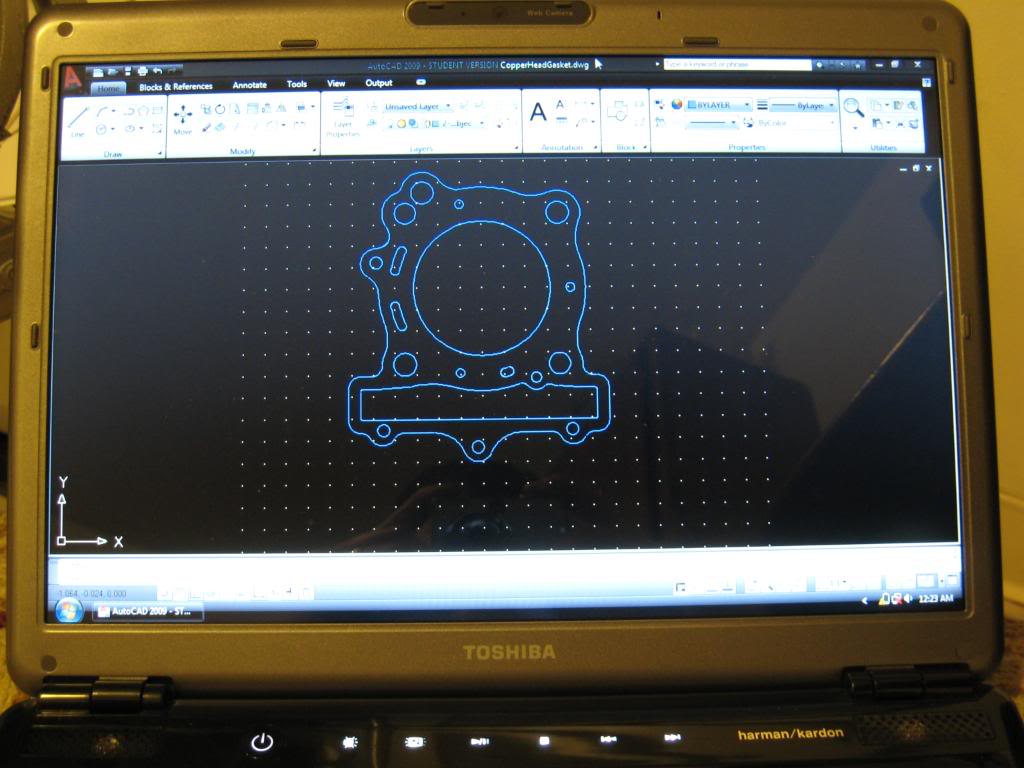

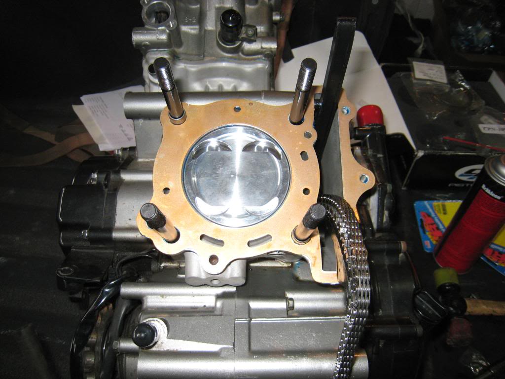

Design and waterjet a gasket:
Motorrads Jeff Wards Engine build round 2 9-99999999999-6.jpg (81.73 KiB) Viewed 8737 times
Coat with Hylomar and install:
Motorrads Jeff Wards Engine build round 2 9-99999999999-7.jpg (91.74 KiB) Viewed 8737 times
Then boost the heck out of it!

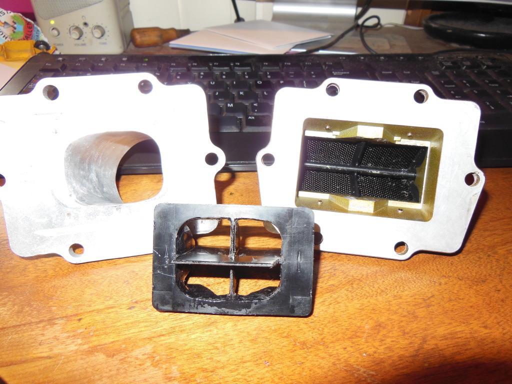

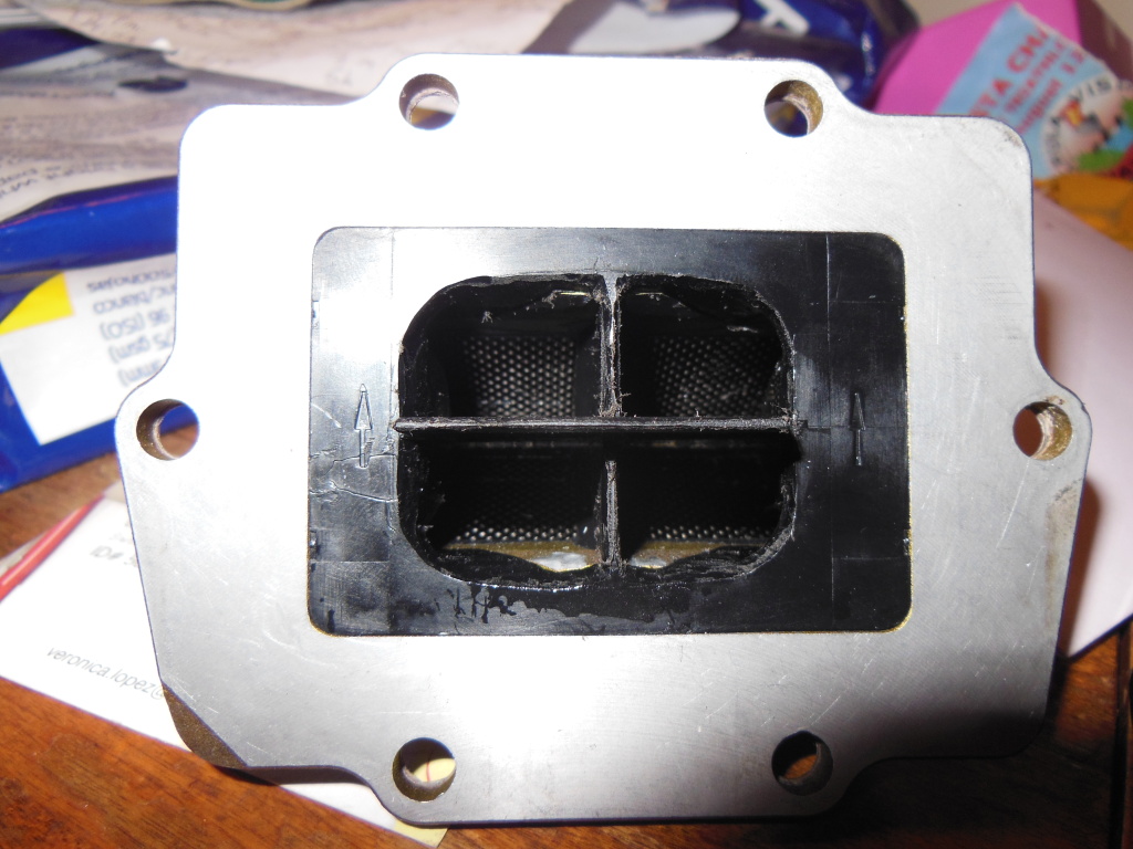

Okay dragging Reeds back up to the surface..
Im seriously thinking of running Kx250 reeds (the ones in the picture) with the stuffer...
some numbers to chew on..
All numbers are area rough....
44 mm Lectron output hole (motor side 42mm hole) = 2.1474 sqin
Stuffer in 87 reed cage (same size as square hole in rubber intake boot) = 3.168 sqin
Kx250 stuffer = 1.9704 sqin (same as a 40.5mm carb)
so its obvious the kx250 stuffer is much closer to the same size to keep velocity up than the stock stuff.. and with a bit of masaging, could be the same
If I modify the crapola out of the Half a Rad valve I have.... or it would actually be easyer to just make a new intake like BDI's (search for it people).... it would all bolt on without the MASSIVE volume change going to the motor.
Thoughts.
Brute
None except they would make cool napkin holders!
RoostDaddy
maybe look into the jetski reed cages "I know" there is one that will fit. If you have the tabs cut off your stock intake boot, no worries because this cage has a built-in stuffer. Now you can massage it all you want.
Motorrad
I know everyone was running cages off the 750 jetski for a while.. (the Vforce) before they were offered for the K5..
which cage are you talking about? The M-16 cages?
I know of these
http://jetskiperformanceparts.com/index ... ct_id=1350
RoostDaddy
Stock cage with built-in stuffer. You need to put better reeds on it though, the stockers dont seem to like a 500.
Motorrad
if its the cage Im looking at (stock ones out of the 750 and 800 ski) the intake hole looks the same size in that stuffer as the 87 cage.
which is where I see a problem. (in my head)..
the hole is HUGE.... compaired to the carb etc..
I dont have a flow bench etc. but in my head.. if you have a 42mm carb outlet.. keeping that same 42mm volume all the way to the reed tips makes sence. Am I wrong? Could be...
But I think this is why BDI and Doordie were seeing such great results with the 250cc vforce cage.. The K5 like its transfer ports, may be over reed/intake boot volume'ed...
Thoughts?
This is a discussion people... jump in...

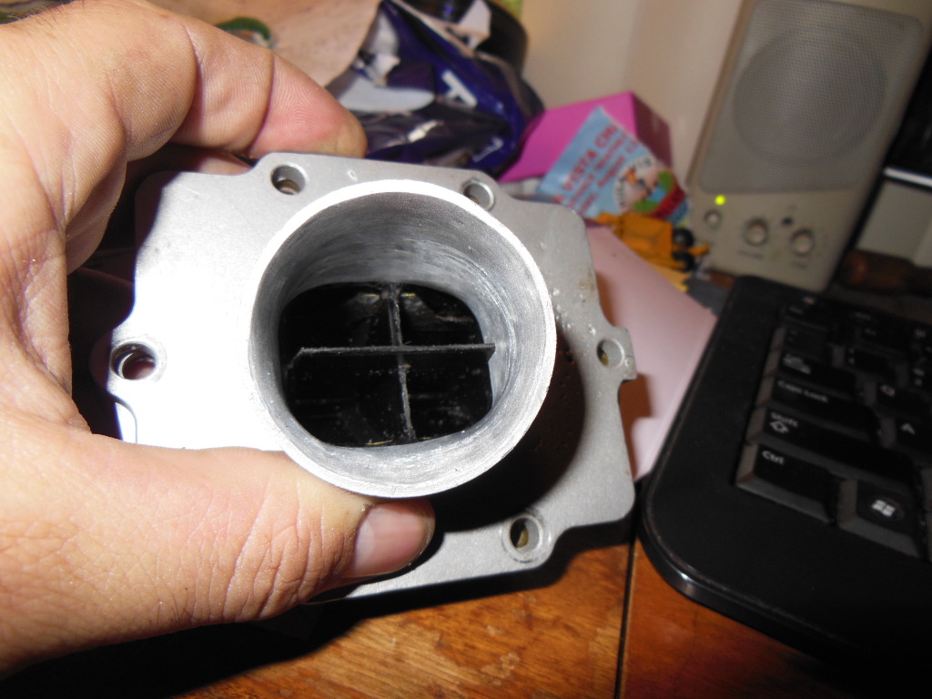

Motorrad
Okay... here ya go... (rough.. still need to smooth out and de-bur)
42mm (volume) from carb to reed tip....
Kept the general shape of the rad-valve... as I believe it did compensate for the curveed boot.. just larger now... (reason its not true hole at reed side)
Motorrads Jeff Wards Engine build round 2 9-99999999999-9.jpg (232.22 KiB) Viewed 8737 times
Motorrads Jeff Wards Engine build round 2 9-999999999999-1.jpg (226.59 KiB) Viewed 8737 times
Motorrads Jeff Wards Engine build round 2 9-999999999999-2.jpg (163.73 KiB) Viewed 8737 times
Motorrads Jeff Wards Engine build round 2 9-999999999999-3.jpg (164.94 KiB) Viewed 8737 times

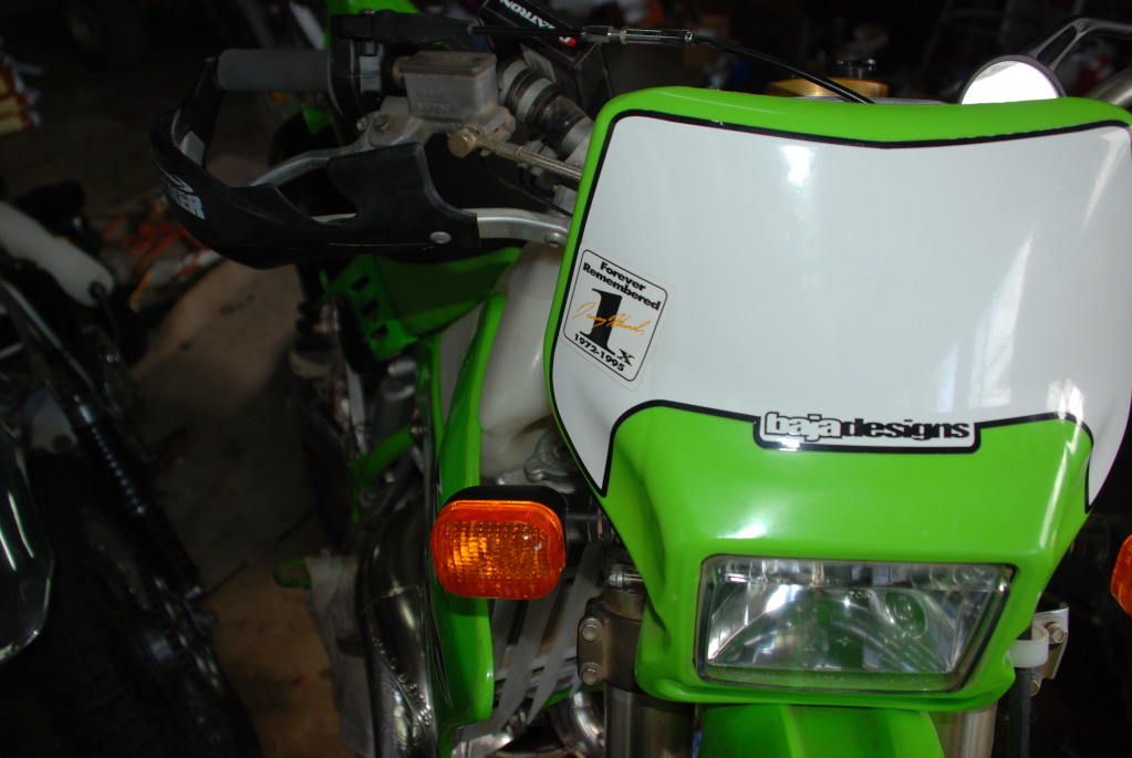

Motorrad:
I think danny would appriciate being on a team green, street legal KX..
KX500 JEFF WARD ROUND 2 BUILD 1001.png (1.01 MiB) Viewed 8705 times

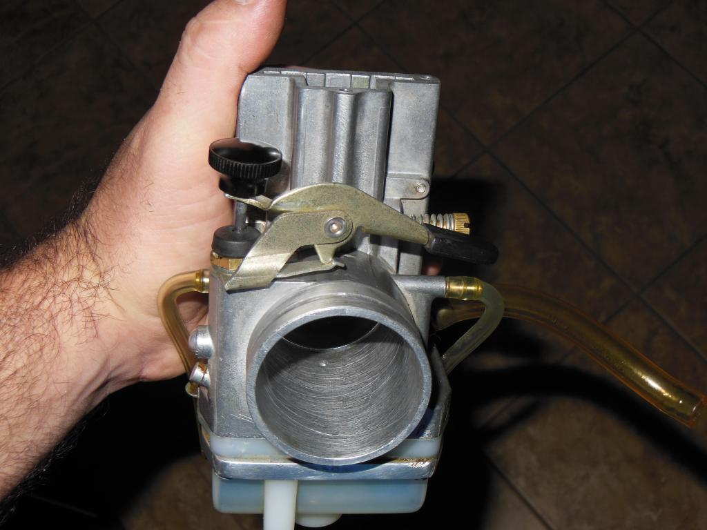

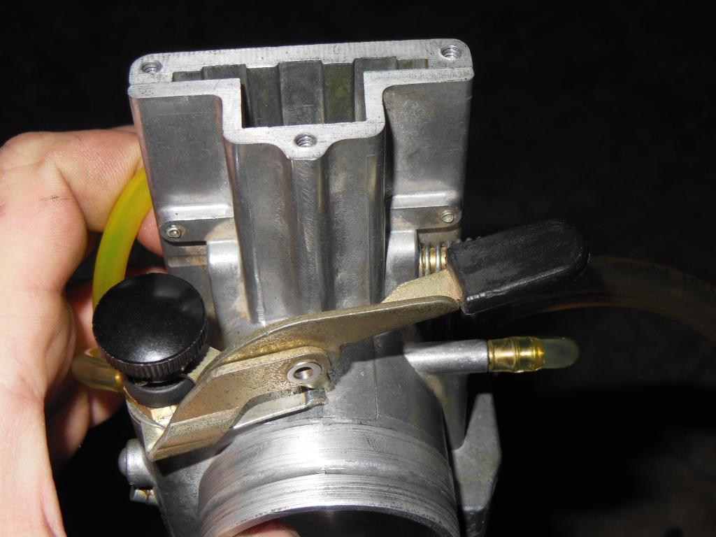

Modified the choke on my lectron today.
Most say you dont need a choke with a lectron. well my bike does. and the standard lectron choke SUCKS BALLS. its on the wrong side, so you have to reach in past the pipe to turn it on... AND THEN they dont stay on... nope... just fall back down. a bit too easy.
so.
little modification of the Original choke shaft. some doner parts from a Mikuni carb. and whala.
And a few "other" forums said it cant be done. rolleyes
