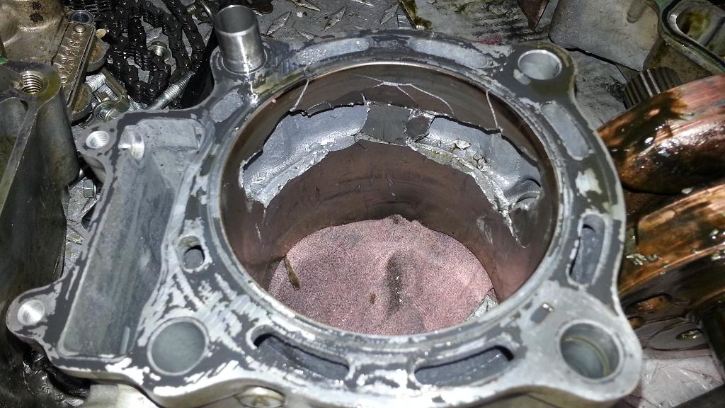

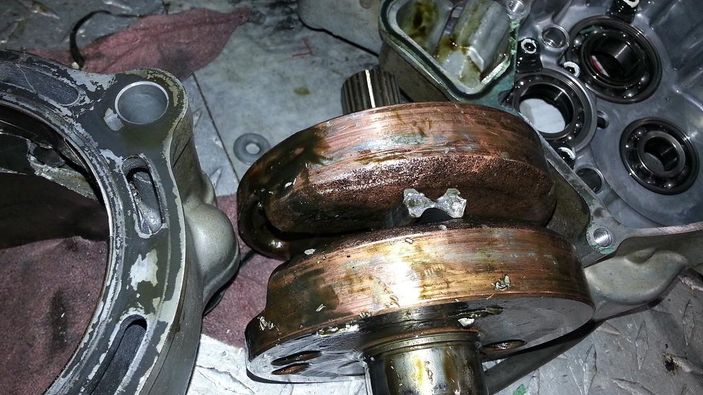

Today I picked up a 08 CRF450R.
Guess what?
Blown rod and destroyed top end.
So of course I'm thinking that this is another case of Honda's weak rod....

So, the one I bought today had parts of the piston sticking out through the cylinder :-o
Perhaps the problem has always been a piston design with a short service life...

This piston was so mangled I couldn't tell what it was.

Foxx4Beaver
holy s**t, now that qualifies as catastrophic!

I had a 05 TRX450r which is 90% the same motor.....rod broke in half and smashed the bottom of the cylinder then smashed the cases to pieces. Motor was a complete write off. I'll take some pictures when I go to parents place

This is what happens to those pesky red bikes that get in my way :shock:
