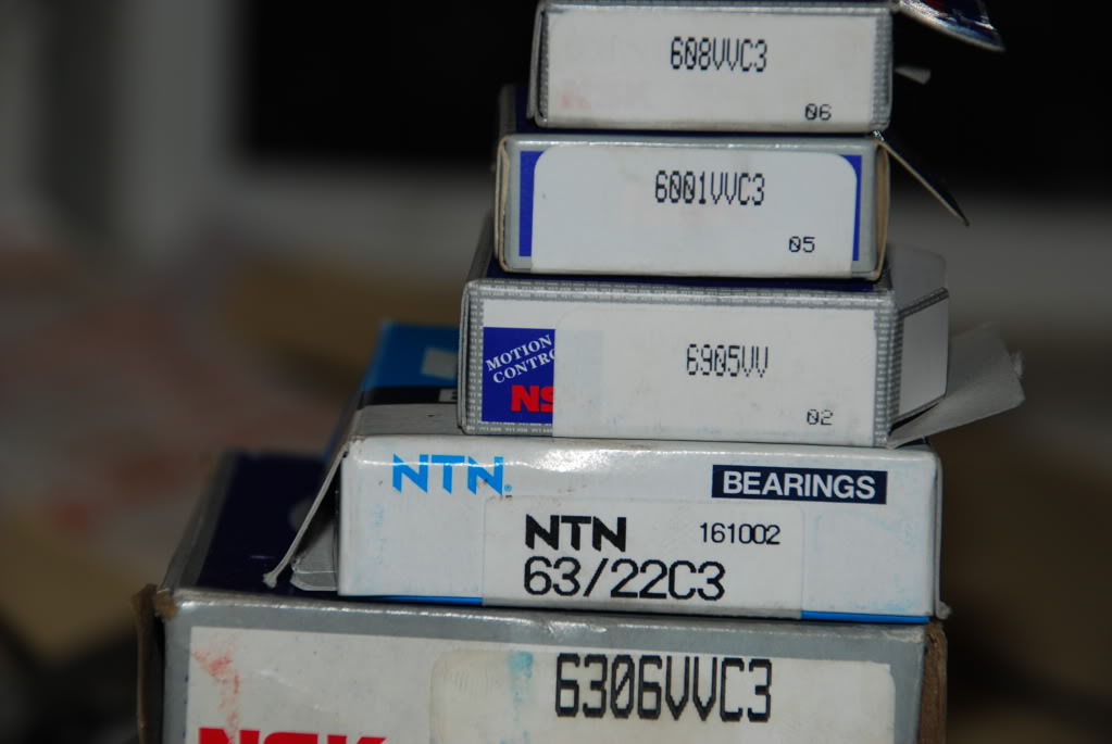

PAY CLOSE ATTENTION to what your bearing house trys to hand you.. I have to specifically ask for "the good stuff" or they will hand you a "made in korea, china, etc" garbage bearing.. Fine for most customers they get (electric motors).. but not me. USA made, Austria, etc for me only.... Ask the price differance between (rubber) sealed and non sealed bearings... somtimes the price differance is worth the added labor of removing seals and grease...
All numbers will swap between NTN, NSK, SKF..... ETC... timken runs differant numbers.. and all manufactures run differant seal coding so.. yea...
I will post the BEARING NUMBER only... NOT THE SEAL CODE .. as this is not neccisary.. (the VV part etc) But when you go to get your bearings.. you need all NON SEALED bearings, (or rubber sealed if you dont mind popping off the seals and cleaning out grease)..
You can get them in what ever "C" rating you want.. the C rating is the tolerance on the bearing... (for example the kips etc stock are C2).. I changed to C3 (looser, so it spins better)
After the part number etc, I will list a X# the # is how many you need for this section of the motor...
An example of the Bearing part number (so you can understand how to put all this together is)....
lets use the main bearings as an example...
My bearings are made by NSK.. the "Oficial part number) is 6306VVC3... to decode this... the 6306 is the bearing (size etc)... the VV is the seal code. (VV is doubble rubber seal) and the C3 is the tolerance spec.... (note on alot of C2 bearings. it wont bein the part number, as C2 is standard)
SO>.. going off this.. if you wanted a Main bearing that was NOT SEALED... and a C2 rating.. you would need a 6306 (yep thats it)... If you wanted a non sealed, C3 rated bearing.. ti would be a 6306C3 (somtimes listed as 6306/c3) all depends on bearing manufacture...
Hope this helps..
Main bearings.
(NSK) 6306 ( Not sure what OEM rating is, but I run C3 rated) X2
KIPS bearings
(NSK) 608 (Stock is a C2 rating, I run C3) X2
Water Pump
Clutch Pressure plate
(NSK) 6001 (Stock is a C2, I run C3) X1
Shift Drum bearing
(NSK) 6905 (stock is a C2 I run a C3) X1
Transmission LEFT CASE
(NSK) 6305 (I run a C3, OEM is C2) (replaces OEM part number 92045-1011) X1
(OEM) This is the bearing My bearing house cant get.. so OEM it is 92045-0013 X1
Transmission RIGHT CASE
(NTN) 63/22 (I run a C3, OEM is C2) (Replaces OEM part number 92045-1134) X1
(special note on this bearing... ALOT of the ones out there now have a Plastic cage... Request a metal one, and CHECK IT before you leave
I Just dont trust plastic cages in transmissions....)

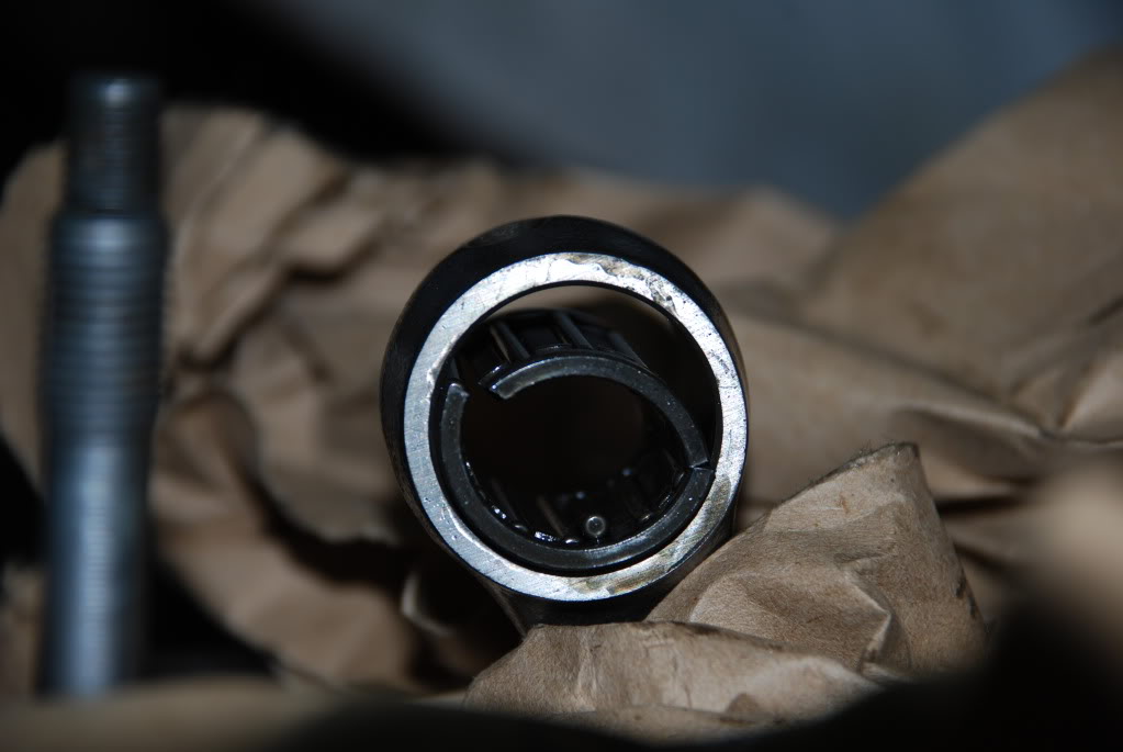

I reread this post and all that I gleaned was that it may have had a defective piston pin bearing. Just out of curiosity, did you use the Wiseco bearing, or a Kawi OEM?
Did you check out the small end rod journal for damage? Finally, did you make sure that the journal axis was parallel with the crank/base gasket surface. A couple of 1-2-3 blocks and feeler gauges could confirm this.
I know that you have had every Tom, Dick and Harry talking to you about this. I am not trying to criticize, only trying to help so that "the third time is the charm".
Ben
Motorrad:
Doesnt answer his phone anymore... I have tried to find out what the story on the small end bearing was... But alas I cant... Talking to others on here, they tell me that he had mentioned to them that "inspecting" the bearing and if it looks good then running used bearings is fine... So I suspect it was a USED bearing... that let go...
The rod looks good.. Surprisingly.. the journals look perfect..... but it shoved so much stuff into the head etc. I dont trust it anymore.. so a new OEM one is going in..
Unfortunately I tore it all down before I checked crank center, etc... But you can be darn sure it will be right this time around..
