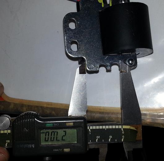

I started with the coil.
I wanted to install it where the old coil went.
I looked at doing a bracket to mount it to and a few other ways.
Then I decided the easiest way to mount it was to slot the coil plate as shown..
[attachment=3]KX500 2001 MZB INSTALLATION 2-2.JPG[/attachment]
I did this on both sides.
[attachment=2]KX500 2001 MZB INSTALLATION 1-9.JPG[/attachment]
[attachment=1]KX500 2001 MZB INSTALLATION 2-1.JPG[/attachment]
I made the first slot and did a test fit.
With the first slot the coil just barely touched the gas tank.
I didn't like it so I made a new slot and tested it.
Beautiful.
If you use the 20mm and 27mm measurements to cut the slots it will mount just where you need it.
Mounted and looking good.
[attachment=0]KX500 2001 MZB INSTALLATION 3-3.JPG[/attachment]
