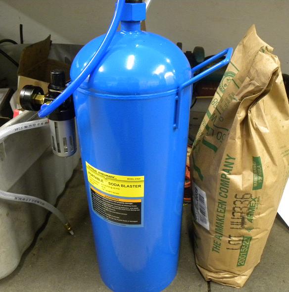

I need to see what all the hoopla is regarding sold blasting.
So I picked up this cheapie unit at Harbor freight with a extra set of tips and medium soda for about 175.00.
As soon as the humidity goes down a bit I will put in 40 lbs of soda and give it a whirl.
SODA BLASTER.JPG (50.31 KiB) Viewed 13172 times

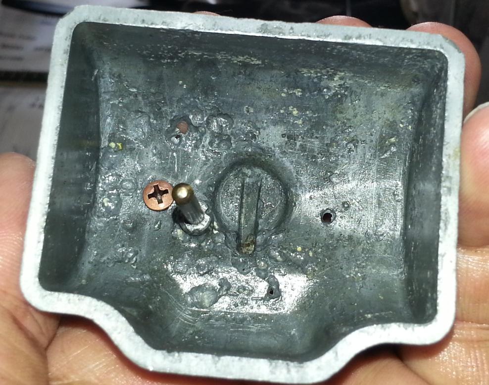

Here's a before pic of a carburetor bowl that had been cleaned up using a brush and scraping.
SODA BLASTER before 1.JPG (91.99 KiB) Viewed 12644 times

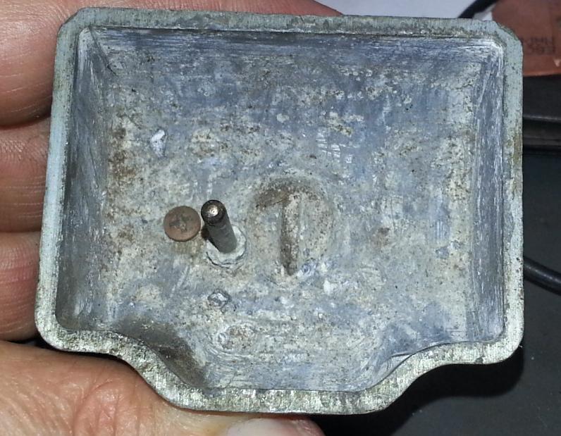

Here is the same bowl after soda blasting and rinse.
SODA BLASTER after 1.JPG (126.9 KiB) Viewed 12644 times
Some of the damage could not even be seen until we blasted it.
For cleaning carbs, this thing works awesome...
