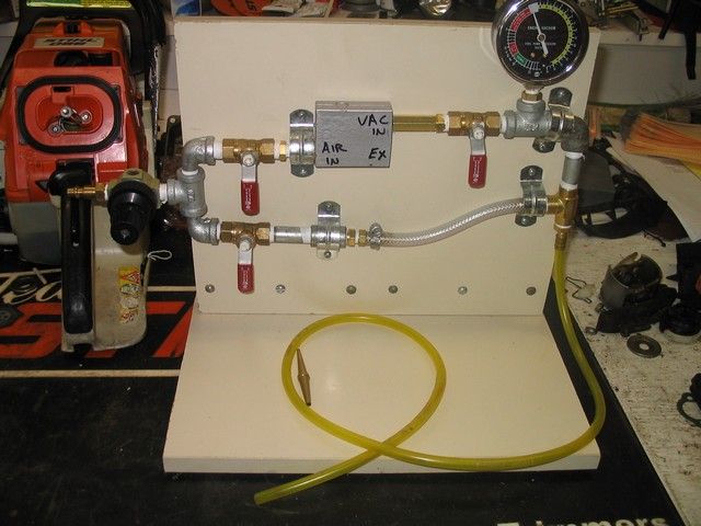

Ok well here it is.
Not my setul as its from someone who vac and pressure tested chainsaws a lot.
Only thing is I forgot to grab a good explanation of it all, from memory the guy used the diaphragm pressure gauge off a gas welding setup to lower the pressure from his garage air to a point where it wouldn't blow crankseals, then shut it off when it was at the right pressure to do the pressure test.
Can't for the life of me remember what he used for vacuum.
Think he used to take the chainsaws apart leaving the cylinder and head on, pressurised it via the impulse line and put it into a tank to wash it while pressurised. That kept the water out while he pressure washed it at the same time. Then if it held he vacuum tested it as well. If it didn't he had to replace seals anyway.
Re: Motion Pro Leak Down Tester 08-0071
Now that is a work of art :D
Thanks for posting it.
