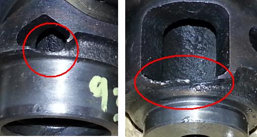

I have a potential customer that has asked a very good question.
It seems that his shift drum as well as one that I am selling appear to have the same problem.
Here is a pic showing the potential problem.
1989-1995 SUZUKI RM250 SERVICE MANUAL SHIFT DRUM SPECS 5.JPG (28.09 KiB) Viewed 12197 times
I realize that these look really bad.
However, take a close look...
Are those machined edges?
No, they are cast. So those edges that appear to be damaged are nothing more then casting flaws.
They do not have anything to do with any of the machined surfaces that capture the bearings or hold the shift forks in place.
How can I be so confident?
Well, here's a pic of 5 different shift drums, all from RMX250's from 1990-1998 and they all have the exact same appearance.

Re: My RMX250 Shift Drum looks damaged. How can I tell if it
Confused?
Take a look at this pic.
It shows the edges and surfaces to be concerned about.
1989-1995 SUZUKI RM250 SERVICE MANUAL SHIFT DRUM SPECS 6.JPG (68.17 KiB) Viewed 12197 times
This pic shows the area that I would take my Dremel tool too and clean it up to remove casting flash or rough surfaces.
Not because it is mandatory, but because I'm fussy and I don't want some little chunk falling into my trans area and dinking up a gear :o
