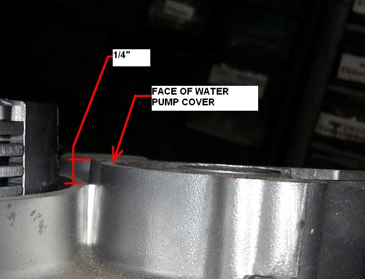

Here is some updates...
People ask me how thick should they cut their case to.
That will depend on what you are trying to do.
For a standard clutch assembly simply cut the case down until it is 1/4" lower then the water pump face as shown below.
www.oem-cycle.com kx500 two piece clutch cover 101.JPG (44.54 KiB) Viewed 24680 times
Now, if you want a Rekluse clutch there is two different ways of doing it.
I highly recommend that you get the parts together first then measure to be sure that the measurements will meet your needs.
1. If you use a KX450F clutch cover then you need to machine the clutch cover to the same thickness as the water pump cover face, NOT 1/4" lower.
2. If you use use a KXF450 (Quad) clutch cover, then you can machine the clutch cover 1/4" lower then the face of the water pump cover as shown in the pic above.
Again, measure first... then cut :o

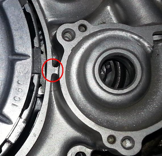

Here's another tip.
While you have the clutch cover in the milling machine, remove the web as shown in the pic below.
www.oem-cycle.com kx500 two piece clutch cover 102.JPG (67.21 KiB) Viewed 24680 times
