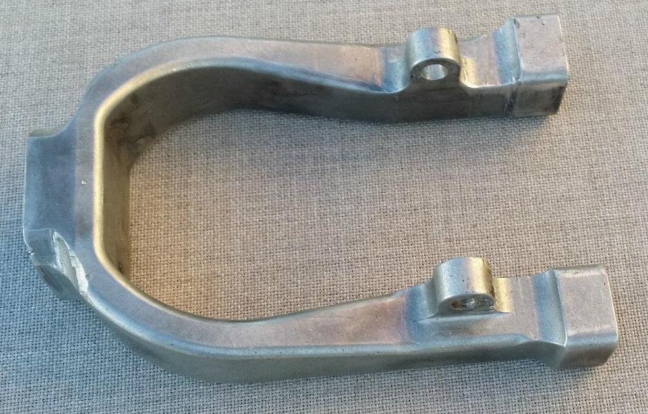

will work on 06-2012 kx250f kx450f to mount up a 1990 - 2001 kx500 engines. just for the Y-piece. made of 6061-T6 aluminum, go around the exhaust and mount the front mounting bolt so you will not have to fabricate front engine mounts. The ends are made to fit over the tubing of the frame to allow the strongest possible welds. With this Y-piece, you do not have to replace the square tubes that run under the engine. makes a very clean looking conversion. this Item has been made for a kx500
KX500 ALUMINUM FRAME CONVERSION BRACKET.JPG (128.25 KiB) Viewed 23064 times

I've picked up a 07 KX450F and plan to carry out a KX500AF conversion. Can you give me a price including shipping to Melbourne, Australia, for the y piece as the eBay item is inactive.
Thanks.
Re: kx500 kx500af engine Y aluminum frame conversion mount k
Unfortunately, it wasn't my item.
I have sent the seller a email so we'll have to wait and see if they respond.
I'd love for you to post pics of your build.
I am using a 07 250f for my conversion build.
I wish someone had those Y pieces available before I started mine :(
