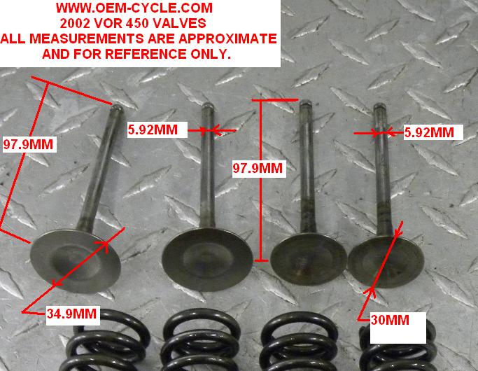

VOR MEASUREMENTS AND PICS
2002 VOR 450 MX VALVE MEASUREMENTS

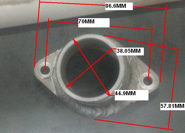

VOR Vertemati Offroad Racing 2002 450 MX INTAKE FLANGE measurements and pics
All dimensions are in millimeters and are for reference only ;)
