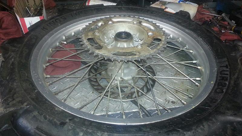

After I mounted the tire I realized that the sprocket and the wheel bearings really should be replaced..

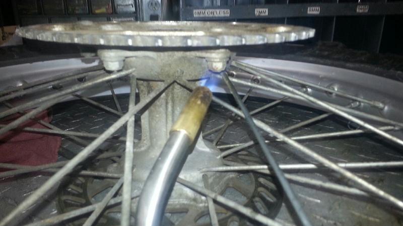

Of course the sprocket bolts were froze up and had retaining compound (thread locker) on them so out cake the heat...

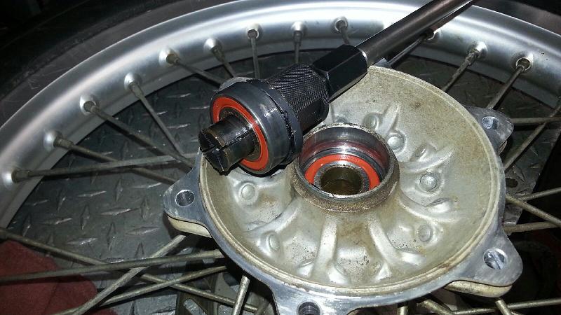

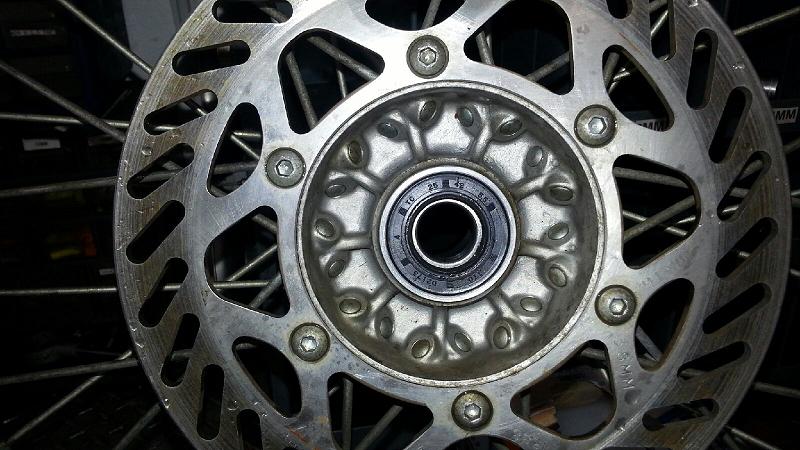

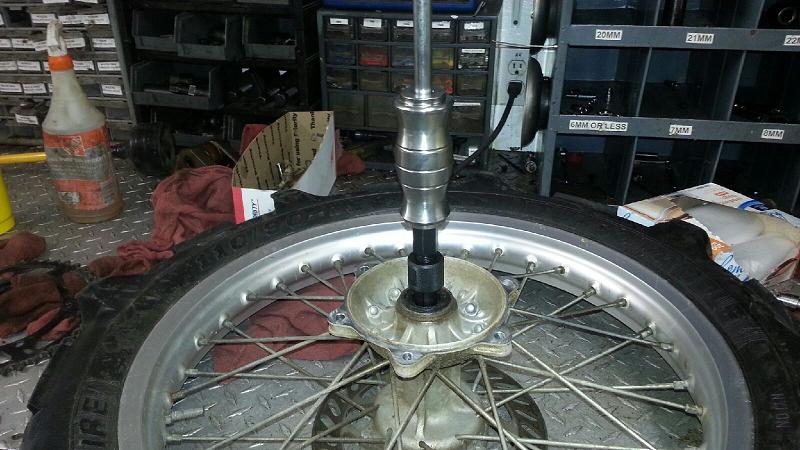

Once I removed the sprocket I got out my slide hammer and popped the bearings and seals off.
03 KX500 REAR WHEEL BEARING REPLACEMENT 3.jpg (71.86 KiB) Viewed 9546 times
These bearings were definitely ready to be replaced.

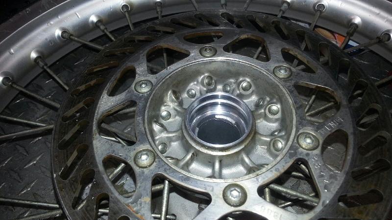

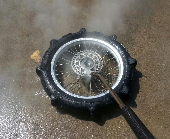

After the bearings were removed I went over the entire wheel with my hot water pressure washer.
I should have done that first but better late then never.
03 KX500 REAR WHEEL BEARING REPLACEMENT 5.jpg (49.46 KiB) Viewed 9546 times
After clean up I sprayed carb cleaner down the center to push out any water.
Nice and clean now..

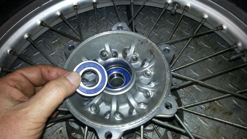

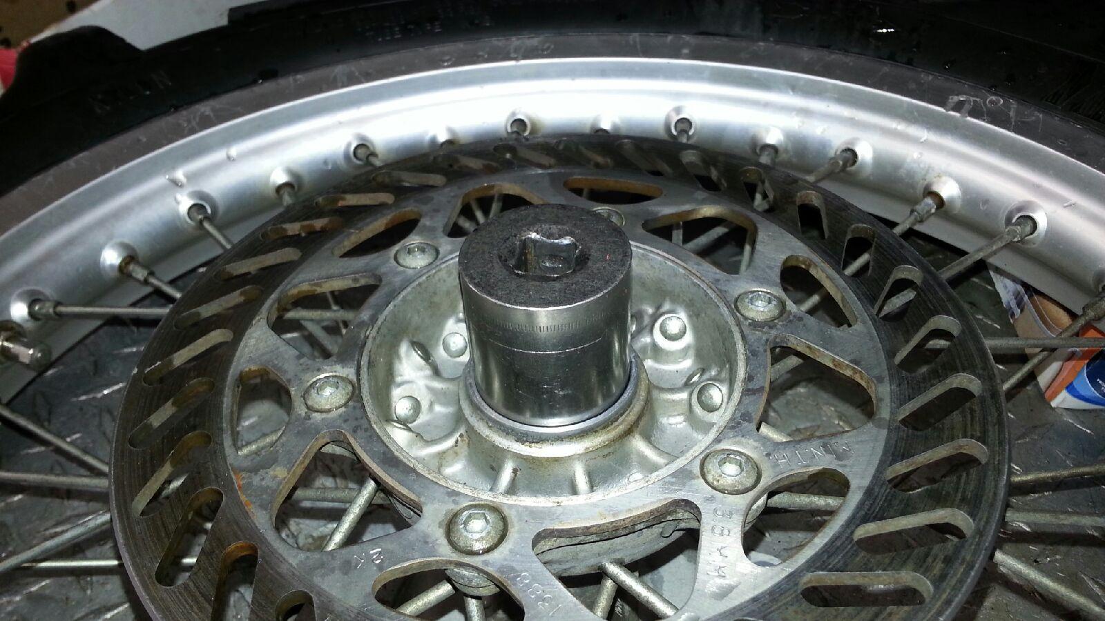

I pushed the new bearings in using a 30mm socket as I don't own a bearing driver..
03 KX500 REAR WHEEL BEARING REPLACEMENT 7.jpg (210.22 KiB) Viewed 9546 times
Once the bearing was in I pushed in the seal using my fingers.
Finally I put a small dab of grease on the seal lip.

As you can see the drive side uses two bearings.
No big deal, just drive them in side by side using the socket and doping them one at a time, push on the new seal and grease the lip.

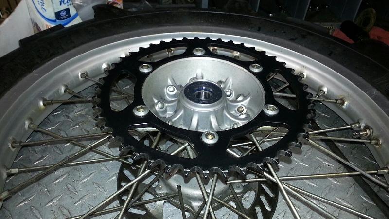

Installed the new sprocket using retaining compound on the nuts and done...
