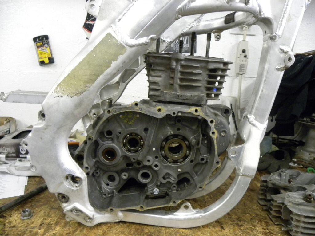

First, here is a picture of the XR400R engine cases with the cylinder, sitting in the CRF250R frame.
Right off the bat a few things became apparent.
This would not be a easy conversion and I do not feel as though it would be practical.
Here are a few reason why.

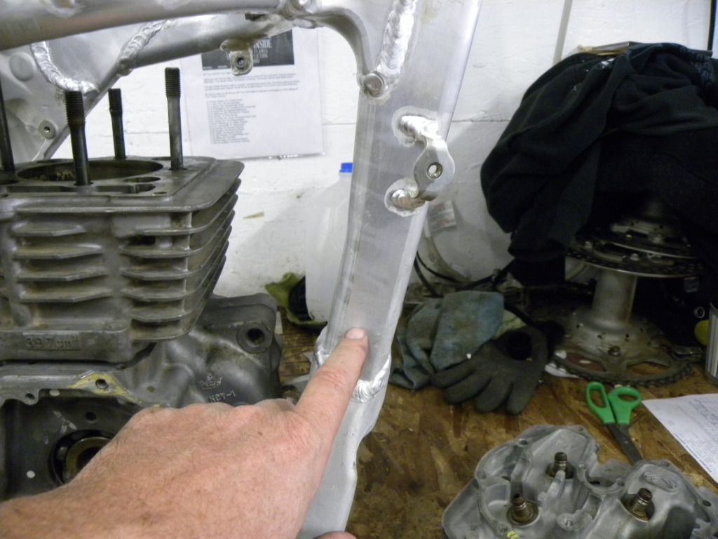

You would need to cut the front part of the frame and extend it to allow for the longer engine cases.
I do not even have the engine sitting as far forward as it would need to go in order to get the swing arm pivot pin to slip in.
My guess is that the engine would sit about another 1.5" forward:

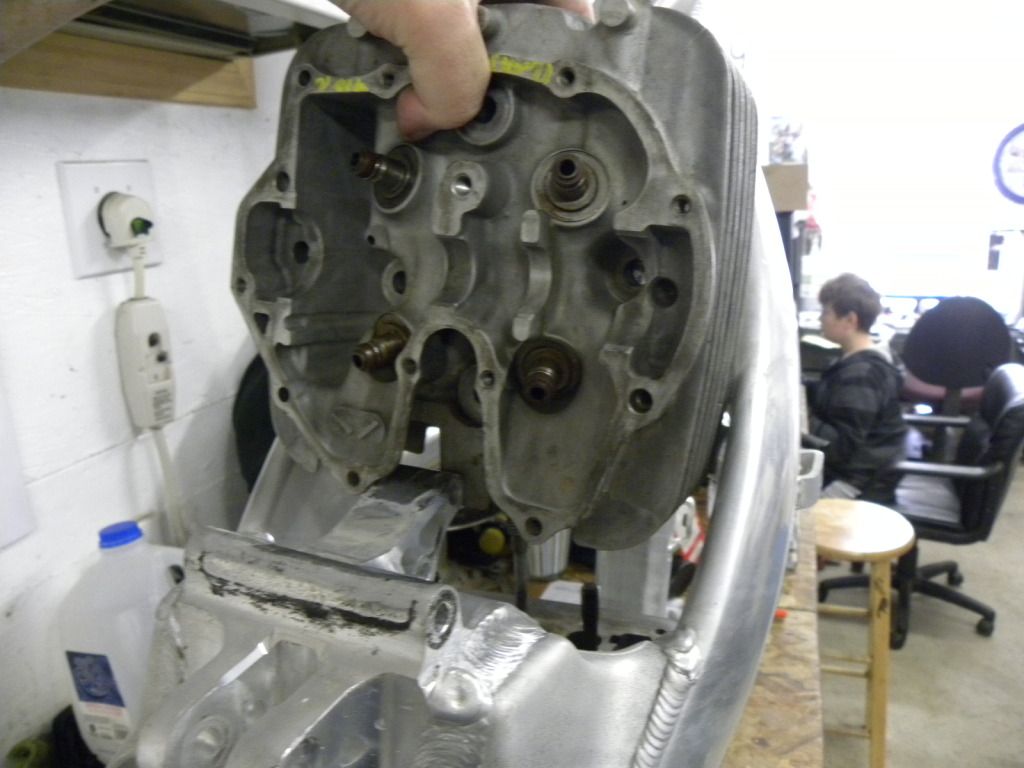

The next problem is the head is simply to wide to sit in between the main frame rails:
The next question I would have is the location of the kick start.
I'm not 100% certain but I believe that the kick lever would be sticking on the outside of the frame.
This would be dangerous, look bad, and eventually wear a hole in your frame.
In my opinion, this idea is a bust.
