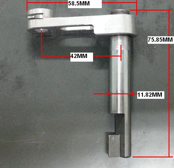

Re: How to make a KX500 billet extended clutch arm.
Here is some basic measurements
KX500 EXTENDED CLUTCH ARM.JPG (42.6 KiB) Viewed 14784 times
