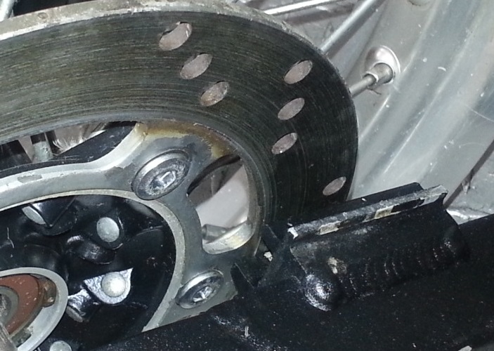

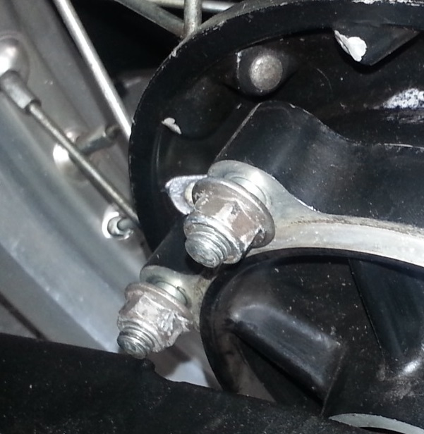

As you can see in the pics below we have some issues...
All the pictures are taken with the brake rotor touching the brake mount on the right side of the swing arm.
On the left side, the sprocket would be to far to the left for correct alignment.
Also the rotor bolts are rubbing.
KX500 RUNNING A KLR650 REAR HUB 1.jpg (140.41 KiB) Viewed 8330 times
KX500 RUNNING A KLR650 REAR HUB 3.jpg (105.82 KiB) Viewed 8330 times

On the right side the brake rotor rubs on the rear brake mount on the swing arm.
KX500 RUNNING A KLR650 REAR HUB 2.jpg (130.48 KiB) Viewed 8330 times
KX500 RUNNING A KLR650 REAR HUB 4.jpg (117.94 KiB) Viewed 8330 times

Ok, so could this still work?
I think so.
You would have to remove the mounts on the swing arm for the rear brake.
Then you would have to relocate the rear brake caliper mount by fabing up something and having it welded to the swing arm.
If I was going to go through that much effort I'd also look into a dual piston caliper.
What I was hoping for was a little less expensive way to get a cushion drive on the KX500.
So it's back to the drawing board for now :shock:
