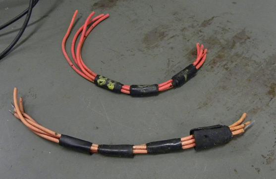

Re: So what's the story with electrical tape?
After 8 months what have I found?
9-18-13 review.JPG (33.76 KiB) Viewed 12325 times
Well, I have to be honest.
Regardless of price they are all performing very well.
No loose edges or any sign of unraveling.
Remember, these have been outside in direct sun light as well as the normal Oregon elements.
In fact, if you look close, you can see that the red wire insulation is fading but the tape is holding tough.
Conclusions?
I'm in this for the long haul so no conclusions yet except for one thing.
The Chinese tape is doing by far better then I thought possible....
That being said, I will continue to buy American tape and support American jobs until such time as the Chinese tape proves itself superior.
So, this is not finished.
I will put the tape back outside and continue to let it bake..
Can't believe it but it's been a whole year since I started this review!
Here's the latest pics of the wires and tape.
1 year pic.JPG (22.54 KiB) Viewed 12256 times
As you can see, all the brands are holding up very well.
In fact, it seems that the single most important thing about which tape you decide on is how you apply it.
If the surface is clean and you don't stretch the tape to break it off but rather cut it, the raw edges do not unravel.
So, which will I use?
Most likely I will use American tape.
American tape hold up well and applies easier in most cases.
True the Chinese tape is very strong and is holding up great but, if each of us were to increase our spending on US products by 64 dollars a year we would generate an average of 200,000 new jobs.
Think it over and you decide..
