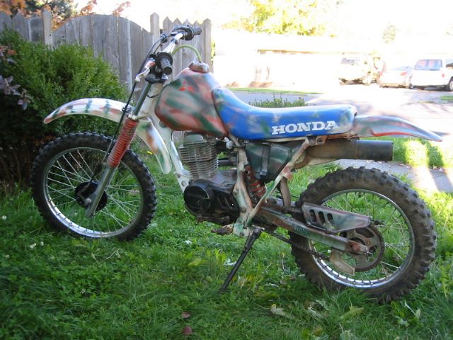

Well here is my sad little bike I traded a saddle for. I call it sad because some "artist" decided that since his dad lived in the country he should paint it camo so no one would see it and steal it, true story!
It is in good shape aside from the paint. The only issue I am having now is getting it to start easy and idle for me. I joked I found a new workout with it called kickstarting.
I may or may not keep it, really wanted a street bike, partly because I have no one to trail ride with, but it is an awful sweet little fast sucker. If making it a dual sport was not such a pain and cost a mint I would just do that.

Oh, and paint stripper will get rid of most of the camo if you don't like it.
Or, you can update the camo by getting some green, brown, and grey paint, some tape for masking, and some local leafs...
It's amazing what can be done...
But mask off areas not being painted.
Nothing is more horrifying then a rattle canned bike with over spray all over the place.

Well I got rid of the old gas and paid the big bucks for the clean stuff, added some fuel system cleaner and changed out the fuel filter. The guy did say it had sat for a year, so I bet that is part of the problem. I still need to pull the plug and see how it looks as well. I was thinking of just rebuilding the carb, wouldn't hurt, that is for sure, never done that before, but I rebuild a VW one, not too different I would think. And no I need a repair book for it. Though not a dirt bike I scored a honda elite 150 scooter too for 50 bucks lol, so that is another project I have in the works as well.
