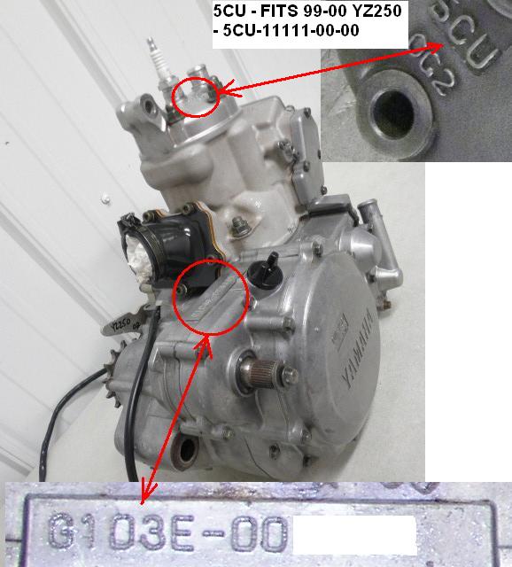

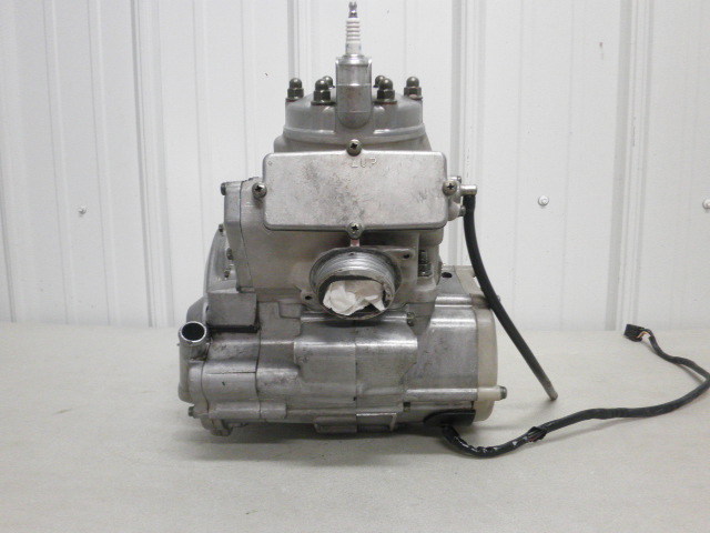

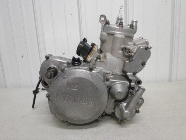

Right engine case top rear: G103E-00XXXX

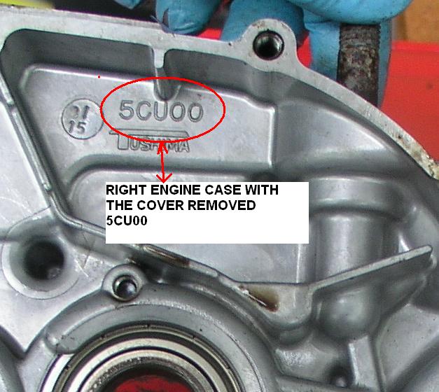

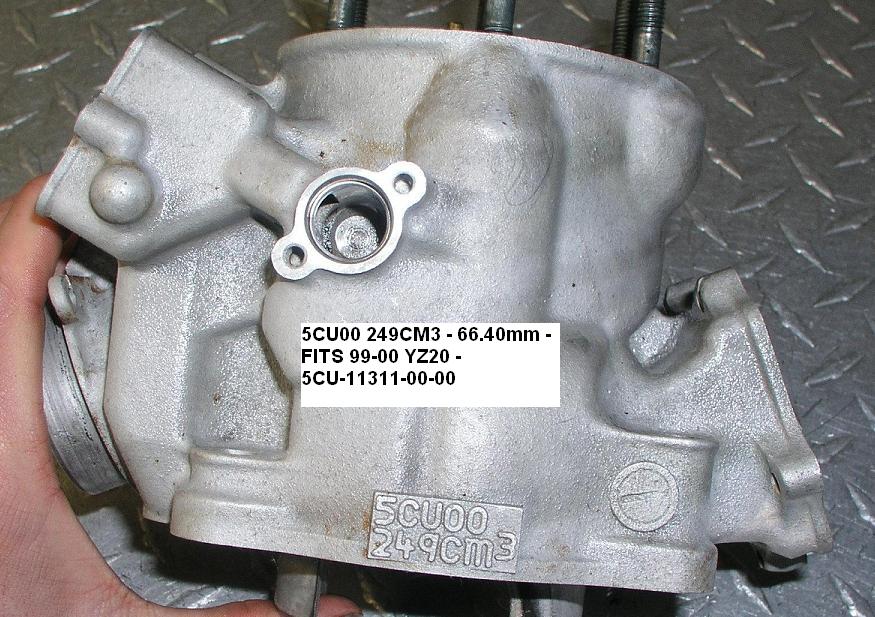

Right engine case inside: 5CU-00
Head: 5CU
Cylinder: 5CU

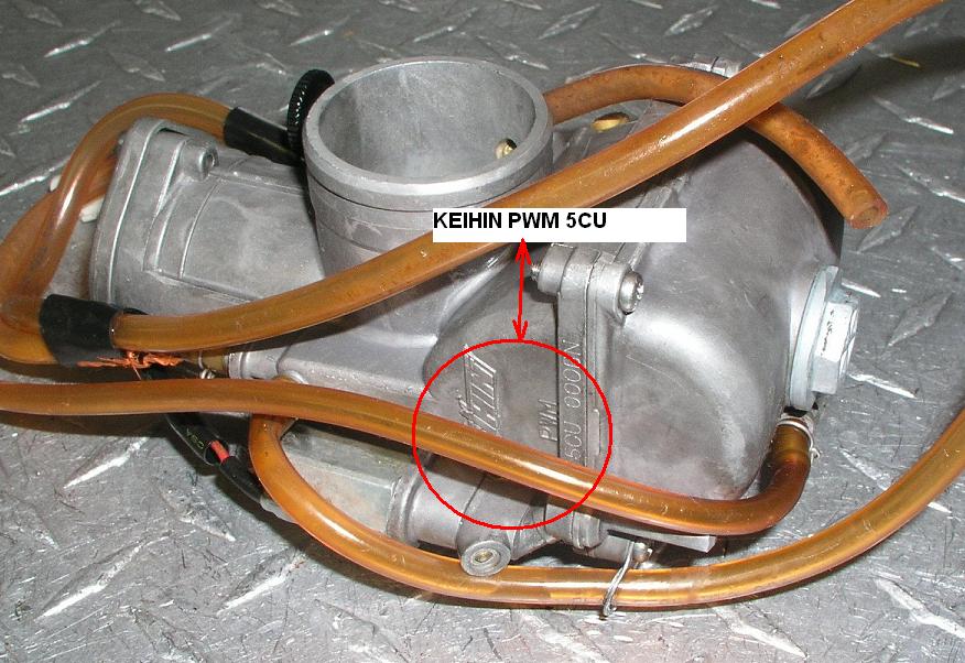

Carburetor: KEIHIN PWM 5CU
