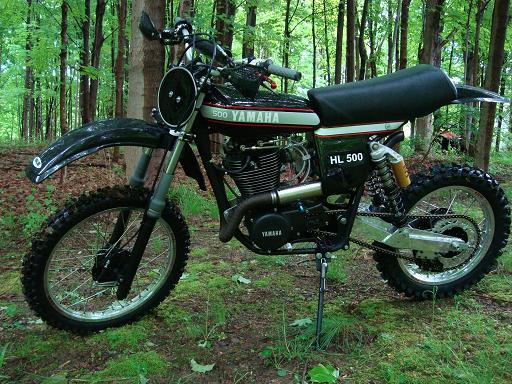

This particular bike is for sale at 25K.
Needless to say it's serious buyers only :D
You bet, check it out here as this bike is over the top:
http://huskyrestoration.com/?page_id=2011
The frame is a Yamaha HL500 replica with frame and swing arm modifications in order to install a wider rear wheel. The frame was custom made for me by Frame Crafters.
Frame Crafters aluminum swing arm. Minor swingarm modifications by Rob
Aluminum triple tree with adjustable offset, custom made by Frame Crafters.
Front forks – Shortened 1988 YZ250 43mm with Sonic Springs.
Front and rear hubs, rear axles, sprocket, brake disc mount and rear caliper mount by Cheney Engineering, Modifications by Rob
Nissin brake calipers
EBC brake disc
Magura front brake radial master cylinder with remote resevoir.
Magura hydraulic clutch system with decompression lever. Customized for TT500 by Rob
Buell rear brake master cylinder
Rims – DNA Specialty 3.5 x 17 and 5.0 x 17
Tires – Michelin Pilot Power 2CT
Custom Ohlins piggy back shocks
TT500 engine
Megacycle cam
Mikuni Round Slide Carb
K&N Air Filter
Dual rocker steel braided oil feed and steel braided oil lines through out.
Frame Crafters Steel exhaust, modified for Custom Silencer by Rob
MZB Electonic ignition
Custom headlight assembly with 10W LED by Rob
LED turn signals, tail light and brake light.
Vapor Tech Speedometer
Hand Guards with intregal turn signals.
Front modulate running lights.
Fuel Tank - 1976 YZ125
Billet Aluminum fuel cap with check valve vent.
Custom 1976 YZ125 seat upholstered by Pirate Upholstery, Kingston, NY Pirate
UFO Fenders -
Renthal Handle Bars
Sliders by Rob
Riderscan innovative blind spot mirror. Riderscan
Rear view camera with LCD display. ( No more rear view mirrors. )
Custom Kick start indicator.

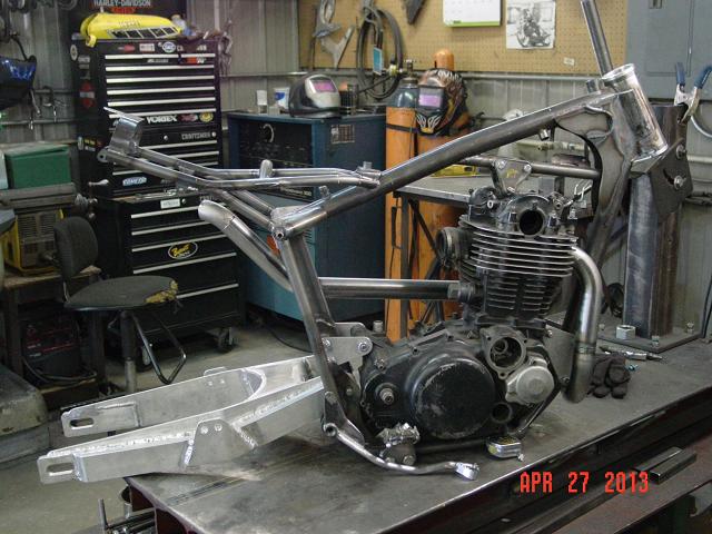

Another cool build by Rob:
HL500 MX version almost done.
