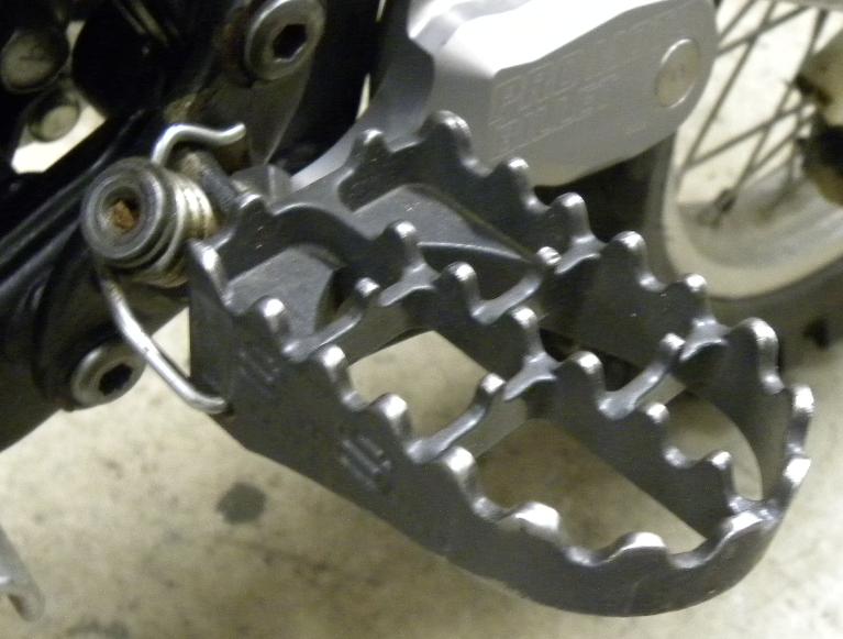

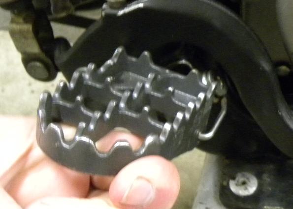

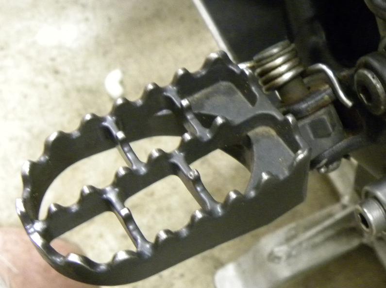

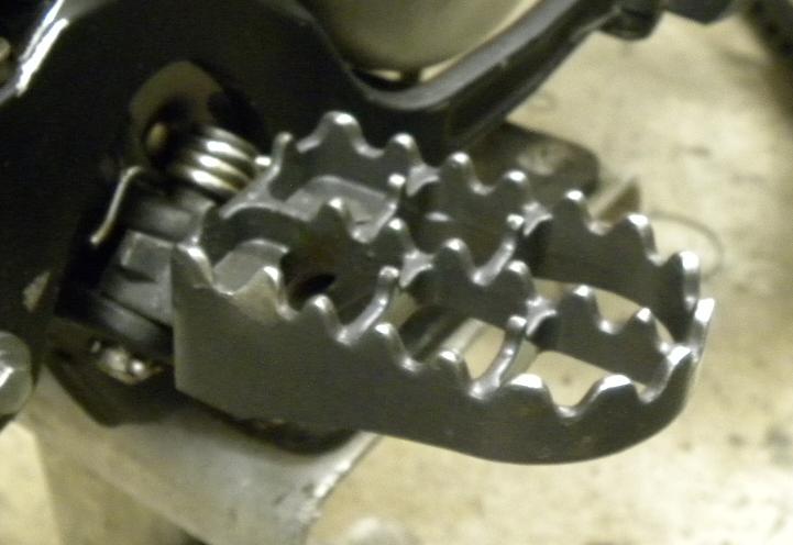

I was playing around with my 01 KX500SM and decided the stock pegs weren't going to cut it for me.
So I started digging through my junk piles and came up with a set of aftermarket pegs off a 03 YZ450F.
Here's the results..

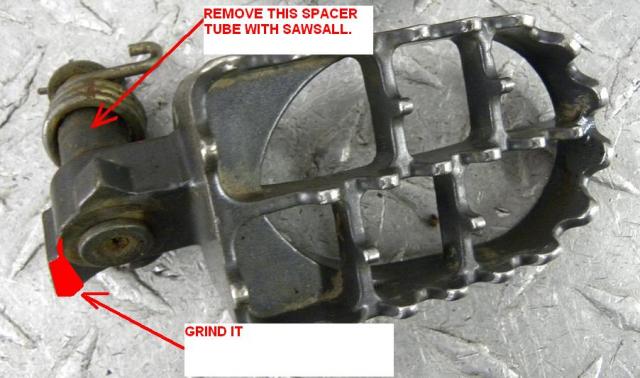

Here is the grinding and cutting I did.
- KX500 FOOT PEGS5.JPG (42.03 KiB) Viewed 6657 times
Total fab time?
About 15 minutes...
Tools required, Sawsall, Bench grinder, vice, and vice grips to straighten out the front of the springs...
