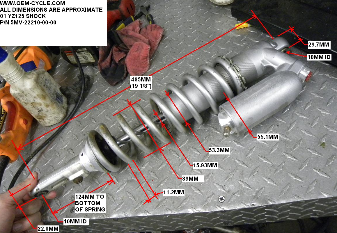

YZ125 YAMAHA 2001 REAR SHOCK - 5MV-22210-00-00 - MEASUREMENT
YZ125 YAMAHA 2001 REAR SHOCK - 5MV-22210-00-00 - MEASUREMENTS AND PICS
ALL DIMENSIONS ARE APPROXIMATE
