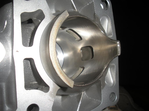

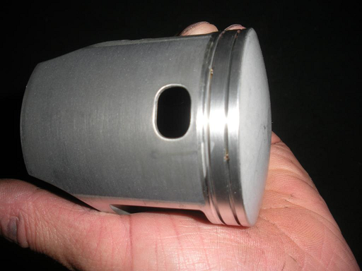

On the piston I windowed it & dropped the boysen port before the replate. On a kx500 it equals 2.5 hp in the mid range. The reason I think it works like that is if you think of swinging a bucket to keep the water in the bottom the highest point of pressure is in the very bottom so a window relieves this hgih pressure point.
rmx250 1.png (302.43 KiB) Viewed 13603 times
The piston is also skirt coated with an antifriction coating & ceramic on top
Here's the boysen port drop
rmx250 2.png (226.81 KiB) Viewed 13603 times

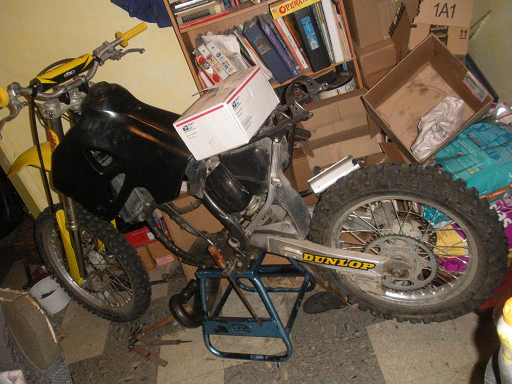

Heres where the bike is at
rmx250 3.png (387.56 KiB) Viewed 13603 times
Yes it's in my kitchen & yes its a work in progress. You can see the tank on it at this point but the shrouds still need to be attached.

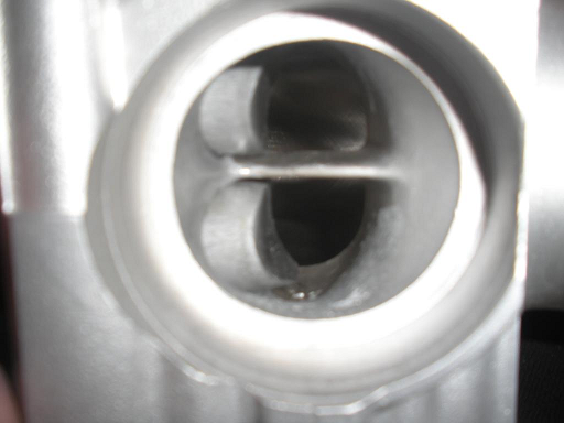

The 91 jug needed some port work to smooth out the powervalve area & the powervalves had to be relieved as I went 2mm overbore
rmx250 4.png (216.16 KiB) Viewed 13603 times

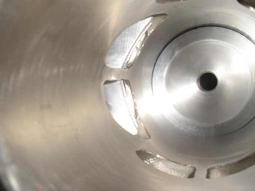

You can see the rechambered head above as well & below here you can see how the everthing is flush when the valves are open, they were 1/4 inch deep before the work.
rmx250 5.png (178.14 KiB) Viewed 13603 times

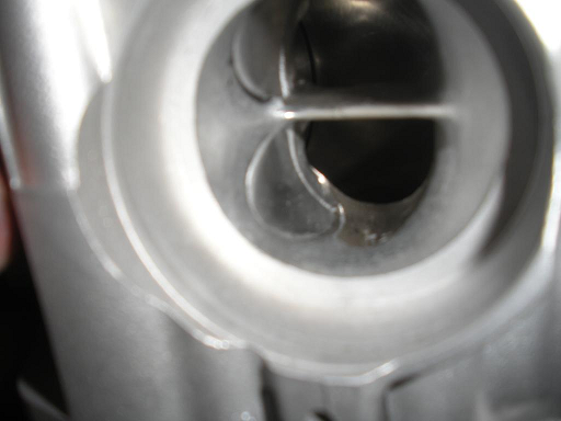

The RMX is know for having excellent fuel economy due to such a small exhaust window, you can kind of see it here when the powervalves arent open
rmx250 6.png (186.87 KiB) Viewed 13603 times
