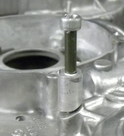

Had to fix the tower for the counter sprocket guard :(
So I got a piece of 1/2" round stock, drilled and taped it, also left it long.
Chamfered the angled end.
Ran a bolt through it to hold it all together.
Also, I ran a bottom tap all the way to the bottom of the tower hole as there was very few threads left.
tower fix.JPG (20.72 KiB) Viewed 18613 times

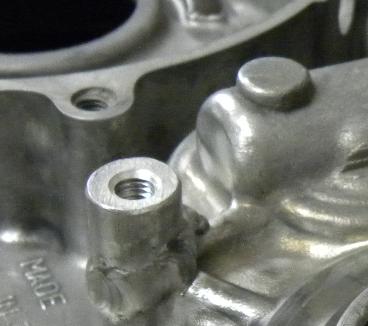

Then I took it next door and had my buddy weld it up for me.
tower fix -2.JPG (16.1 KiB) Viewed 18613 times
Once it was welded, I removed the bolt, ground the tower to the correct length, countersunk the end and cleaned up the edges.
I won't grind the weld down to clean it up because there is very little penetration and I don't want it to break off for no good reason.
