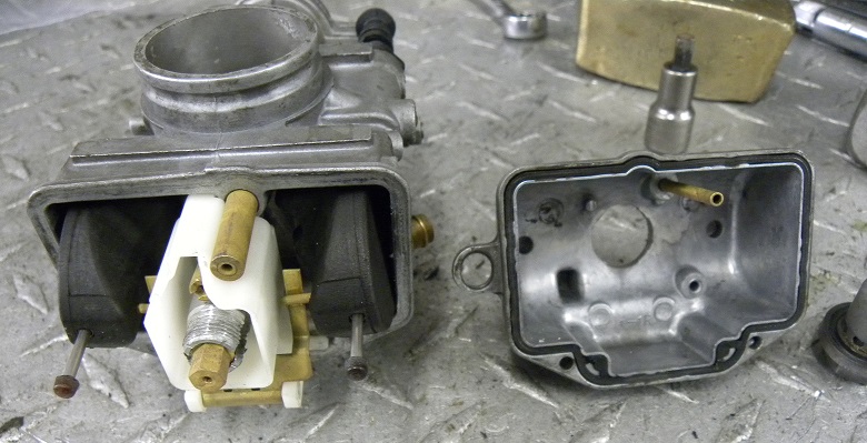

A few days later he sends me the carb back???
Ok, I take the carb over to my work bench, and notice that the small positioning screw is missing.
No biggie.
Next I get out a 17mm wrench and remove the main bowl bolt/Drain plu.
It comes right out and the bowl comes right off.
This is what I see.
- carb.jpg (130.24 KiB) Viewed 9985 times
So, he and his mechanic didn't know you had to remove the big bolt at the bottom of the bowl and he got charged for 2.5 hours of labor?
The carb is clean and after testing the float valve we found that it works perfectly.
Then after being totally focused on the bowl issue I discover that besides the missing bolt the slide assembly is missing.
