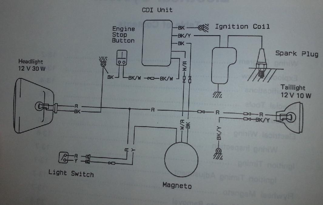

WIRING DIAGRAM FOR 89-94 KDX200 PICS
KDX200 KAWASAKI PICS, MEASUREMENTS, SPECS
WIRING DIAGRAM FOR 89-94 KDX200 - 21119-1257.JPG (56.86 KiB) Viewed 14084 times
CDI P/N 21119-1257
FITS 89-94 KDX200 -
- BLACK MALE BULLET,
BLACK EYE RING,
BLACK/WHITE FEMALE BULLET,
BLACK/YELLOW FLAT FEMALE,
WHITE/RED FEMALE BULLET
