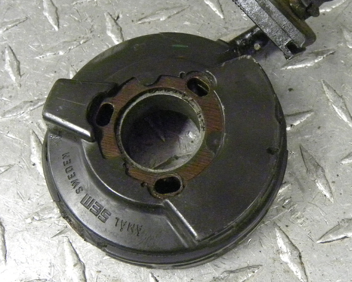

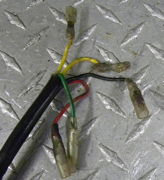

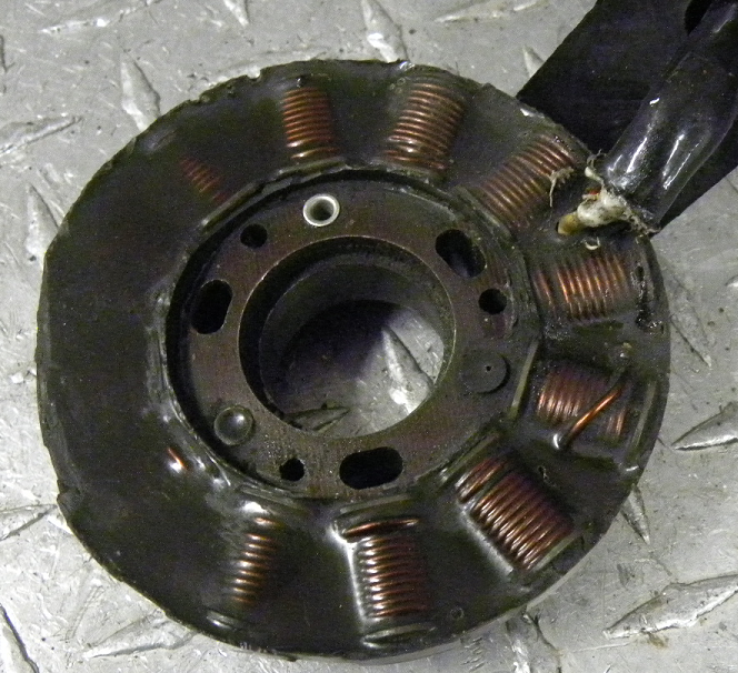

SEM Stator specs
Black to Red 1700 Ohms
Black to Green 165 Ohm +-20 Ohm
Green to Red 1700 Ohm
Yellow to Yellow 1.0 Ohm
KTM AMAL SEM STATOR SPECS
