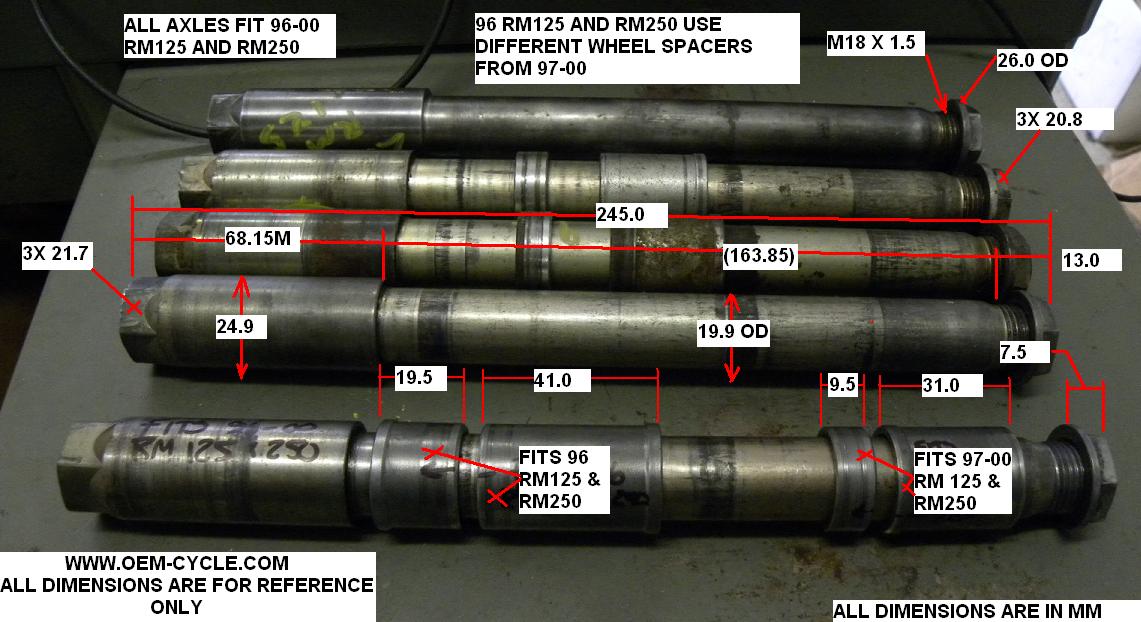

54711-36E00 RM125 RM250 FRONT AXLE AND SPACER MEASUREMENTS
All dimensions are for reference only.
96-00 RM125 and RM250 all use the same front axle.
However, the spacers for the 96 RM125 and RM250 are only for use with the 96 unless you are using a newer 97-00 front hub.
The 96 RM125 and RM250 use 19.5mm and a 41MM axle spacers.
The 97-00 RM125 and RM250 use 9.5mm and 31mm axle spacers.
