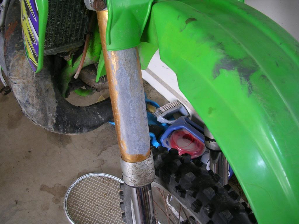

I finally thought it was a good time to share what I have been up to with my 250 since I joined. I bough a 1990 KX250 from my father in-laws neighbour which had been parked for about 8 years. It was sitting in a little garden shed getting full sun on it every day. The forks were absolutely cactus, the outer tube on the uppers was starting to oxidise and corrode, they were coming apart as if they were cast iron. Anyway here's how the bike looked when I brought it home.
oem-cycle.com 1990 kx250 supermoto build 101.jpg (225.23 KiB) Viewed 10872 times

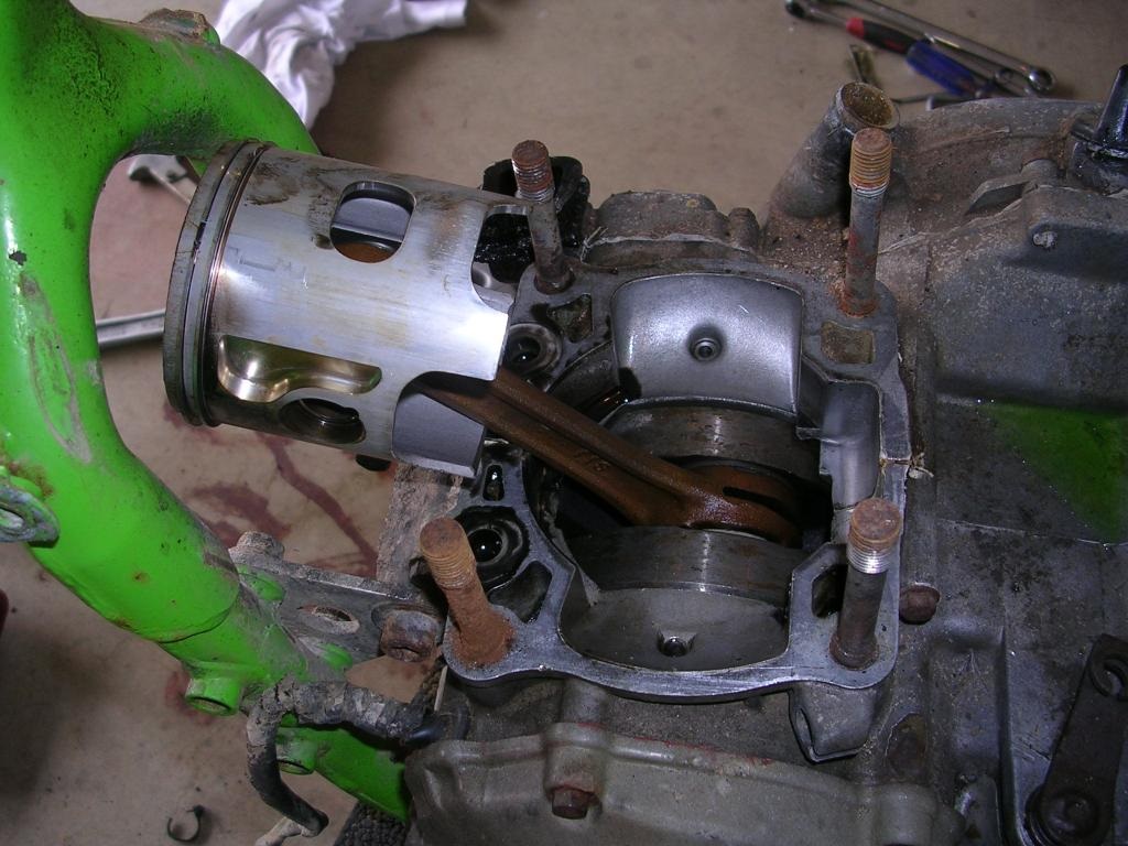

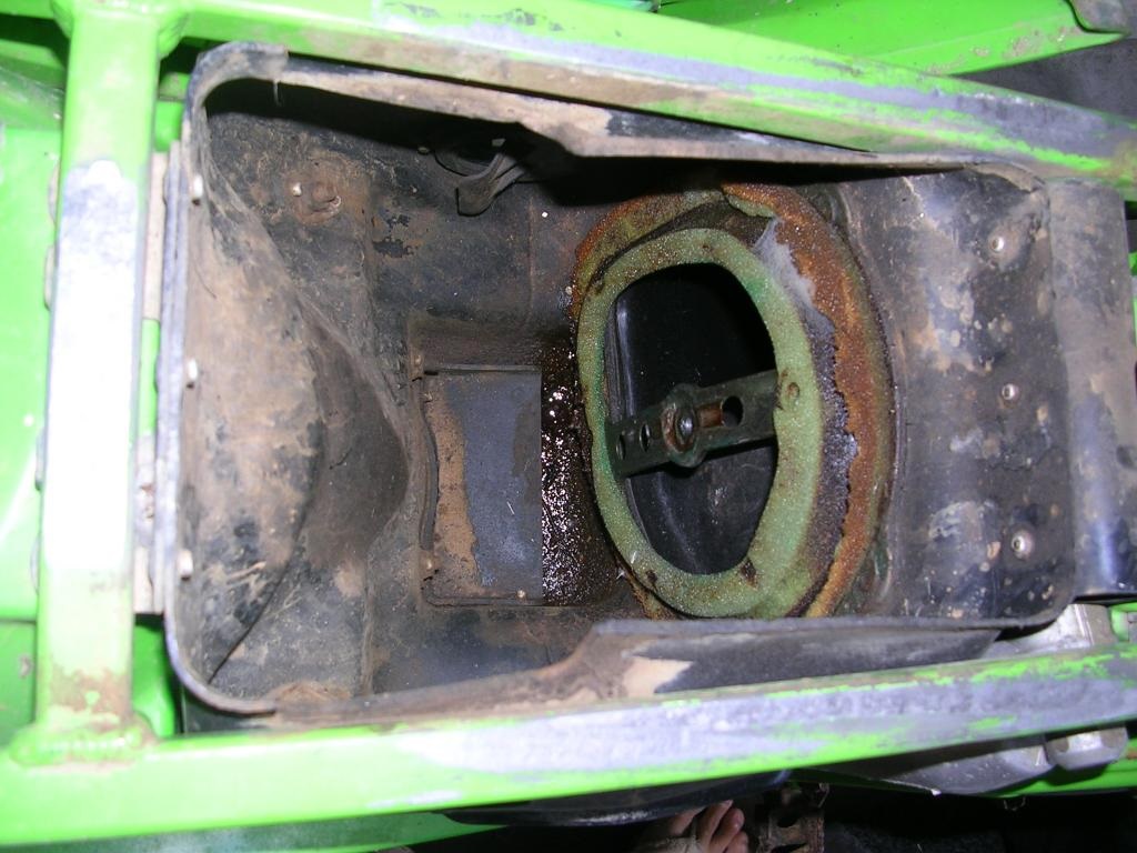

I tore the bike down as best I could, half the bolts were rusted or the threads stripped. The top end actually looked pretty good but there was no coolant or oil in the thing and the crank seals looked well past their use by date.
oem-cycle.com 1990 kx250 supermoto build 104.jpg (249.58 KiB) Viewed 10872 times
